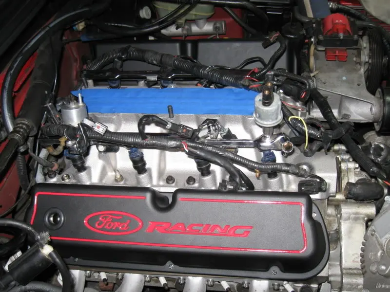

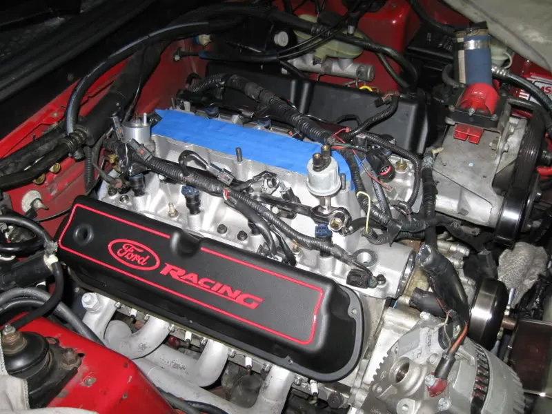

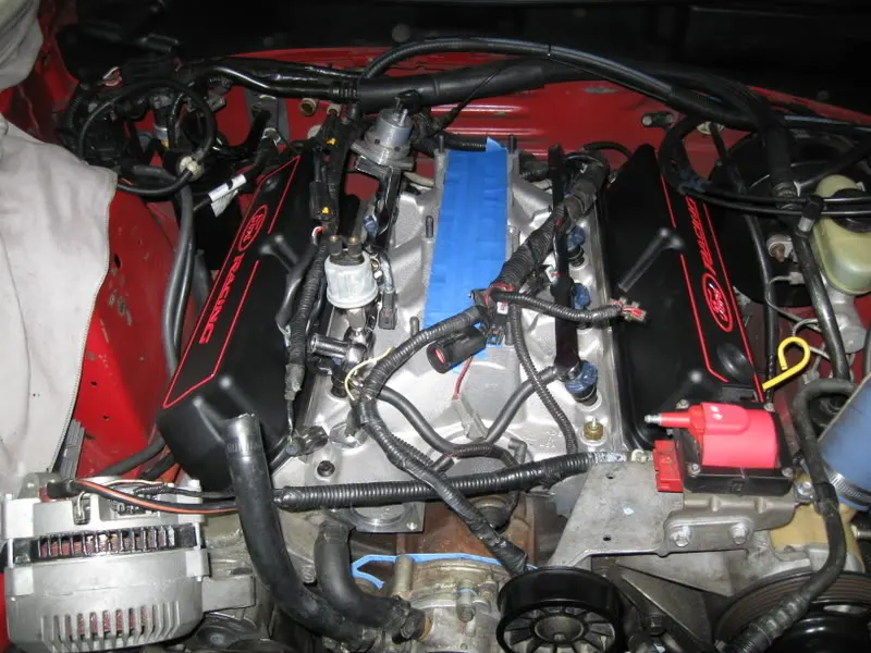

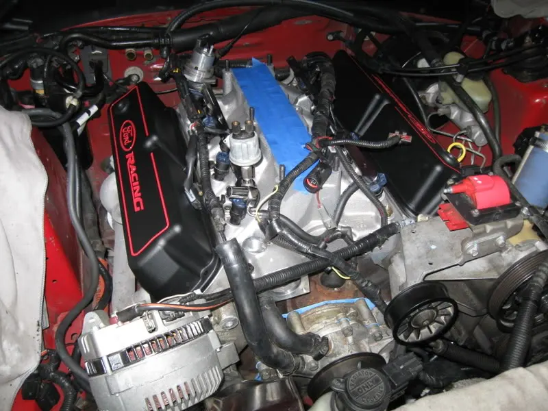

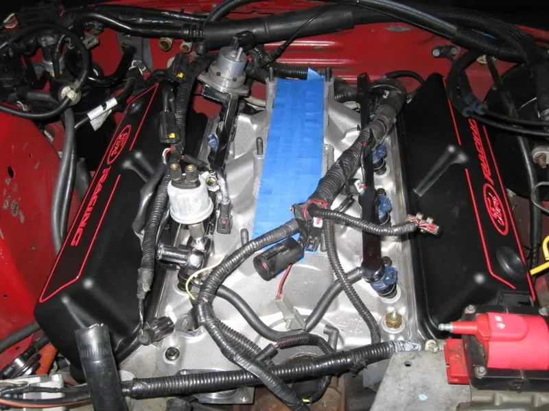

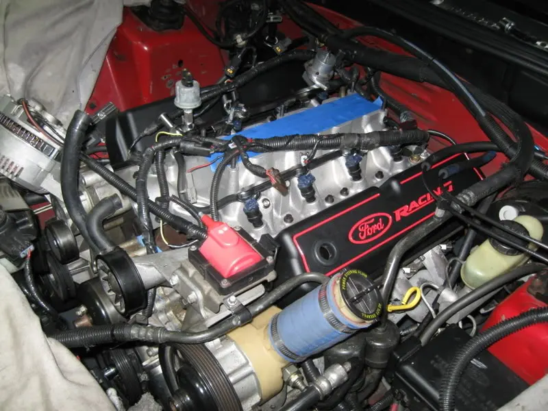

Stop by real quick today just to see how it was coming along and to post up a few progress pics. Its so close to being done.
