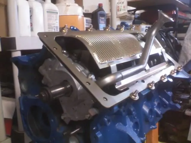

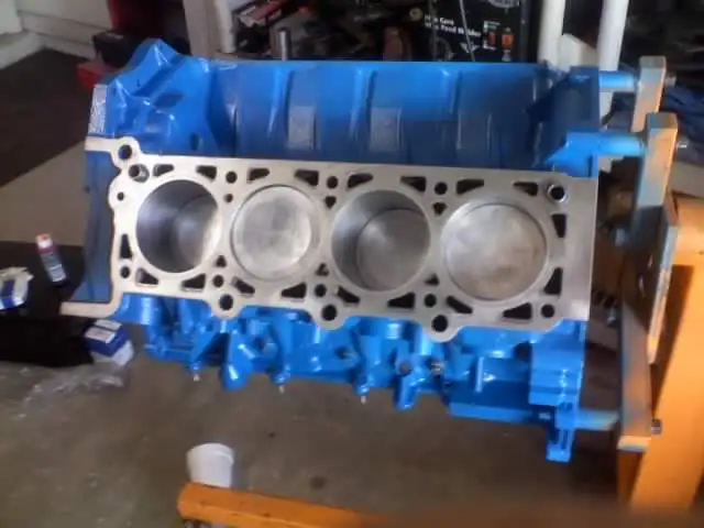

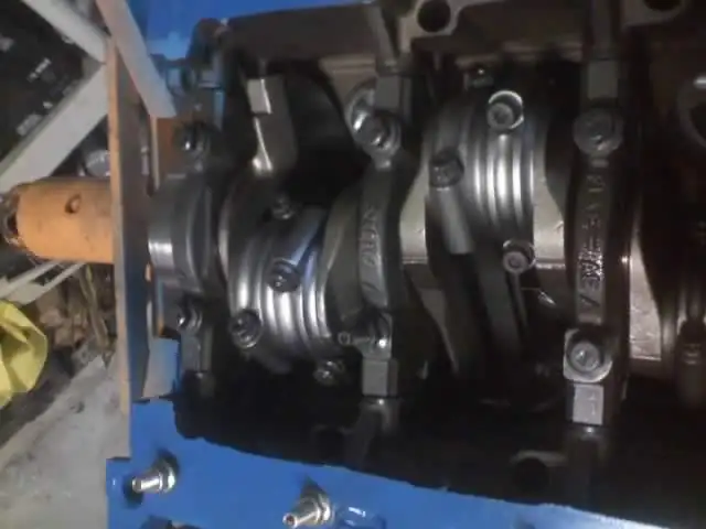

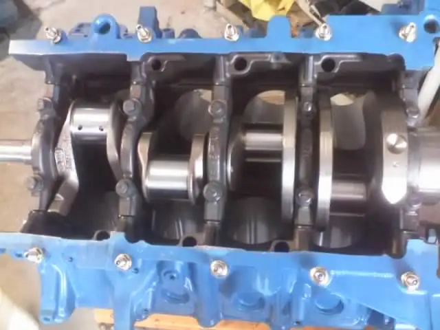

i got it all finished up today, i only need a few more little things before i can yank the old motor out and drop this one in:nice:, now im realy starting to get excited!!!
once i get it all finished and running, i can start saving for a little spray;)!!!!!

mod motor short blocks are very easy to assemble. theres no cam to deal with, so its just properly torquing, and dropping in a crank and throwing pistons in. when i assemble, i mic everything as well as plastigauge. i also only use ARP fasteners.
its so easy to assemble, that ford screws it up. read about all the Aluminator failures and you will know what i mean.
