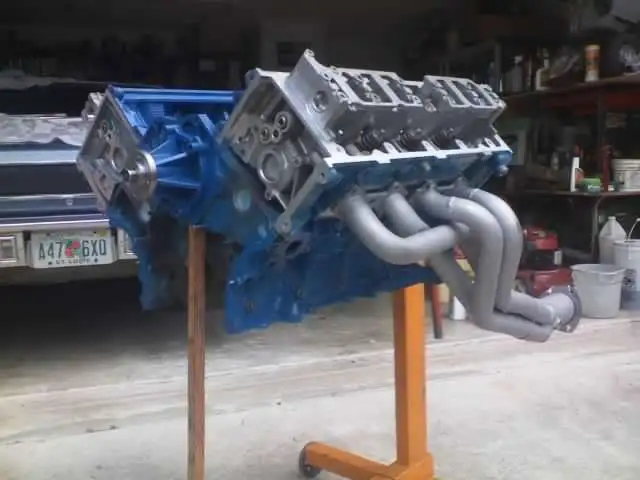

finished the bottom end today.....(pics)
a little whoring cant hurt:D
the intake ports:D

What oil pump did you go with?
Stock 2V blocks will handle 1000HP if not more all day long (same block as 03/04 Cobras), so will most of the aluminum blocks. The only guys that ran into problems in the earlier days were those running the non-teksid blocks (99, 01 Cobra) that were pushing big boost through them. There were no race blocks a few years ago and the guys making 1500-2000RWHP in the pro cars were running factory blocks.
Bill
Bill
I'm pretty sure the 2v and 03-04 cobra blocks are different. Don't quote me but I think it has to do with webbing, and more main bolts
