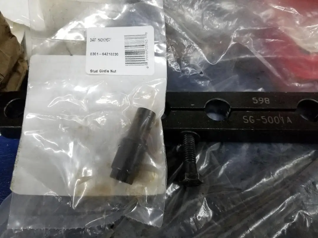

These little beauties came from multiple locations last night. They look well made, and actually fit all the dimensions required. The additional plus is that they are treaded so you can completely remove the poly lock from the top of the adjuster. Sounds silly, but that feature could have been useful in knowing that the adjustment issue we were having on one cylinder was not caused by the poly lock. They're in now, so we will button up the intake after I address the connector less orange ground wire we found last night.

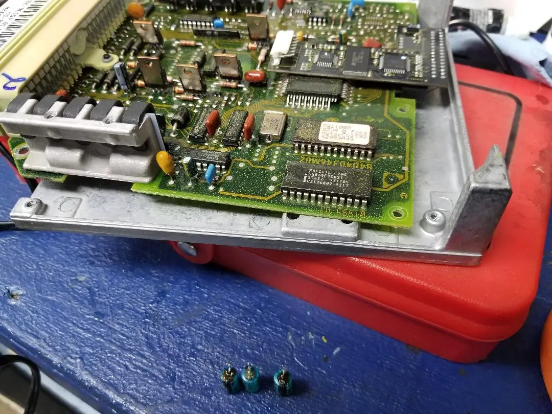

Amazon was able to deliver the resistors I ordered, so pulled the computer to look at the three resistors that tend to go south. Two of them were suspect with something like flux flowing out of the canister. So I've replaced all three since the soldering iron and de-soldering tool were hot.

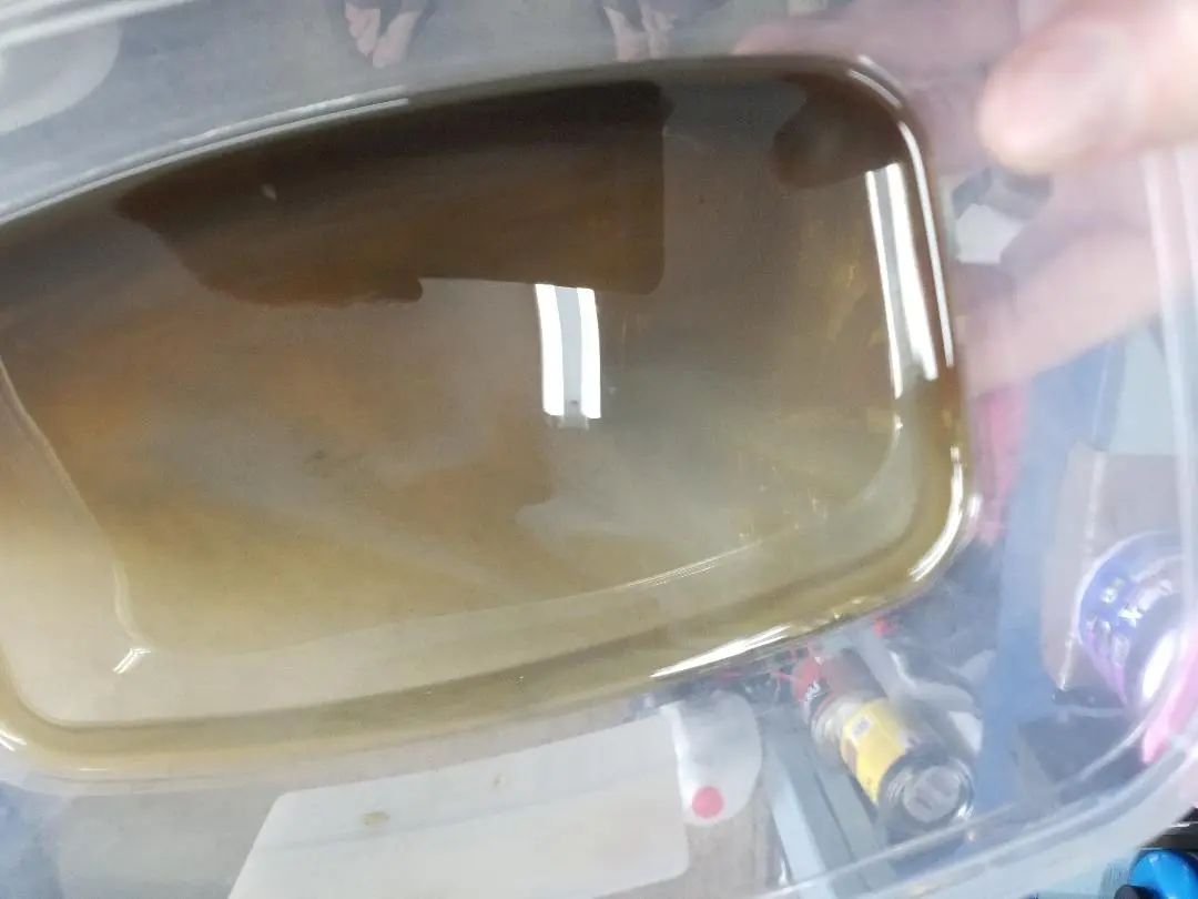

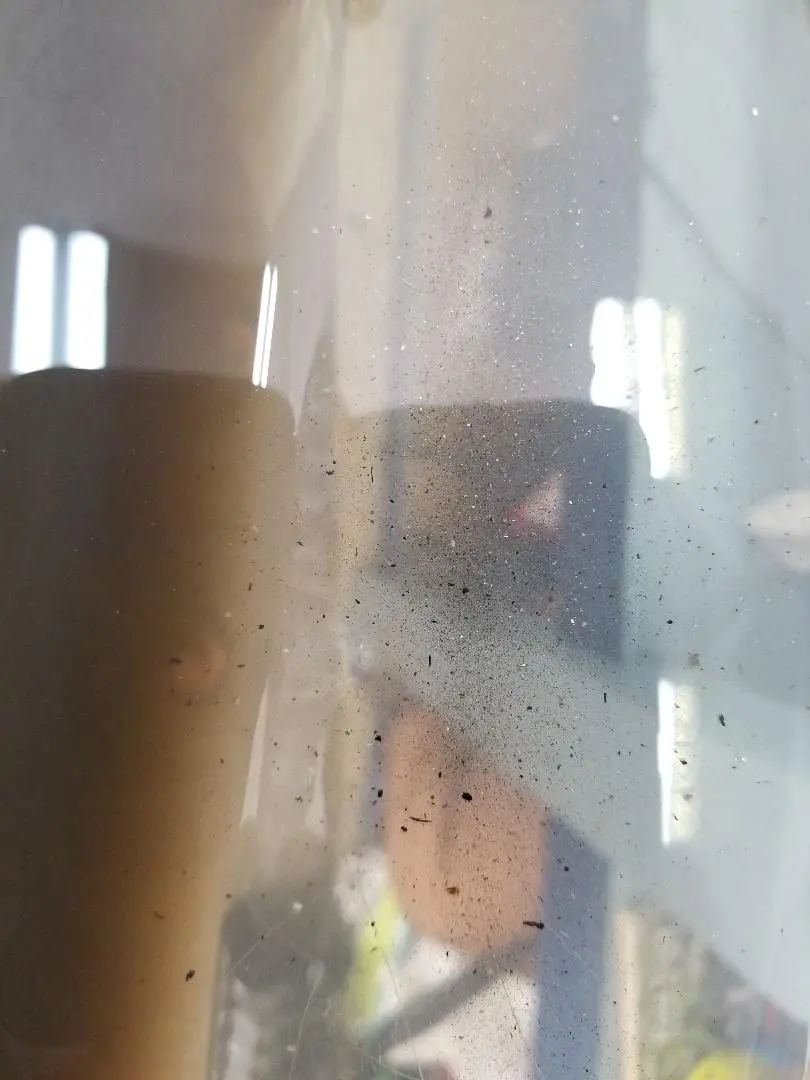

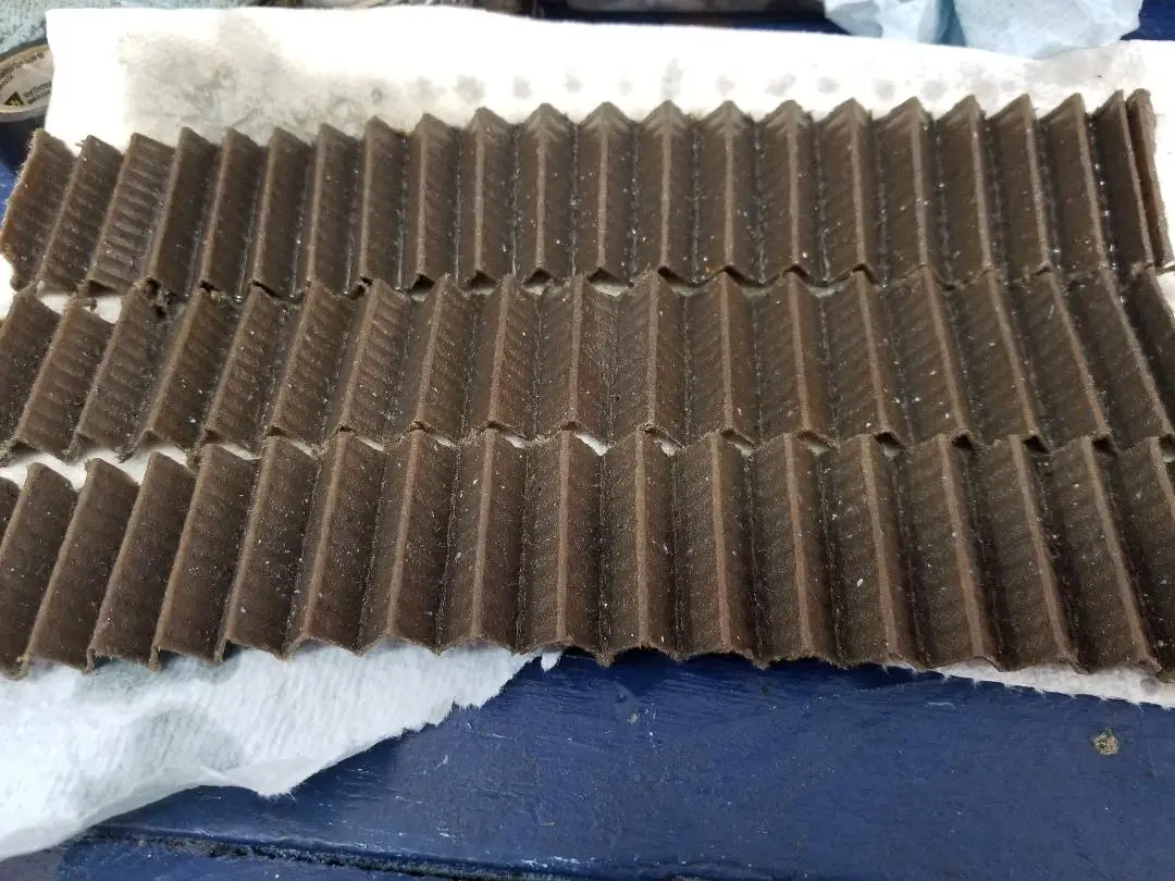

Noted, and advice taken Mike. So I pulled the filter today and was greeted by some House of Colors pearl out the initial oil in the filter. Not super excited ...yet.
Get a little more into it and drain a bit more out of the filter. Wow...pretty.
Now, either the inside of the filter has a thing for glitter, or I have a problem.
I'm about 95% sure I could pull the bottom end and find bearing damage. So guess I need to look into short block options at this point. It looks like I'll be getting some radiation treatment next week, so it will be several weeks before I can get around well enough to pull the engine. Anyone with suggestions on a decent short block supplier in Florida?

Some of that is engine start up crud from a not too clean engine..besides. I dont know if you can describe a bad bearing noise as a high pitched ring like you're describing.
I agree and think I'm dealing with more than one issue. I could get over metallic crud on initial breakdown, but am more worried about the amount of non-magnetic material (read bearing aluminum) in the filter. Add that to the smell of gas from the oil, and I'm sure another short block or machining will enter the picture. Om the second problem involving the noise. I'm running Autolite 3923s which should be two steps colder than stock. I just had one of my turbo buddies say I should be running 3922s and that I am likely hearing excess fuel detonating in the passenger manifold...? I don't know if it's true, but it makes me want to take a chance, drop my oil for new, and try and troubleshoot it.
