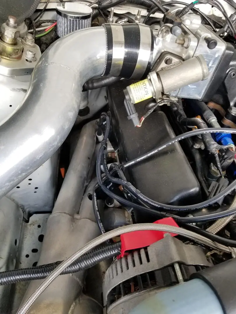

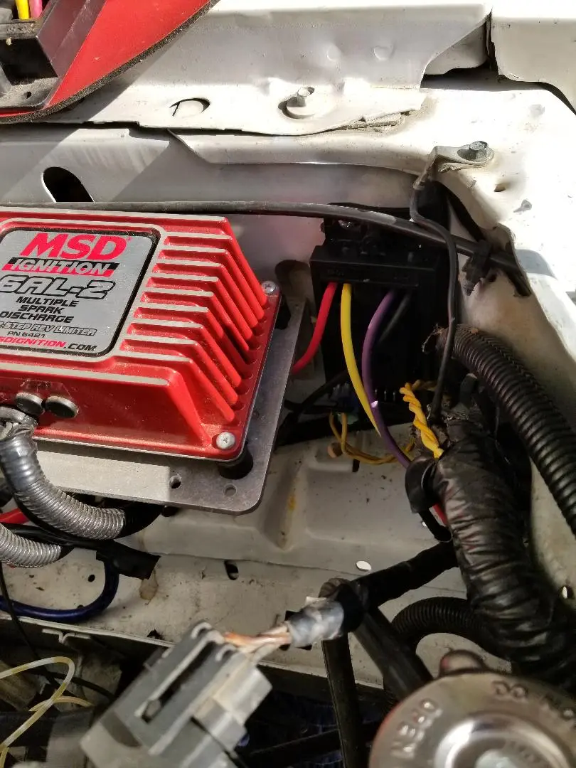

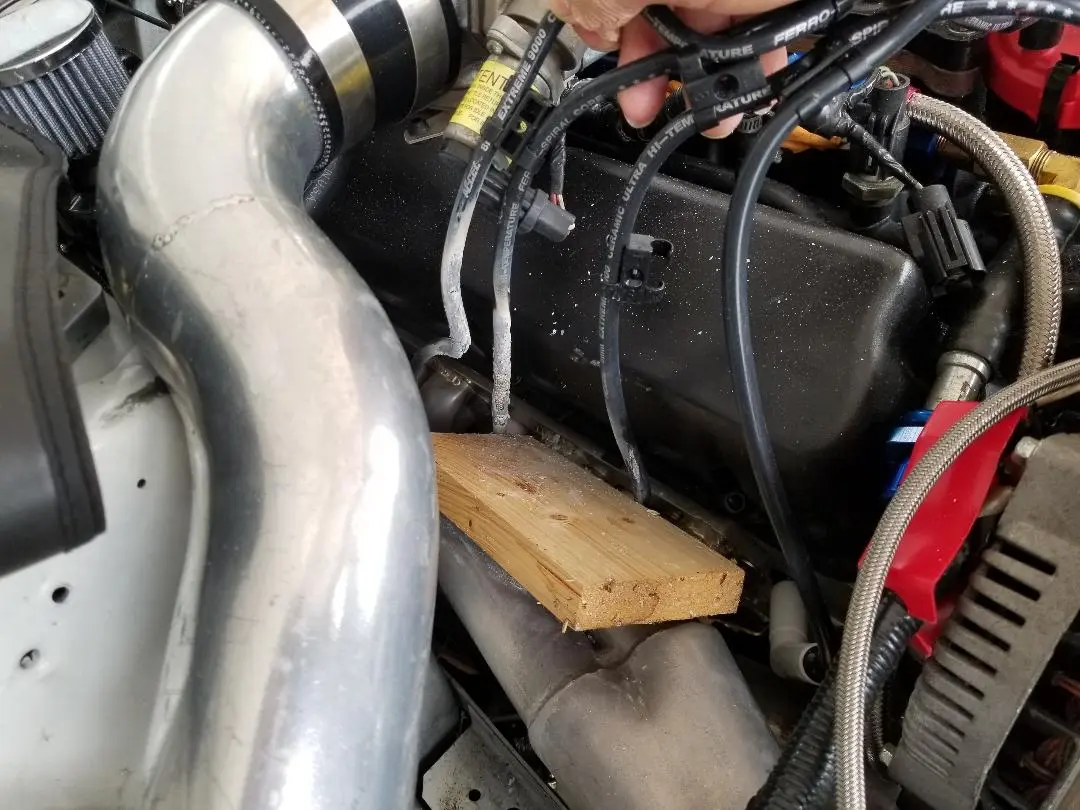

I've been seriously slacking. We got the disco snail back on last week, but I decided I needed to make the wife's "go to work car" road worthy considering we bought the thing only to find a koi pond where the spare tire well is supposed to be. Seems the quarter has been repaired and the body shop never thought to seal the seams. So for the excitement. You know there are things that only you as an individual can do. I know ya'll are thinking "go on Tony Robbins." Well I have found I am uniquely able to tear up things that are intentionally made to resist the method of destruction I manage to use. Todays example, my bleepin cashy Accel ceramic wires. Not only did I manage to melt them, but being the unique individual I am, actually set two of them on fire after the made friends with the turbo manifold on the passenger side. Now I bought these freaking thing for their resistance to heat....i.e. they are flippin ceramic. Never would have expected that they would actually catch fire and I've never seen a wire do anything but melt or arc in the past. I'd have a great picture of my attempted fiberglass hood fire, but I dropped my phone as I wrestled the fire extinguisher away from an over eager buddy. We all like to save the day....well until we spend three days cleaning an engine bay from the joyus powder of the extinguisher, Looking back, well I gave it to him to hold, so my bad. So two new wires will cost about $27 a piece from Summit.
