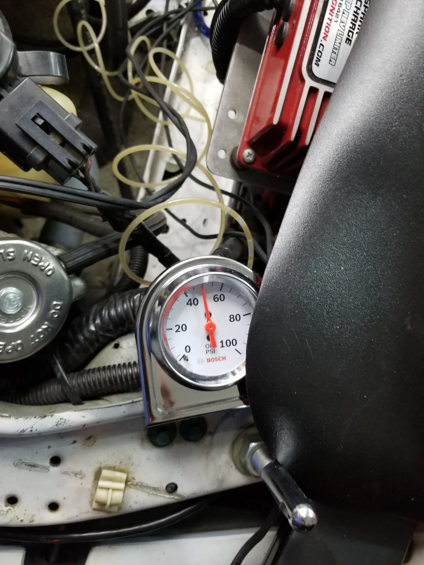

Have had a ton of company, so haven't pulled the turbo yet. I did put fresh oil in it and have about 20psi at 100rpm and 50 at 1100rpm with the drill. So check my thinking here. Every cashed out bottom end I've experienced dropped a ton of oil pressure if the bearings were bad. So am I being paranoid about all the trash I found in the oil?

Ok so no input pm main bearings and oil pressure experience. Maybe some turbo experience here then. I still have not pulled the turbo, but had an interesting conversation with my father. In it we came up with a theory regarding the metallic noise I still haven't tracked down.

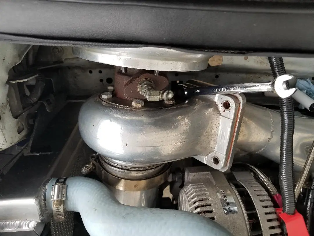

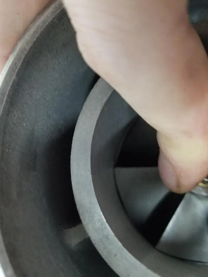

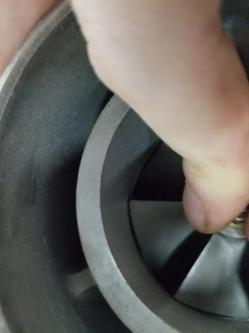

I pulled the snail out today and can't find any sign of anything contacting the exhaust or the intake side. The impeller has some up and down movement that concerns me a bit. The below photo is of the extreme gap.
Then the impeller pushed toward the wall.
Again, no sign of contact, just my own paranoia of "things that might be wrong." I'll contact one of the local turbo shops tomorrow and see how much the want to take a look at it.
On another note. It's been a long while since I've seriously wrenched on this car and I'm re-learning all the F-ups I've learned previously.
Not easily seen, but this is where I locked my ratcheting wrench between the bolt and the center section of the turbo, requiring me to remove all the other bolts and break the sealant loose to get enough space to remove the wrench. Doesn't sound like much, but this monkey has done this about a half dozen times. As soon as I realized it, I felt like kicking myself in the junk.
