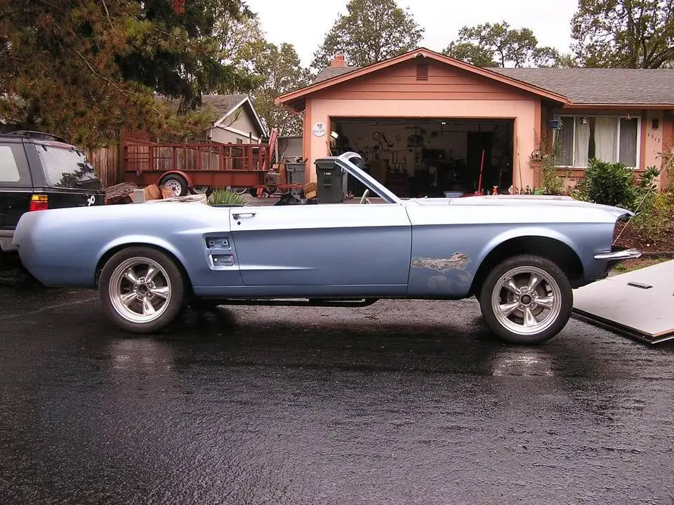

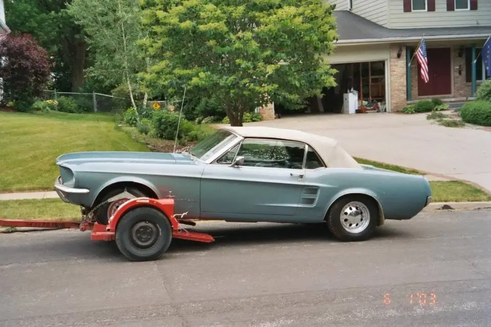

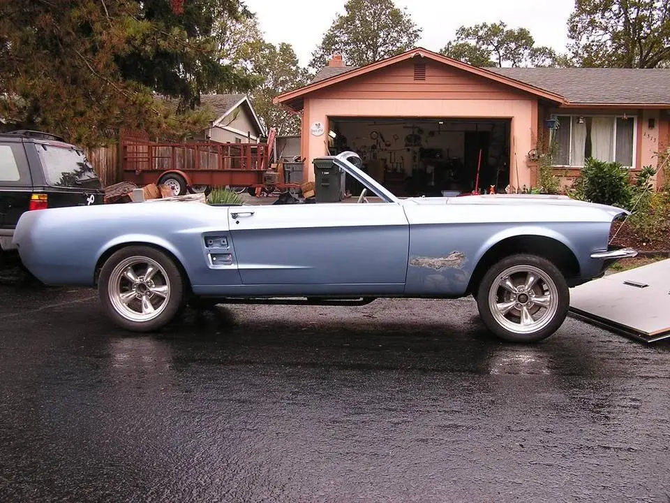

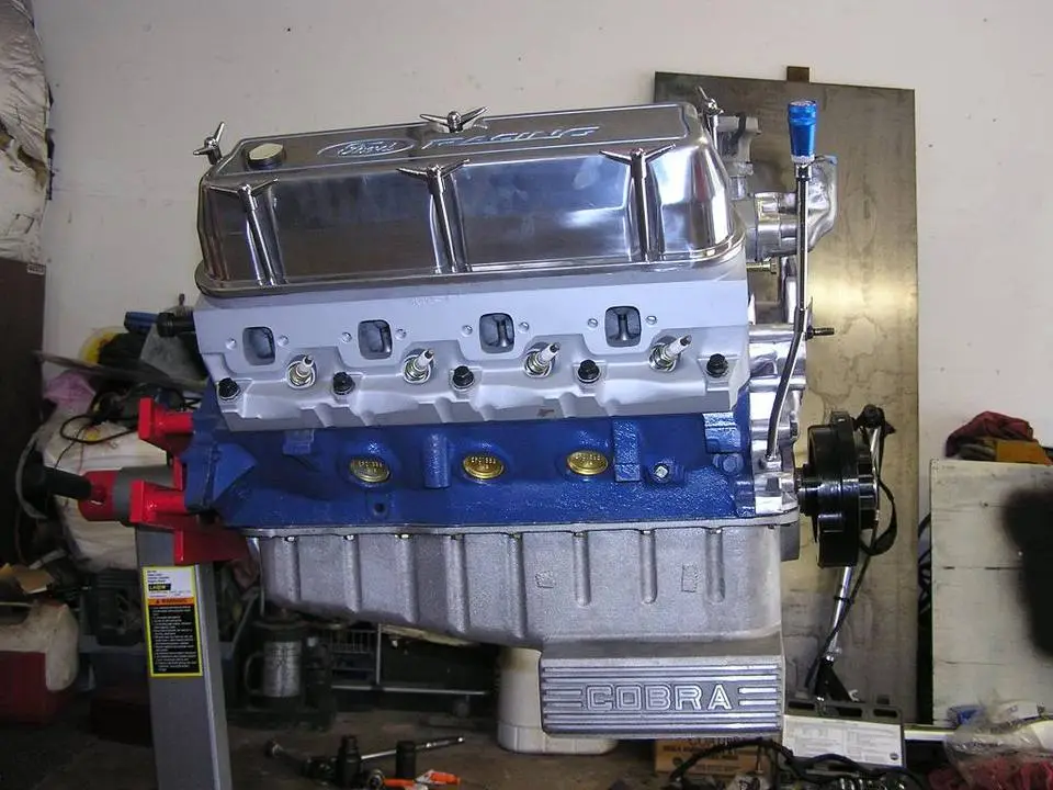

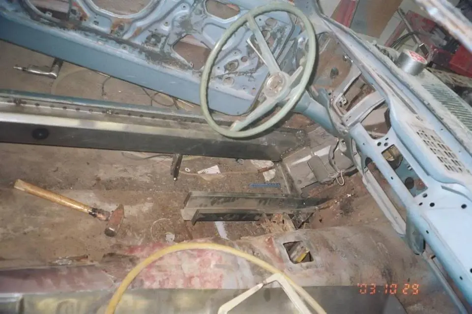

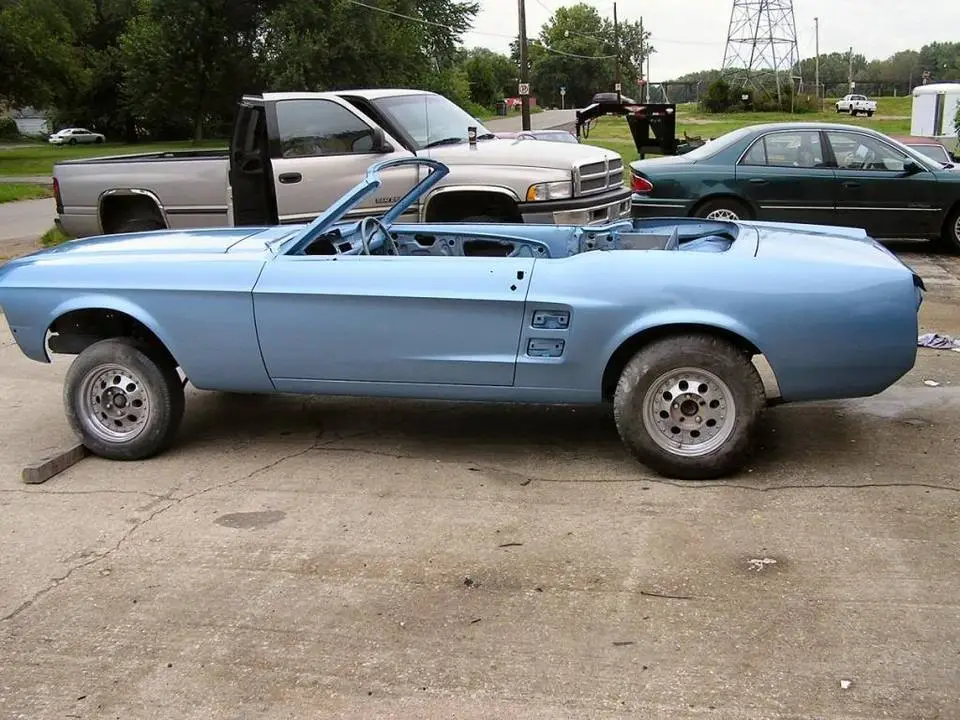

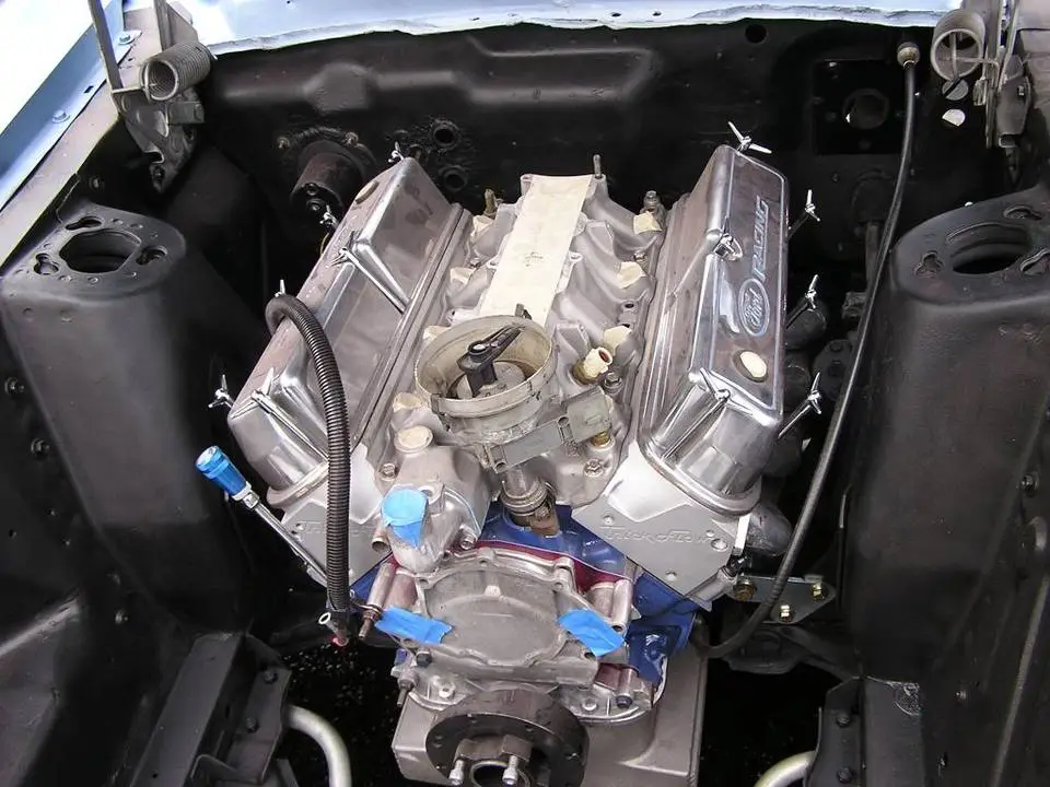

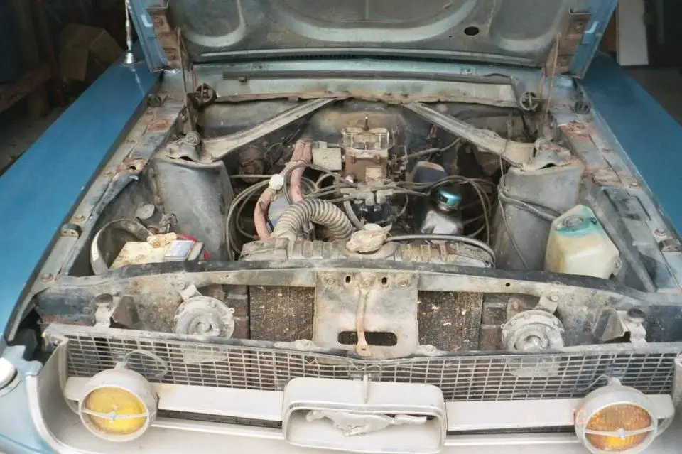

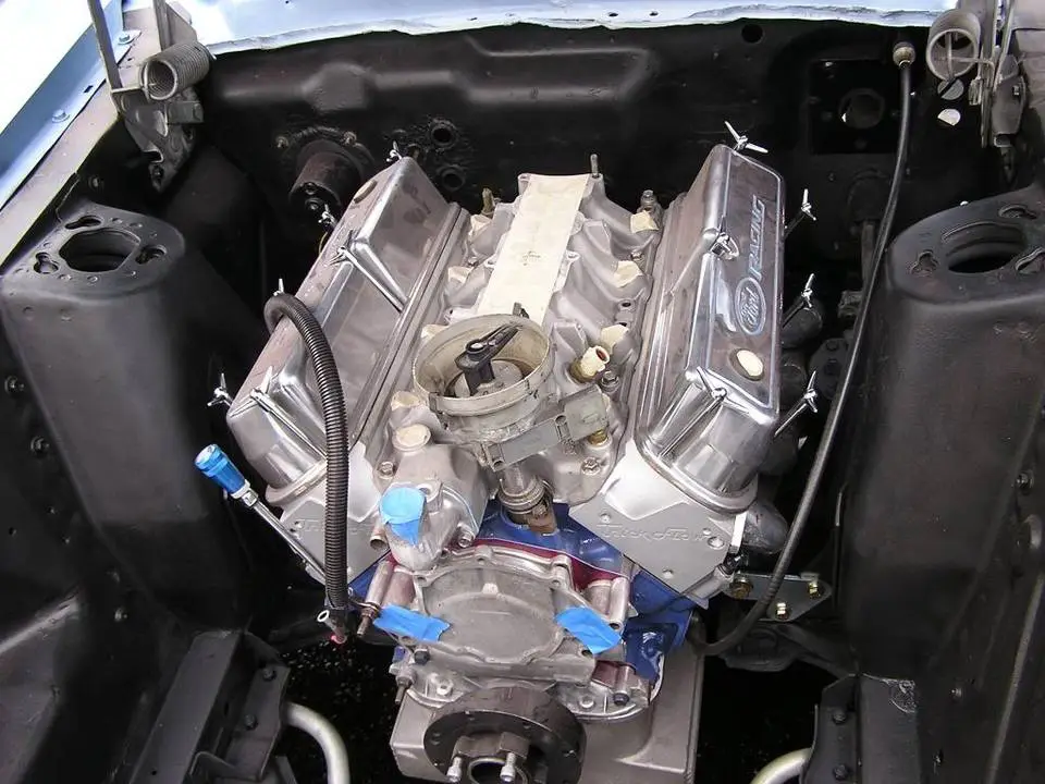

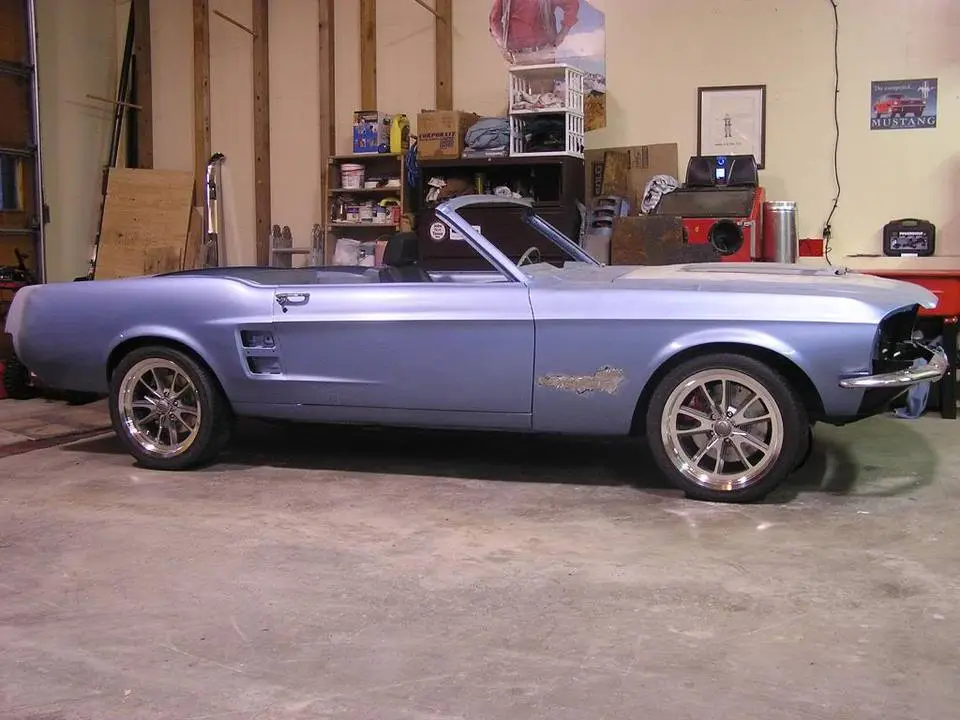

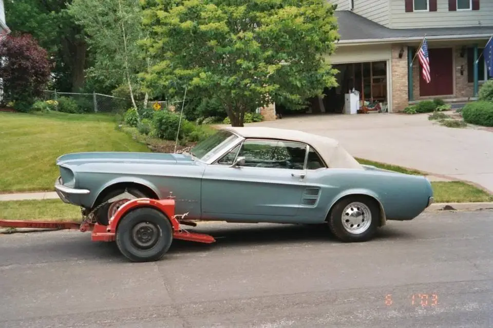

Here's some old pics to show some of the journey.

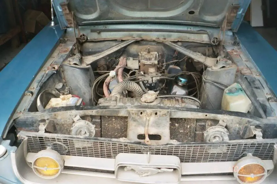

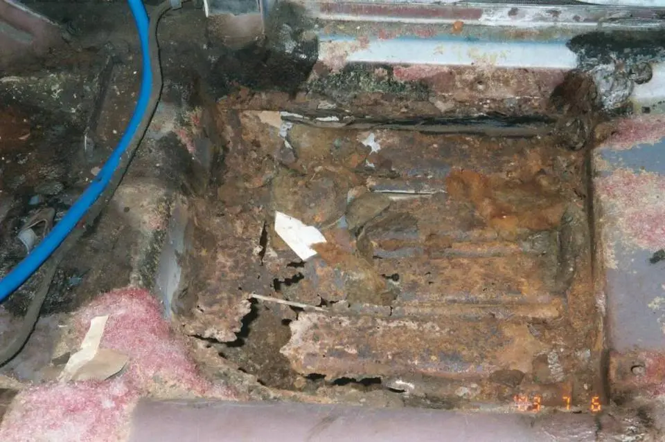

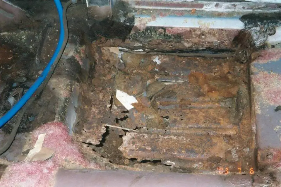

Car was towed out of a garage in IA in 2003, where it had set dead for 10 years.

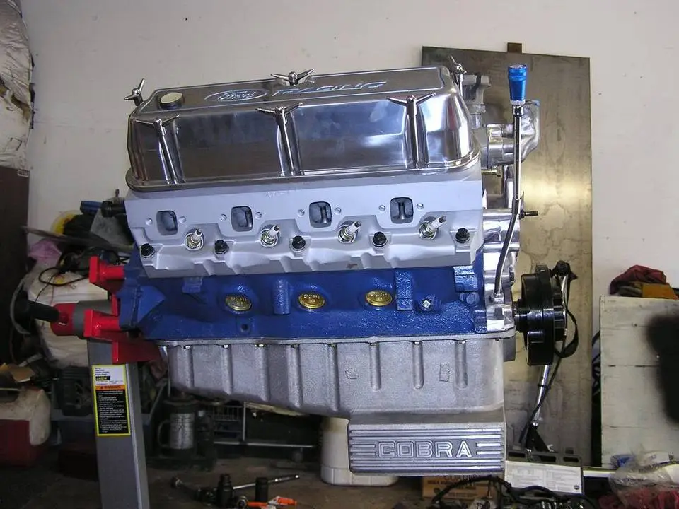

Original 289 was shot.

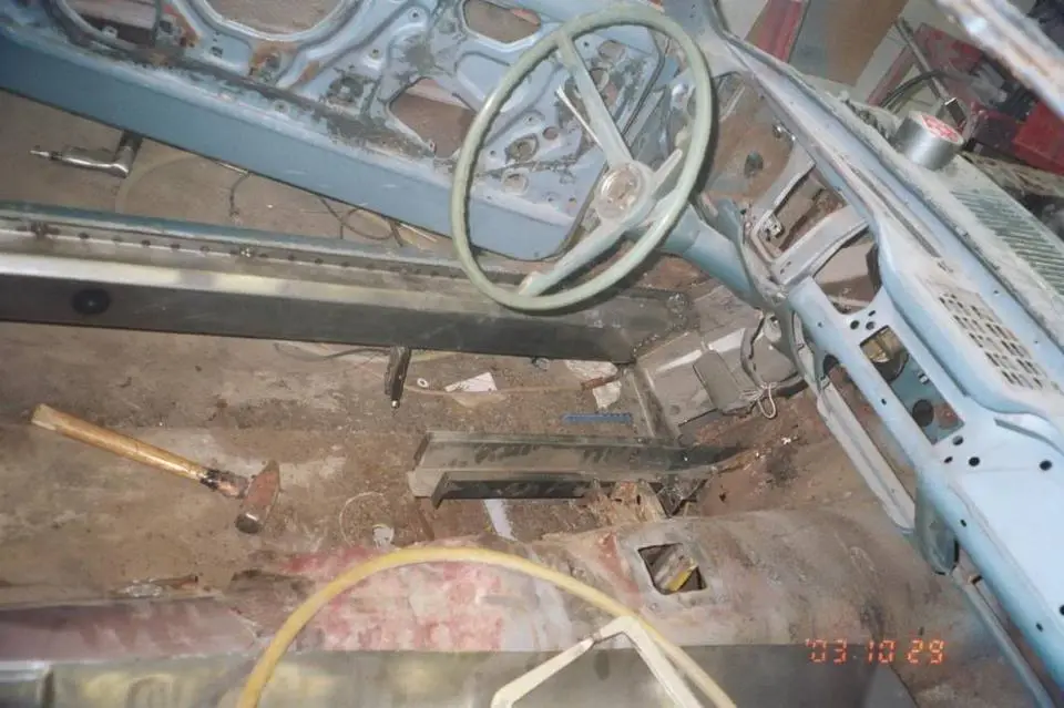

Complete basket case with rust;

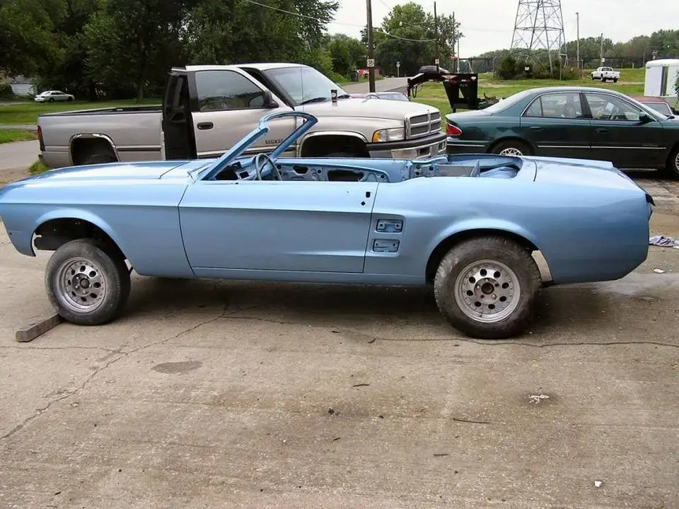

spent over a year at a body shop, came out with a nice paint job, and was immediately loaded on a trailer and hauled to WA, where we moved in 2004.
Discovered then that some of the structural repairs weren't square, so I ended up tearing it back down to rebuild quite a bit of the rearend. Bought a 91 LX donor car for the motor, trans, and rearend (body on the 91 was beyond saving). Rebuilt the motor and tranny in 06.
Got those installed along with new wheels, and lots of little stuff, before I moved the car to AK in OCT 06.

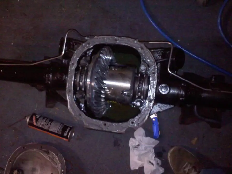

Modified the 8.8 and installed it, along with Bullitt brakes all the way around. Found a great deal on some Recarros out of a BMW, and inherited aHUGE project rebuilding the floors to fit those. In the process I canibalized the e-brake and console from an 01 to put an e brake handle on the hump rather than under the dash.

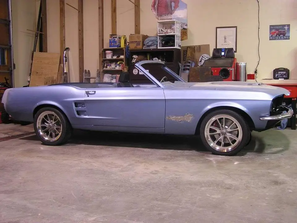

Then I took 2+ years off to go to grad school. This is about how she looks today.
That's the Reader's Digest version. My wife says I should write a book telling the whole story. Wound up with lots of headaches, and two lifelong friends out of the deal.
I'll try to take some more pics in the next few days to update progress (once I make some!).

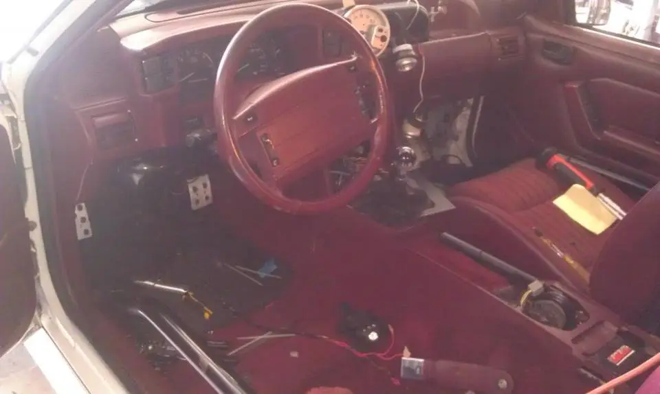

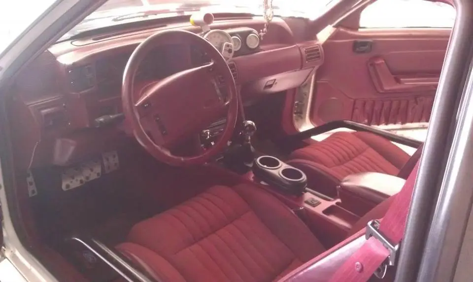

Took a second crack. Gauges are in. Switch panel is done, gas tank is back in and the interior is in. Still have not figured out where to mount my 2 step switch off of. I've seen guys do it off the clutch pedal, but it seems to require constant adjustment. I'm thinking of doing a bracket off the shifter. I need to do more research.

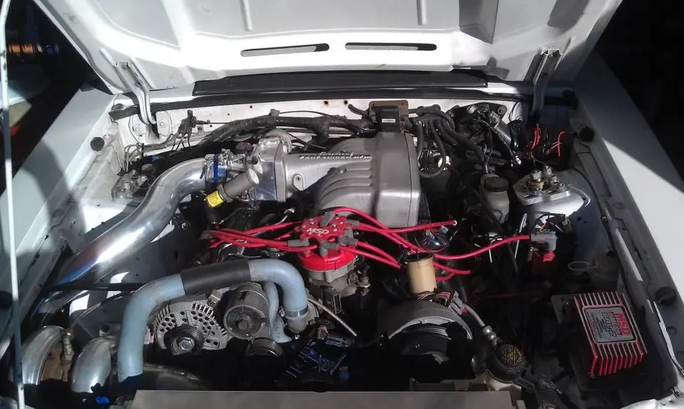

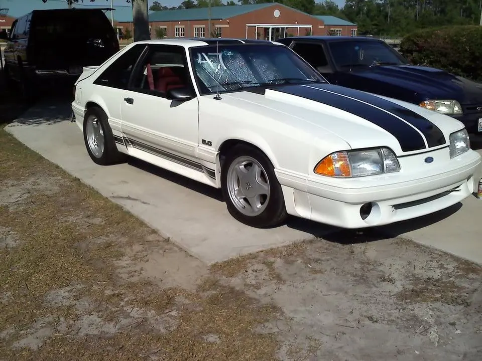

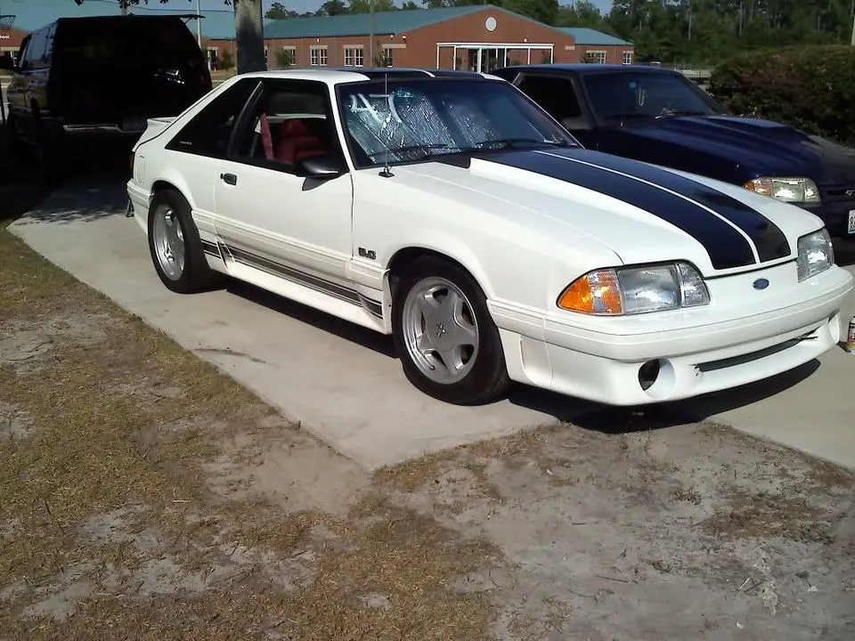

Here we go.

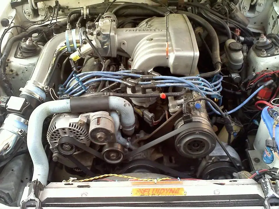

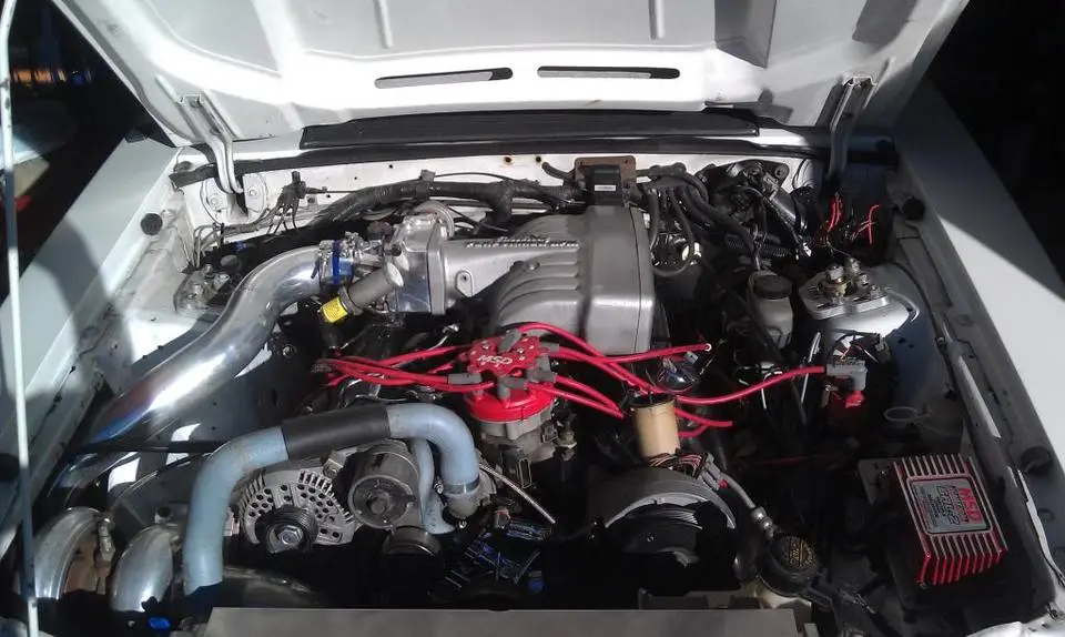

i picked my 92 up when it ran fairly poor. It was intended to be a parts car.
Idecided to make it my street/strip car and sold my blue car. The motor was well built and had a lumpy N2O cam.

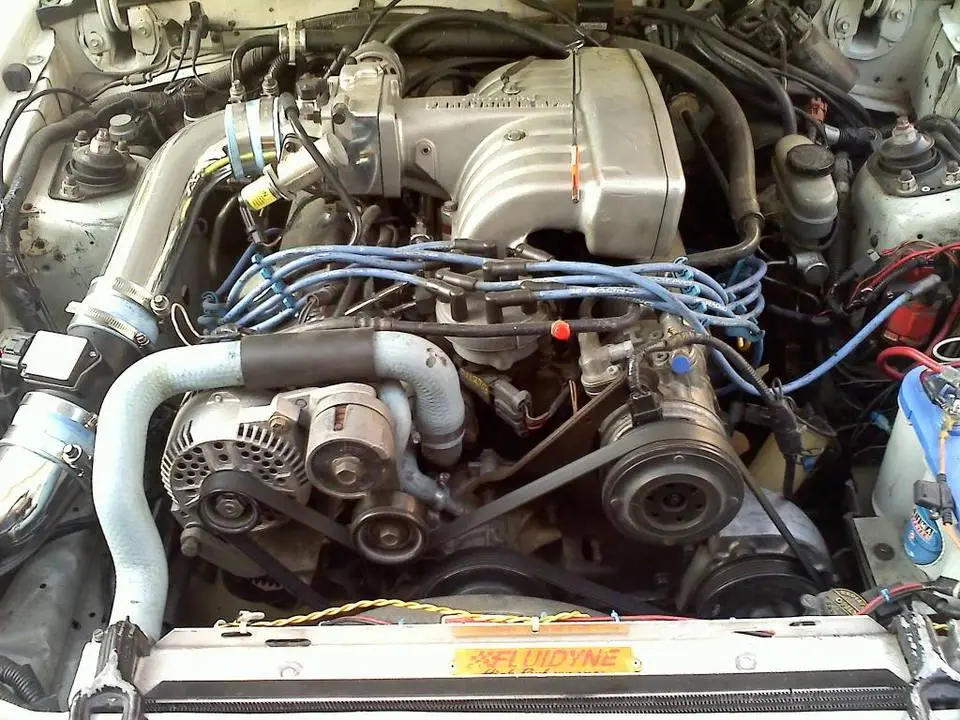

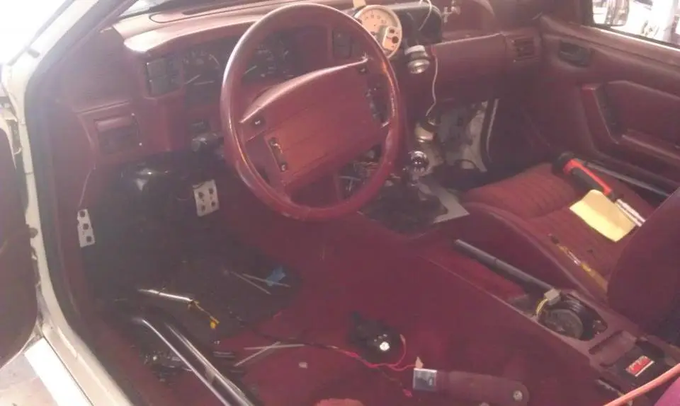

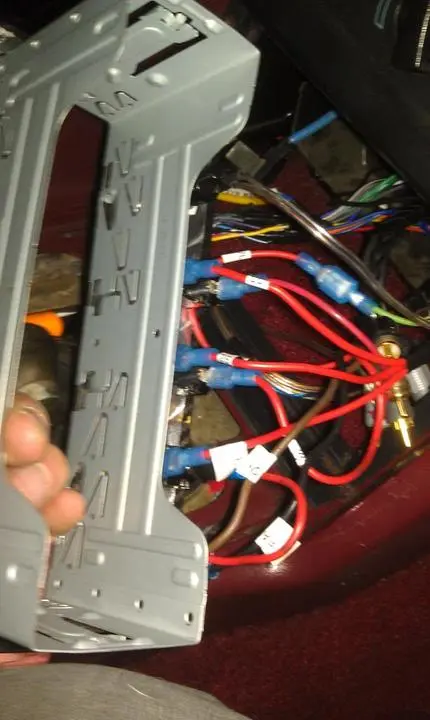

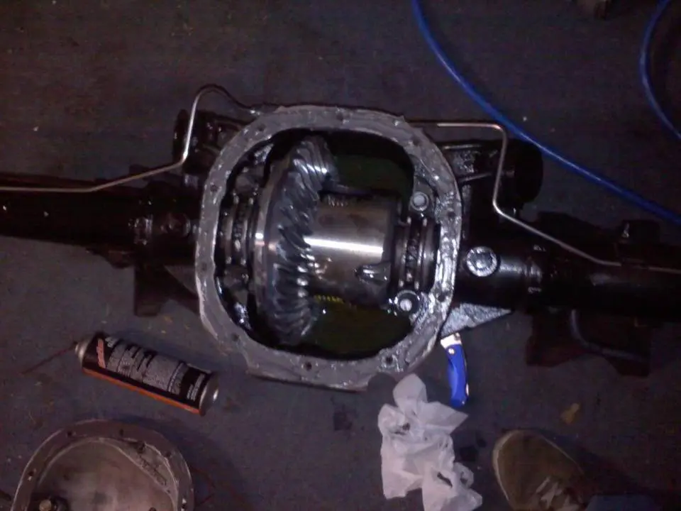

I'm minus alot of the evolution phots, but removed the battery,and re-wired a good bit after installing the turbo. The wiring toward the hood hinge is my 2 Step, line lock and fan wiring. Its been loomed and hidden.

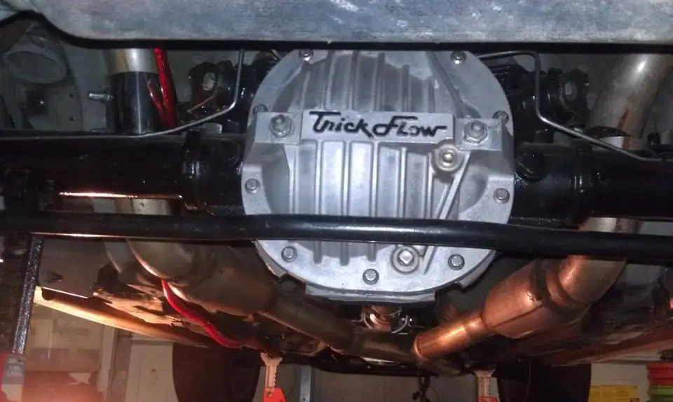

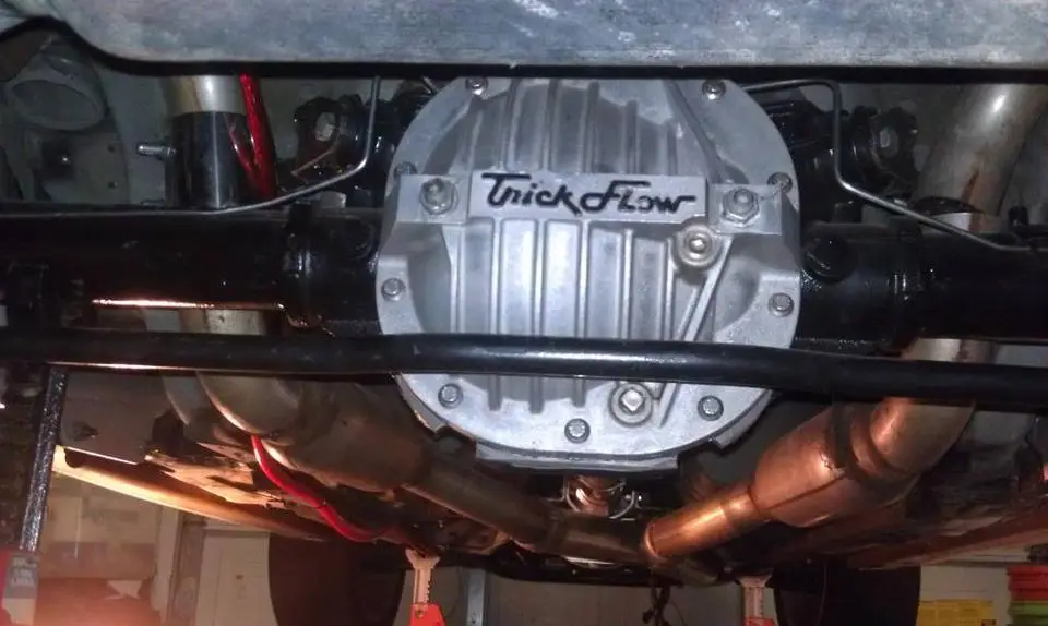

The rearend was done around the same time I started the engine bay. I used UPR control arms and Coil overs with Strange shocks. I welded (with help) a new 8.8, cut the ends, added an Eaton, my FRPP 3:55s, Mosers w/C-clip eliminators and ss brake lines.
Then the final install

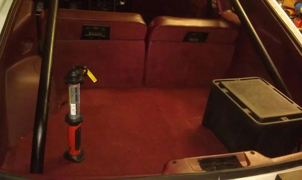

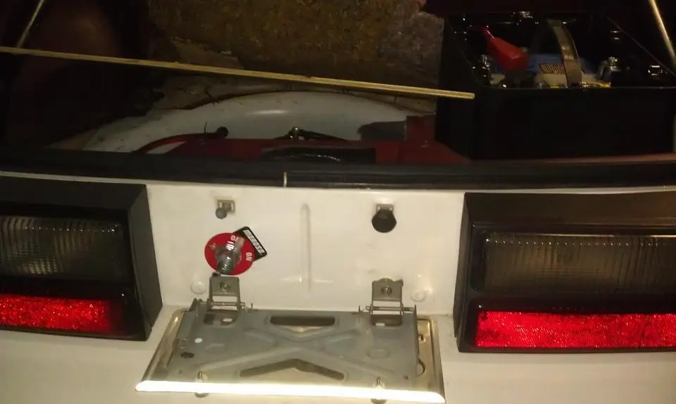

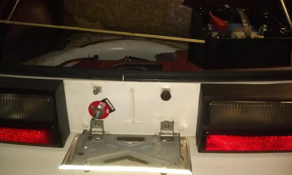

The battery relocation has been ongoing. I opened up the tranny x-over mount and grommeted it to put th 0 gauge cable through it and started my switch and battery box mount. I put another floor together, so I could get a cleaner install. Cut, fit. re-cut, re-fit....throw hammer...
The breaker, wiring and mount took awhile, but I'm happy.
The drop down battery switch came out decent. Scrapped the old Caddy plate holder for an 80s Camaro. The hood bumper will be used for bothe spacers when I get my hood pins done.

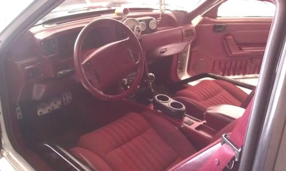

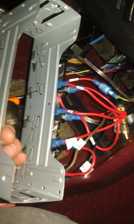

The gauges,and wiring still need some work. I found that my wide-band is wired with constant/keyed resversed and my Line lock light ground came undone. Heres the mess I started.
I had a heck of a time with my switch panel. Just couldnt figure out how I wanted it. I spent hours debating the way it looked and ended up painting small parts that did'nt come out looking right. Finally came out with this.
All the wires are labeled ( but the A/F gauge..lol).:nice:
It ended up looking realy plain as it came together this morning. I'm not a huge fan of red, but cant get the inside quarters out with the roll cage.
As far as the front end, I put in a UPR k-member, coil overs w/Strange adjustables and some MM corrective A-Arms. This is a poor picture, but represents what the car looks like "on the ground".
So I got it running today. A/F is off and I learned a new rule. If you did not tighten one end of an oil line, you probably didn't tighten the other. Also found my TFAL controller is not working. Could not get it to upload.
