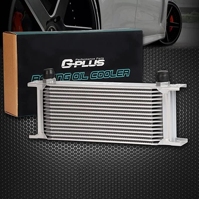

Two questions.
1. Is anyone running an oil cooler on their Fox. If so, what do you recommend?
2. I'm considering a new puller fan for the radiator. Anyone have an "inexpensive" suggestion?
I say "inexpensive" because I have just found Mishimoto, is no longer the cheap brand I remember it being. Heck, the want almost $400 for their oil cooler now.

I know contour fans used to be the goto cheap option for an electric fan-when my father in law still had his fox body, I installed a factory cooling fan from a sn95 with no muss/no fuss. My 94’ has the factory cooling fan pulling through the radiator,and I added a parts house pusher fan on the condenser side wires to a relay. That setup keeps my car fairly cool in the middle of summer-sitting in traffic etc. But I don’t have a hairdryer adding all that under hood heat-so As far as oil coolers I’ve never had anything super fancy, I think I’ve just used the Hayden ones

look at the front end of the Monster. Two Stacked fin oil coolers hanging under the front bumper. One is an engine oil cooler, the other is a transmission oil cooler.
16 rows I believe, -10 in/out. the last time I bought one it was...40 bucks on amazon.

I bought my Hayden cooler of eBay

I ended up with the vastly more expensive unit in black. To be fancy, it comes with lines, fittings and oil filter sandwich. I'll let you know just how chitzy it is after our Chinese hot rodders send it to me.
