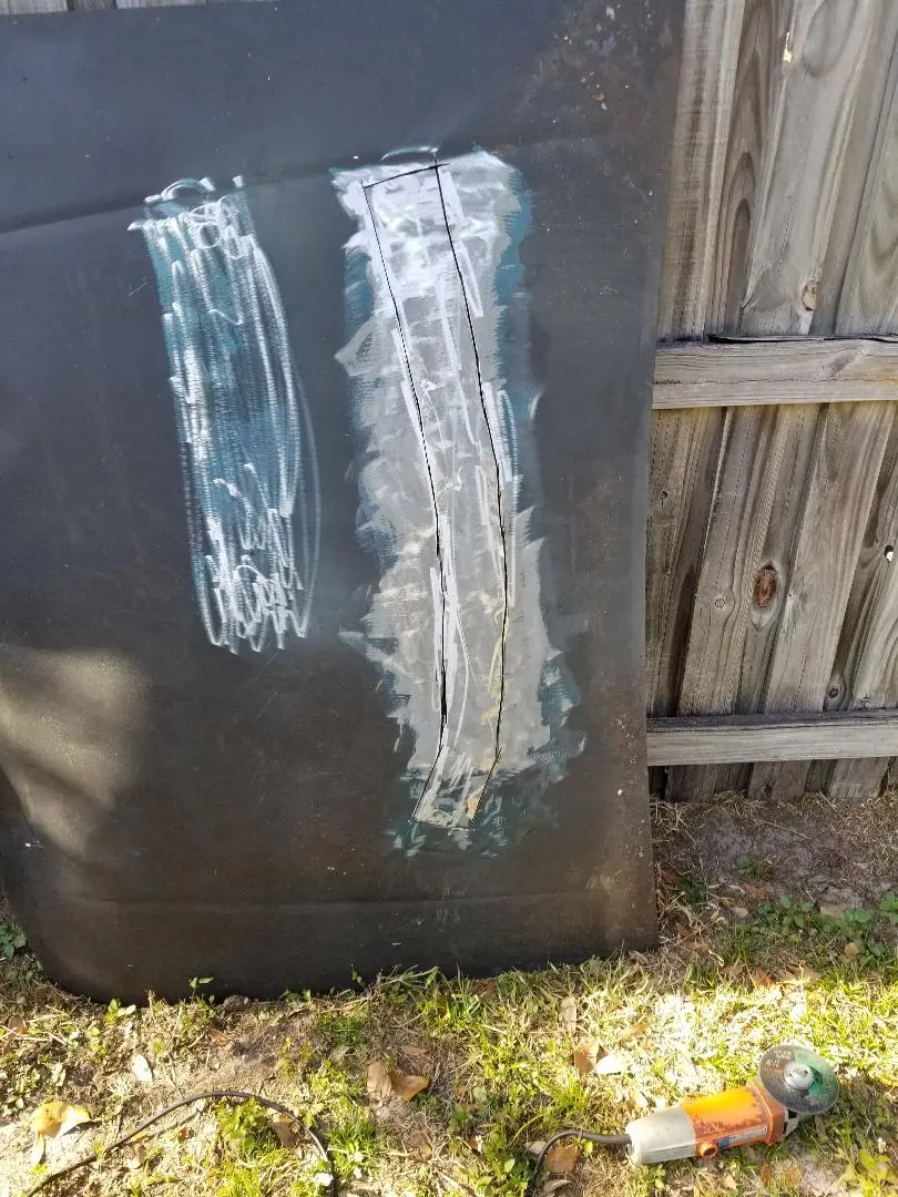

I managed to cut out the floor pan on the Jeep today. With the covid shot and other junk they've got me on, I'm just obligating myself to those jobs that I can work a little here, than a little there. Today I managed to cut the pan at my initially drawn line. Only problem is that I was supposed to mark a line an inch below it, and then cut. Again, kicking myself in the groin. I would have been better off finally getting the vacuum line I need to get the MS in. Oh, had a piece of grinding slag imbed in my HF safety glasses. ?It's sticking through the eyeball side. Time to stop trusting my Chinese buddies with my eyes I guess. For those with the WTH are there no Mustang updates?.....promise, I'll get there eventually.

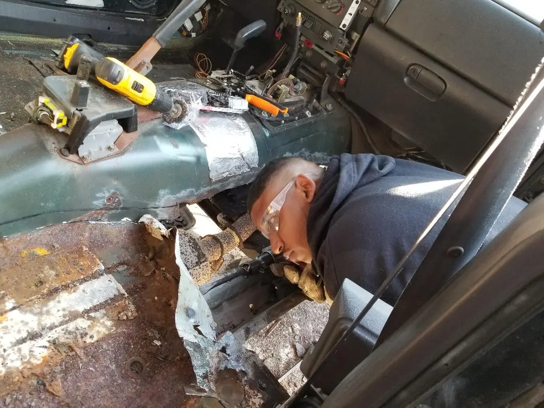

As far as today, I found out I grabbed the wrong size vacuum line for the Mustang, so I just continued on with the Jeep. She'll have a bit of Ford in her as I took the patch panel out of an old Ranger hood I had. I figure a lot of you guys have done this before. As usual, I just figured it out after the local JY wouldn't let me in with a death wheeled Dewalt 20V.
Probably the coolest part of today is that the Jeep became me and my Son's project. The big dude is high functioning, but doesn't drive due to his special needs. Doesn't slow him down, and definitely didn't stop his interest in air chiseling half the pan out from the Jeep. I honestly thought he'd get bored chiseling out spot welds..........completely wrong.....lol

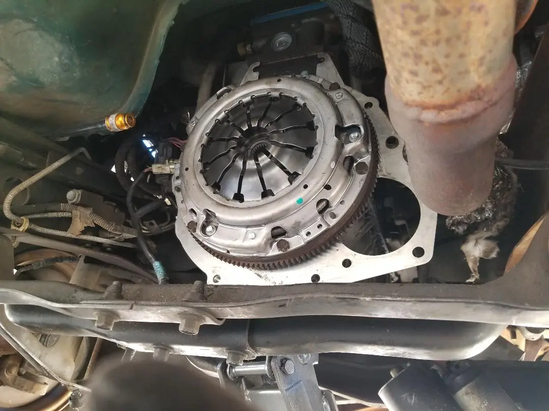

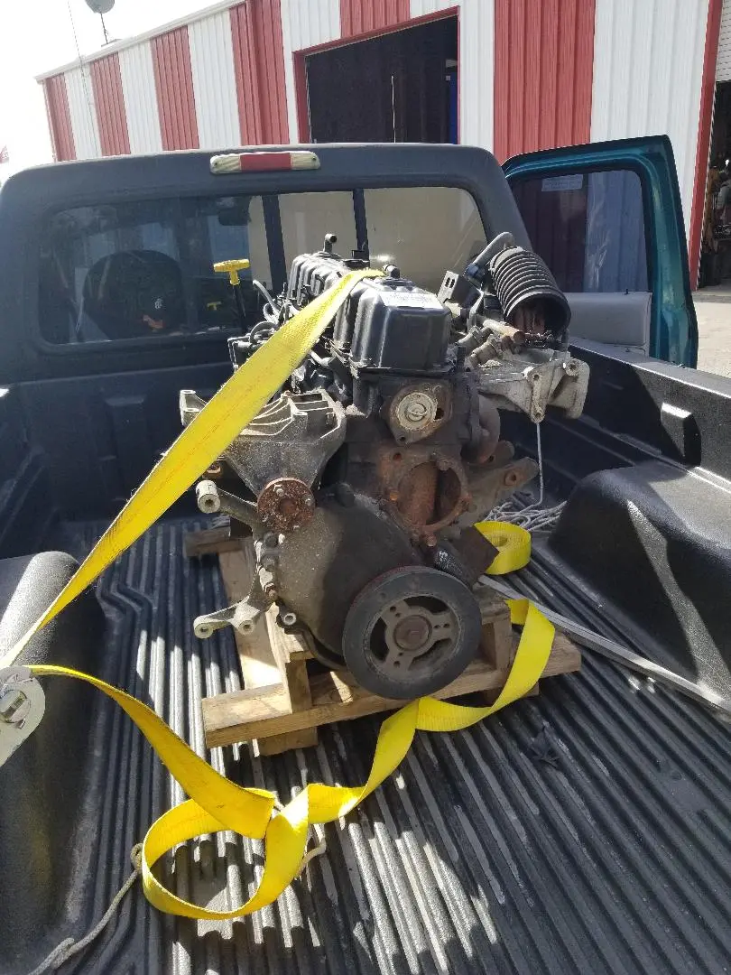

Well, the Ranger's clutch took me three days thanks to an over indulgence in red locktite and Ford's ingenious hydraulic set-up. Had the gentlemen I bought the Jeep engine off of come up with a "you know what I do on those clutches." So after two hours of vacuum bleeding the clutch, I took his advice. Remove the reservoir cap, pump the heck out of the clutch, then slip your foot to the side and let the pedal rebound violently. It's voodoo, but after a couple of times it shifts like butter now (Thanks Ryan). Again, why would Ford use a hydraulic clutch on a 4 banger truck???
Anyway, the little Ranger is up and allowed me to go get the new-ish motor for the Cherokee.

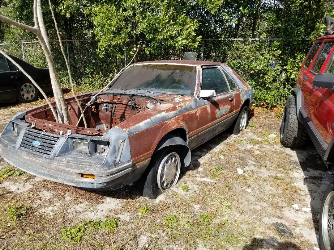

As great as it was to finally pick this up, the coolest part was being able to see one of GeneralCarThief's projects.
I love the patina, but really admire the alternate fuel concept. I mean trains were powered by steam, but hickory powered foxes....right. No, honestly, what a bad arse excuse for lack of progress. Mine is getting the wrong vac line. JR's has to do with nature just telling him it's just not time...lol. Just like him to one-up the rest of us....lol.

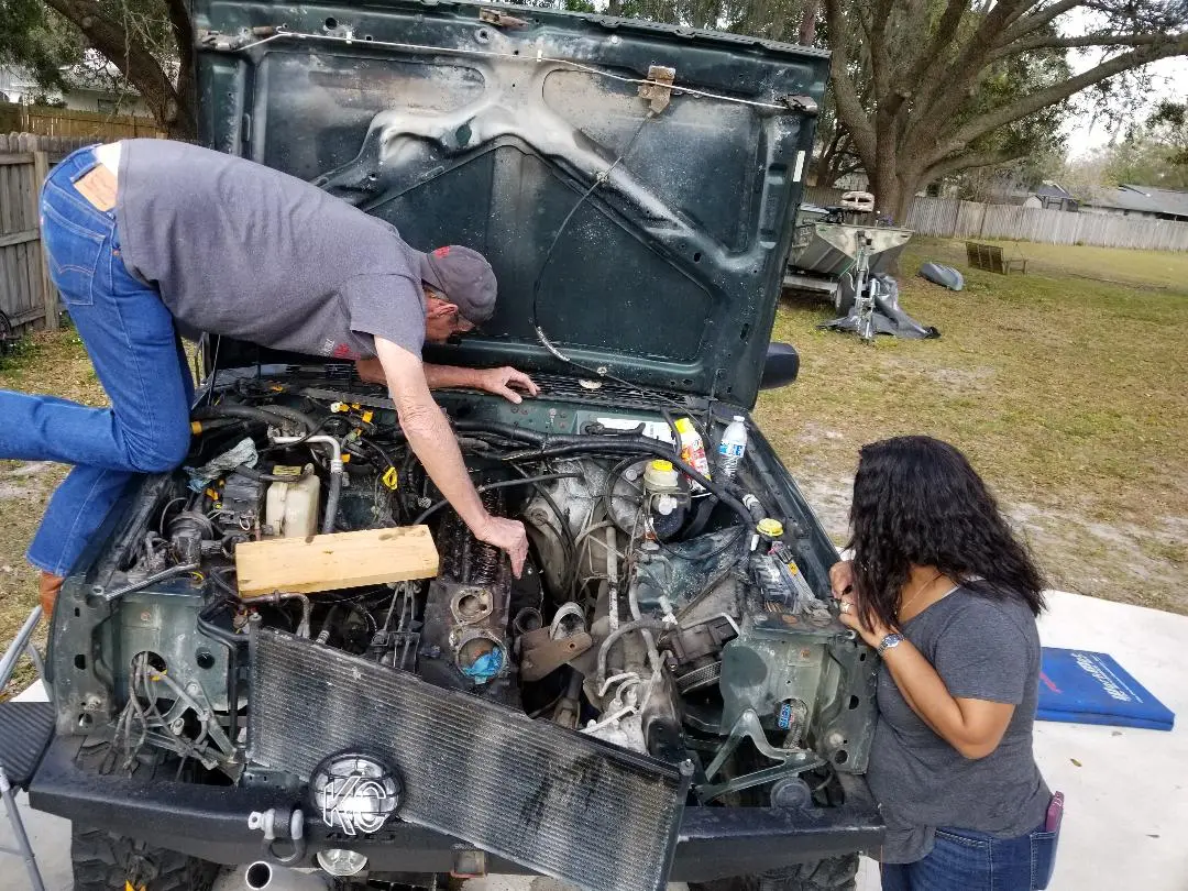

Yesterday was another great day. It seems like I've been working non-stop on about every car I own except the Mustang and the Audi. Doesn't sound like much, but we have seven cars, not including the mother/father-in-laws vehicles. So you can't even imagine how awesome it was to have a few buddies show up to help get me further down the road on my XJ. These guys were so helpful I often had a heck of a time finding something to do while we were pulling/installing the motor.
This picture was typical of the day, and I mean the full day these guys helped out.
What you can't see here is that JR is talking to Steve underneath the doggone Jeep. Steve did actually volunteer to be the guy pullling trans bolts, so hopefully he'll talk to me again in the near future..lol. Another thing you don't see is my buddy Flint running ( for the umpteenth time) to get us replacement bolts for the E-torx that we had so much of a hard time with. I'm not used to it, but we accomplished this thing they call "progress." So much so my better half actually came out to see what "progress" actually looks like. At the end of the day, the guys got me to the point that I just need to button up the wiring, vacuum lines, and some odds and ends. Again, it's just great having good folks in your life. Thanks again guys, and know I'm there when it's your turn.
