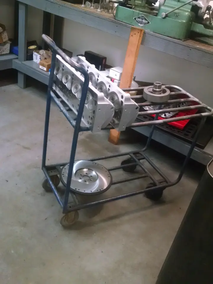

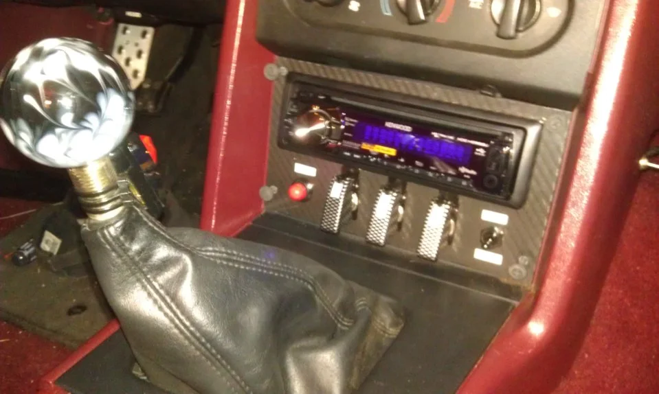

#A5Literman: Joe probably has a better set up, but my father has been buying me these custom pool ball shifter handles, so below is the picture of mine. It took some clear tubing and some small zip ties to ensure to would be just comfortable enough to use, but uncomfortable enough that it doesn't get accidentally used. The photo is a little off with the flash, but the tubing looks black in normal light.

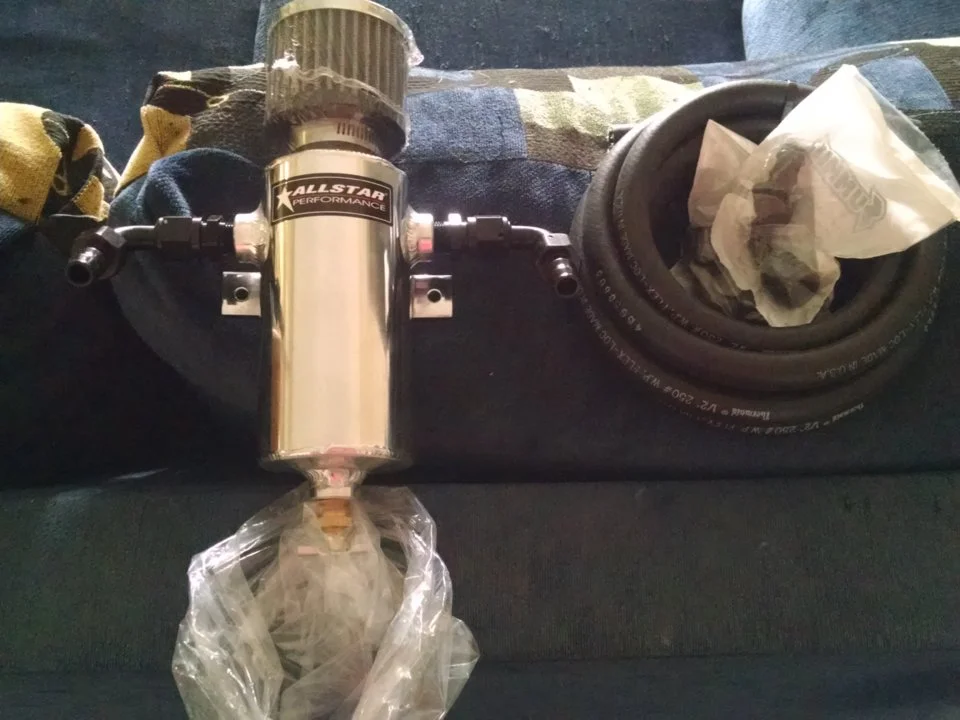

So I did figure out how I will do my catch can set-up. I'm going to weld to 8an bungs onto the fire wall side of my valve covers and a fill bung towards the front of one of them.
So I had to check with my Dad on the conversion. I personally haven't layed with AN fittings and the conversions, so he came up with the common 3/8 NPT to 8an adapters (into the can). From there it will be 2 90 degree fittings at the valve covers and 2 90s for the inlets. Still debating about plugging the PCV valve at the back of the intake or using a turbo coupe PCV valve.

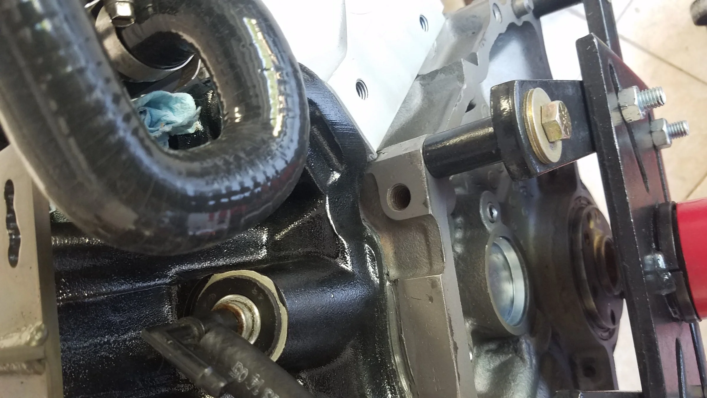

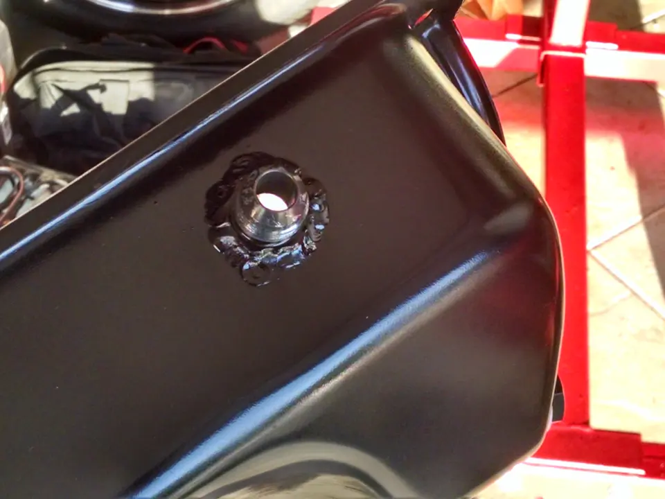

So I have not had time to update lately. We're looking at moving to Florida, So I've been working the problems out from the truck and, even though it's mine for a couple of months, picked up a go-to-work Accord. I did get my oil pan back from the welder. I'm trying to make this build look and function like I actually planned it.

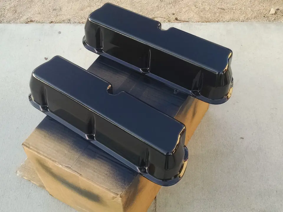

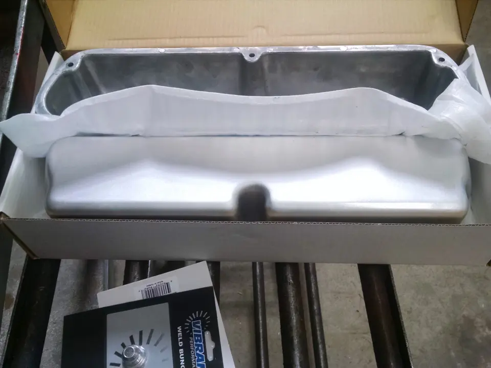

The cheap Summit polished covers received the wrinkle treatment. Not pictured but the 8an bulkheads are installed and I'm doing the garage search to find the screws for them. I checked the fridge and forgot about them after finding some good beer.

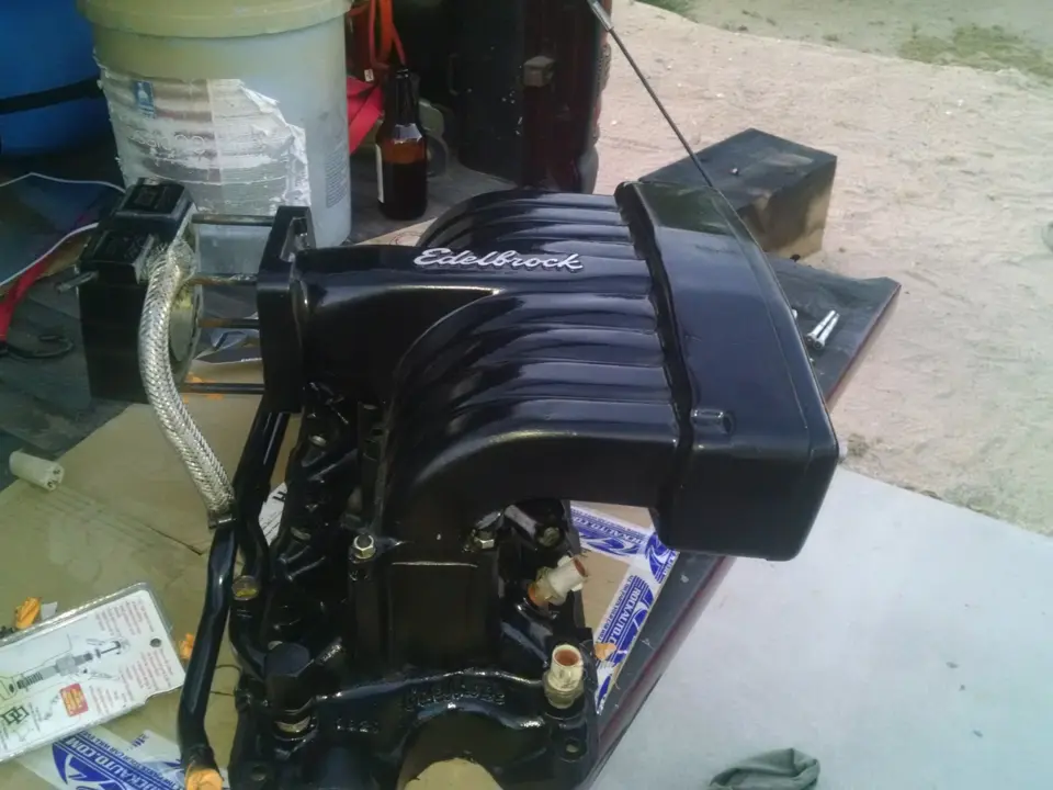

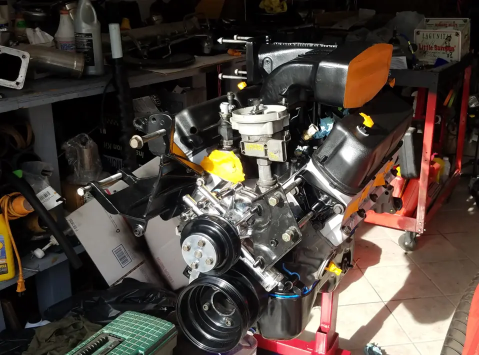

Well, I finally figured out my picture hanging problem, so here is the latest. Valve covers still need the baffle screws to check their clearance with the rocker girdles. Injectors need to be cleaned and I have not decided if I should send them out or just do the old 9 volt battery cleaning method. I still need to pull the pan off and clearance the pick-up. After Mike's story, it's worth the time.
Oh, the block is staying the Cast color. Just not enough time to strip her down and mask it off. I did find a problem, the old distributor has way too much slack. I'm debating on an MSD streetfire or billet piece. Any advice on if the $100 extra is worth it?

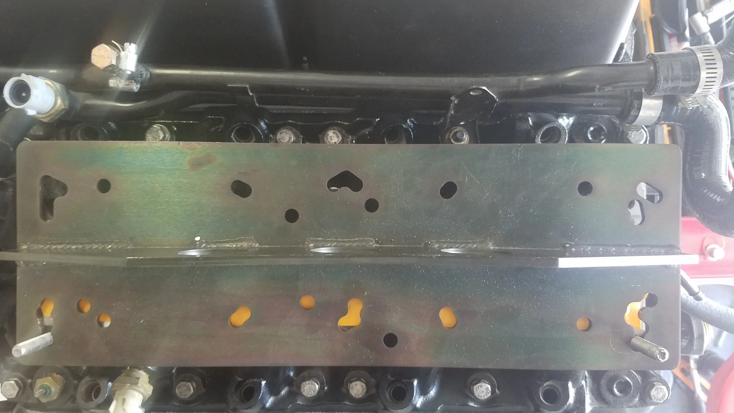

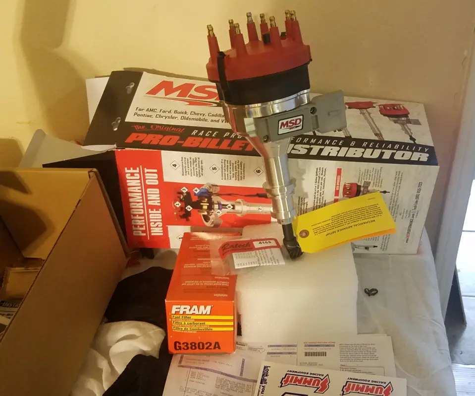

Well, came home to one of the boxes from our good folks at Summit. I received my lift plate, solid pinion spacers, fuel filter and distributor. I have to say the MSD piece is pretty, but seems to have slack in the side-to-side about like my stock piece. Oh well, its here and going to get used. Hopefully the new pinion bearings will show up soon. I've decided to swap the new set of gears I have vice using the used set. Hopefully that means a better pattern than I was able to pull from the used set.

Did have some difficulties with Summits lift plate. Seems someone welded the bracket on the wrong side.
As usual with Summit, they're taking care of it. Unfortunately it will be too late.

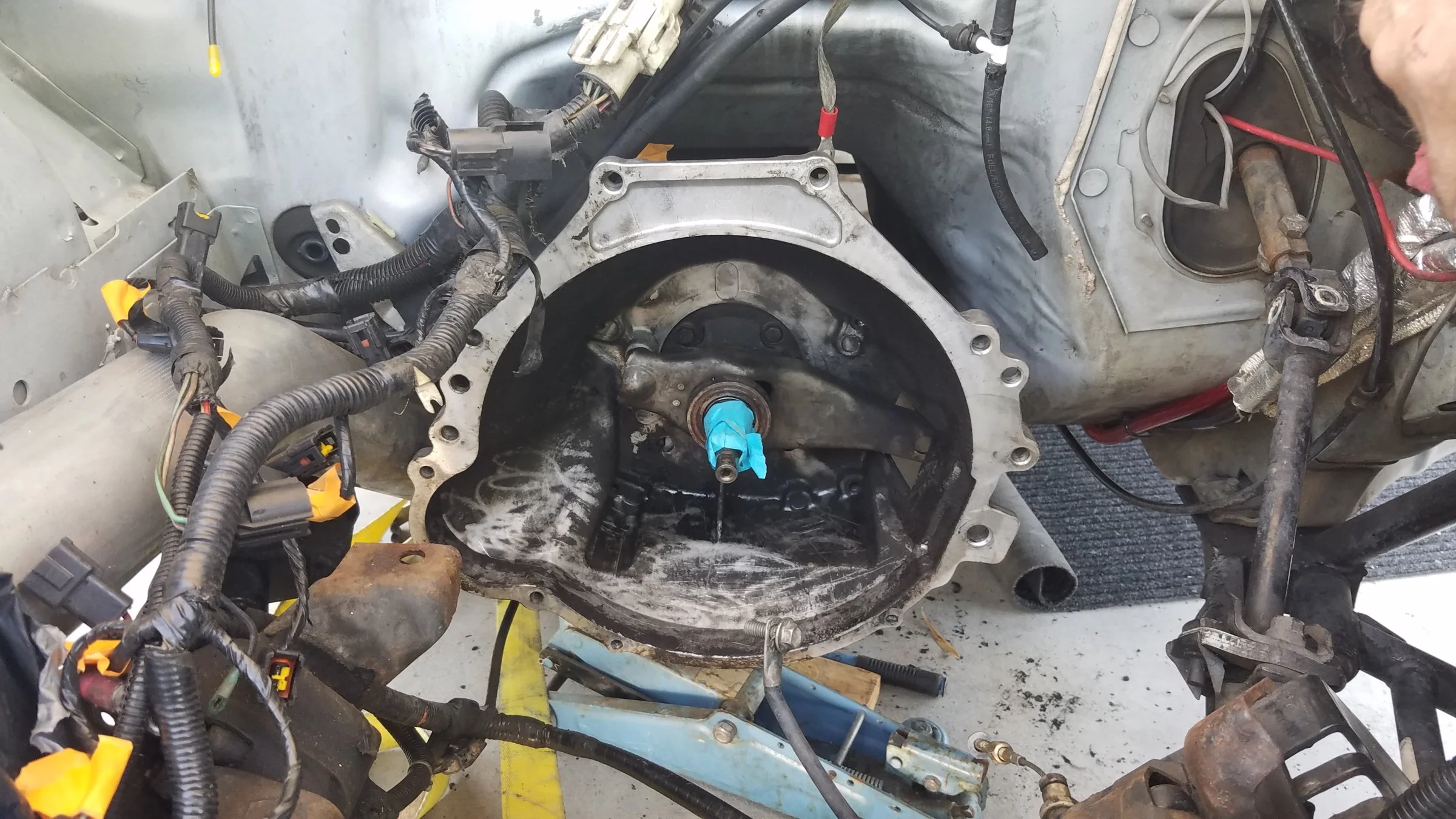

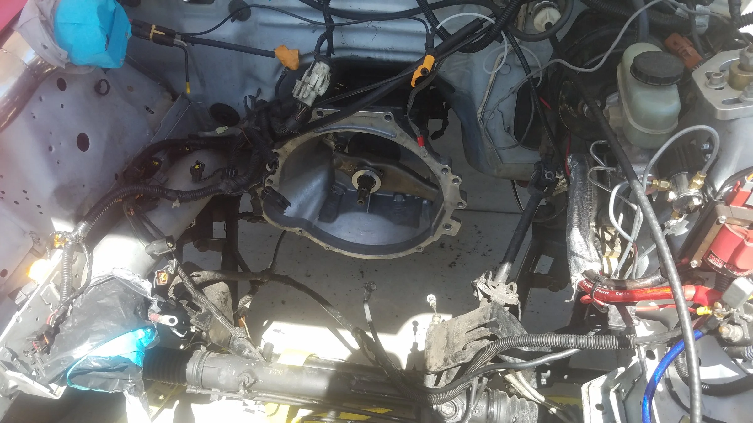

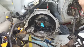

Another accomplishment, the bell housing had the two lowers stripped and caught the better portion of the rear main leakage.
Have to give my Father credit. He drilled, tapped and heli coiled all four holes.

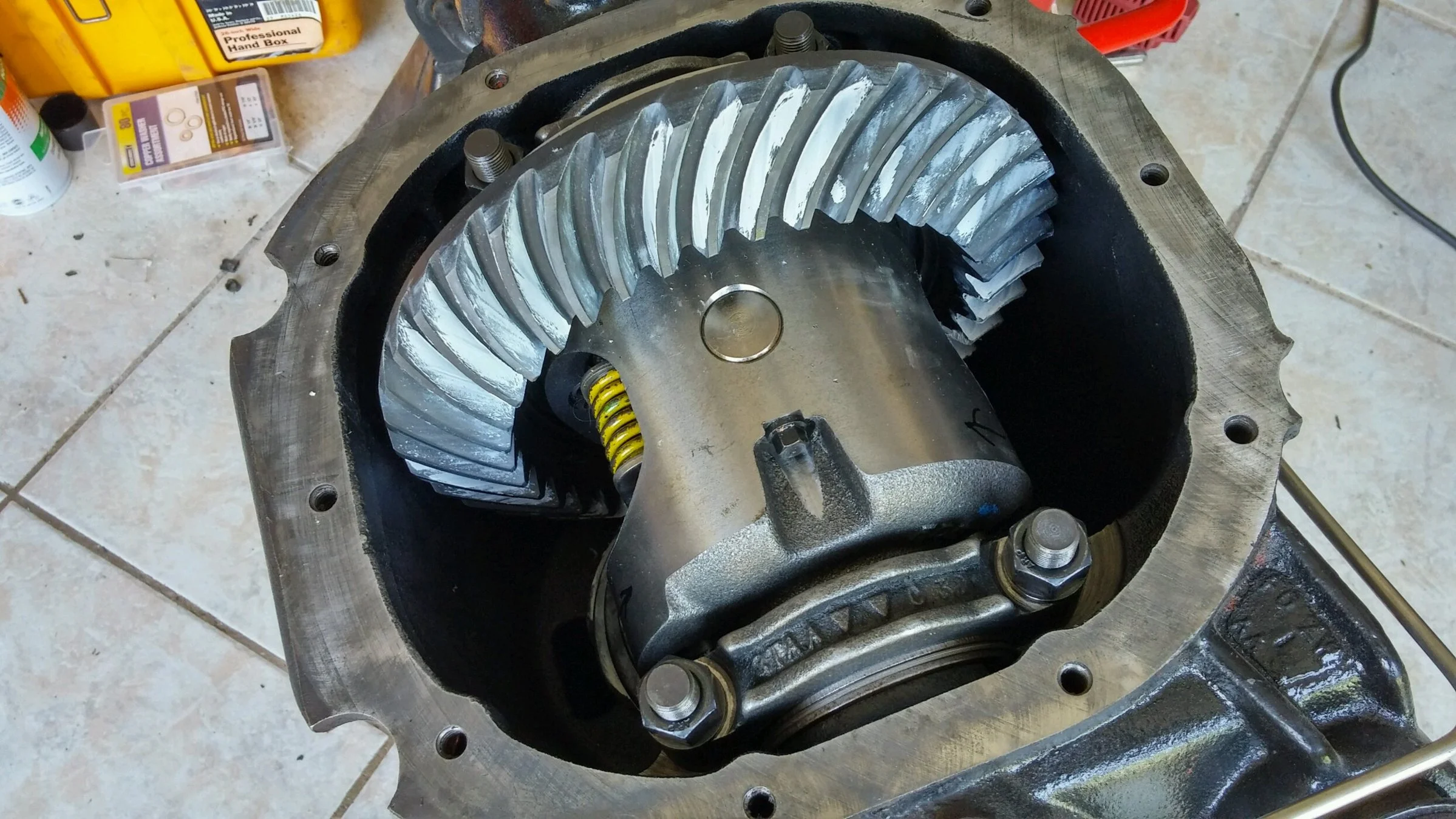

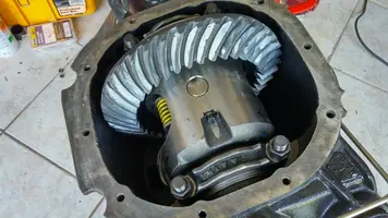

It's damn good having him around. He's been kicking my backside and making me get some done. Still trying to get to his level, but have a long ways to go. Setting up rhe 8.8 proved that. Thought we were ready to set the engine in, but yours truly couldn't find the the flywheel dowels. After a 2 hour boondoggle driving to four different stores, I found them in the old pressure plate. 20 years ago, the old man probably would have have scalped me for wasting time. Guess we've both calmed down. Anyway, motor should go in tomorrow. To all, Happy Memorial Day.
