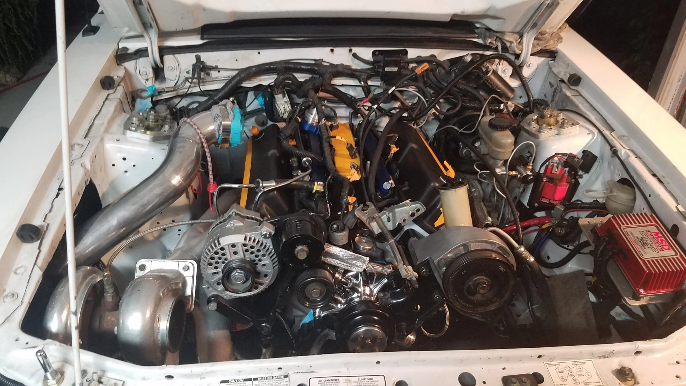

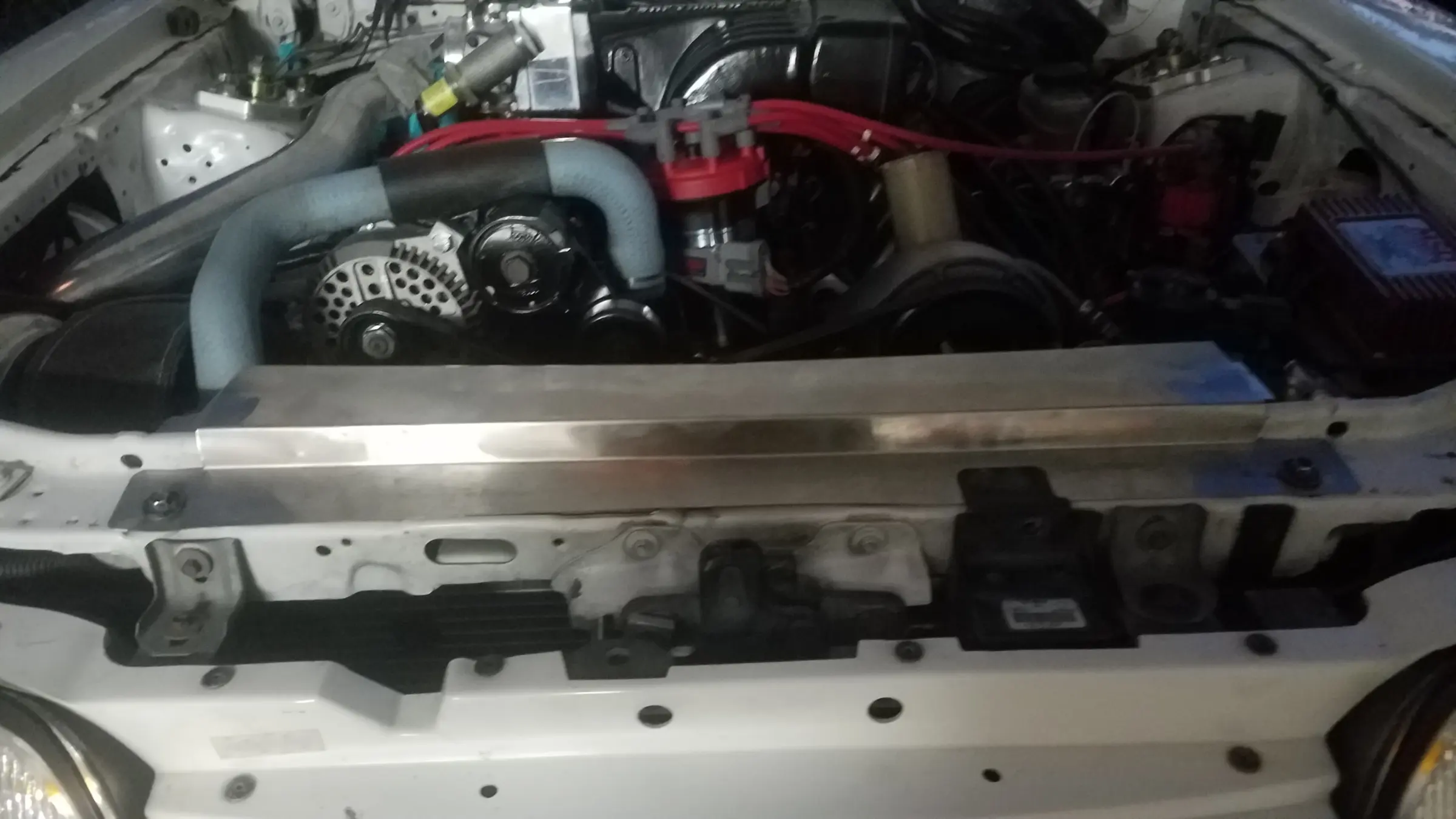

Oh, for todays progress.. The motors in. As usual..curse at it an hour, take a 15 minute break and boom...the tranny slides together.
Reactions: Boosted92LX and Davedacarpainter
Uhh RD,...I don't want to be the one to say this, but..........
You got a big assed hole in your fender apron.
If you ever decide to add another turbocharger,...put it next to the other one,..................you got room.
Oh yeah. Congrats on putting the engine in,....how did you do that w/ the lift plate drilled wrong?
Reactions: Davedacarpainter

@madmike1157 : Hole? That's weight reduction, tool storage and reliance on a die grinder after your air saw gives up the ghost. I've always intended to build a panel to cover it, but have been waiting for you to finish the Gila.

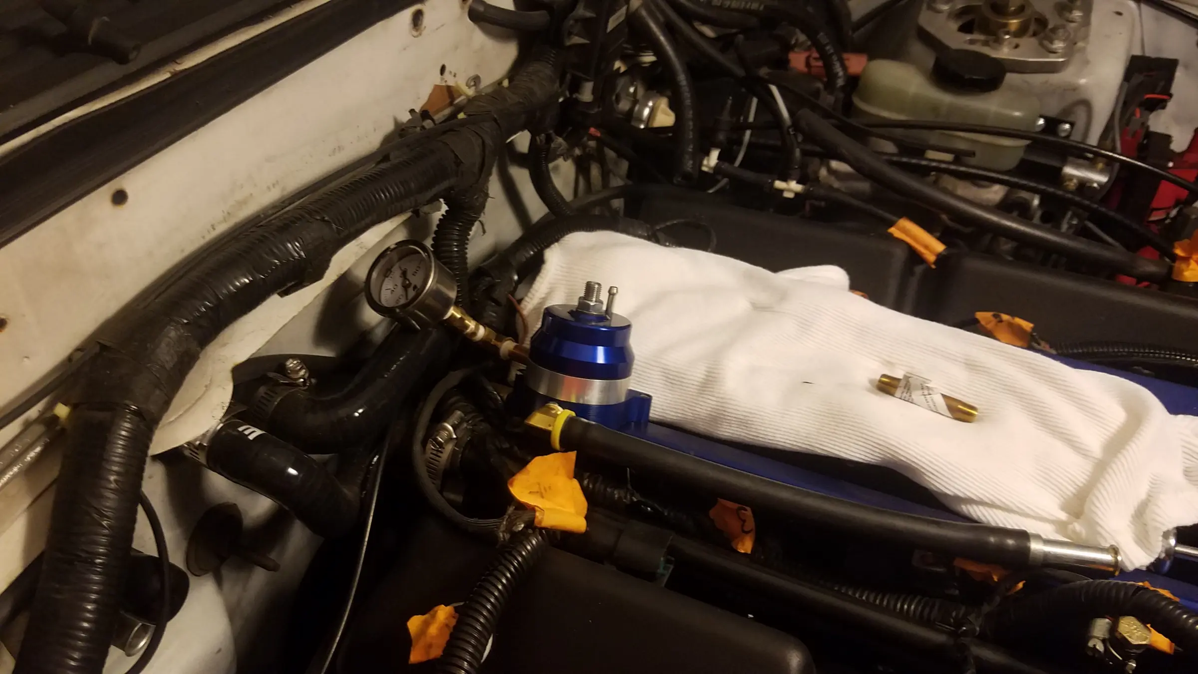

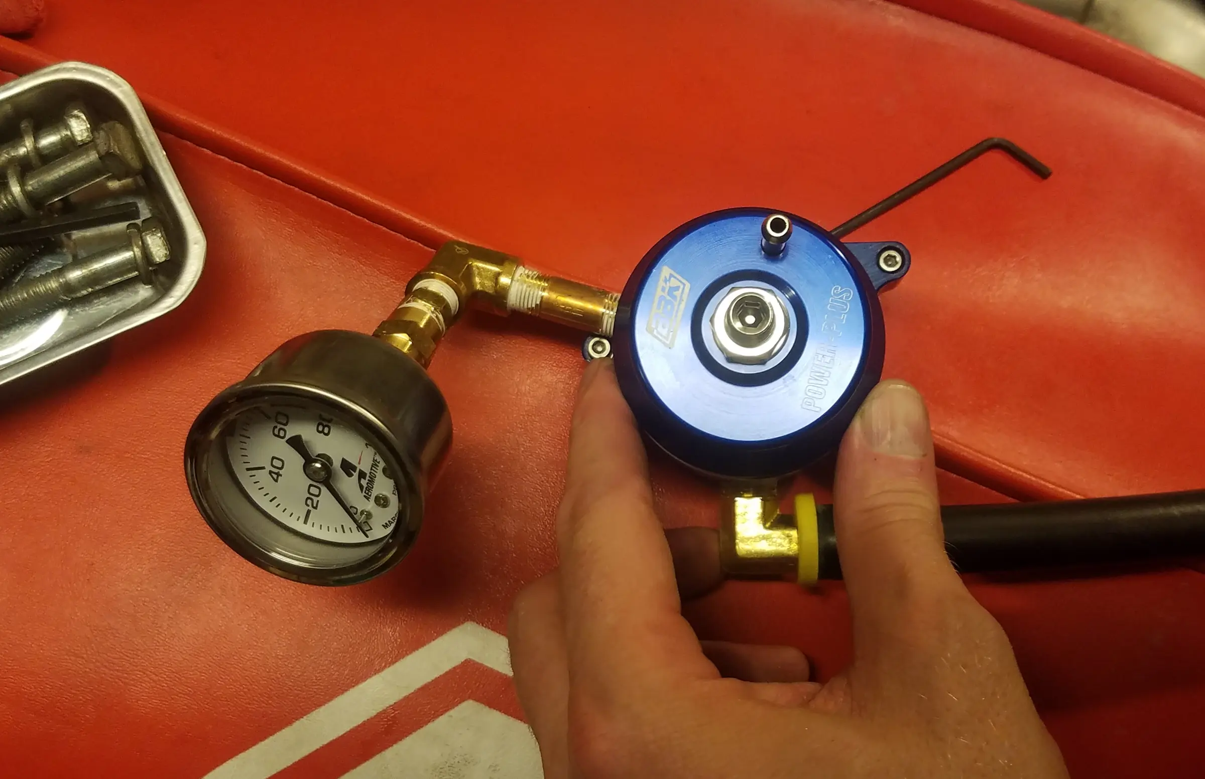

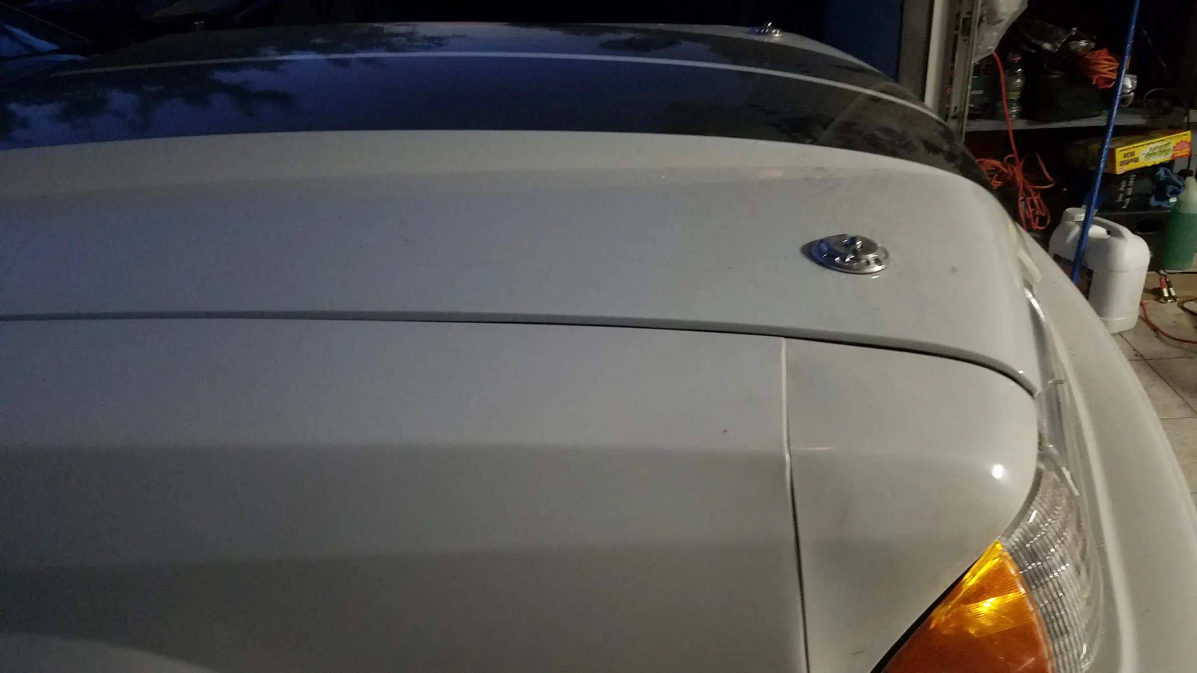

So for the latest update. BBK fuel rails leaking (another O,'ring fixed it), I need to do vacuum line ( some dumb A@@--me, broke them) and the friggin radiator mounts suck.
So I had a previous hold down, but ordered factory brackets and still have problems with them cresping the ledge of the core support. So I stopped with the LMR stockers, but have been beating the heck out of my aluminum hold-down, Nothing has worked and I still catch the Cervinis hood.
I might stop caring if it did not rub the hood's underside, but I'm just anal like that. Oh, and it causes alignment problems with the hood.
Between that and the weird hose angles of SVE's silicone coolant hoses, I've been trying like hell to get things worked on.
I did remove all the old fuel. It's a beer-drinking idea, but the Holley NA fuel pump helped a heck of a lot.
So lets talk start-up. Fuel pressure is at 39Lbs, plugs are gapped to 30 and my timing pointer was loose as heck. A bit nervous, but can't figure out a way to go dead-nuts TDC without removing the intake and valve cover.
What?....True TDC is found with a marker, some masking tape, a piston stop, a piece of clothes hanger wire, and enough room to be able to manually turn the engine via the crank bolt.
Errr.......Ahem.
Fashion a "pointer" out of the piece of coat hanger wire, bolt it onto something that wont move, and bend it so that it is pointing at a fairly accessible part of the balancer.
* it may be a good idea to remove all the plugs.
#1. Remove #1 plug.
#2. Using "finger on hole" method, bring piston to TDC.
#3. Turn engine backwards from there 1/4 turn by hand.
#4. Screw in piston stop. (this can be something you buy, or something you make. I made one out of an old anti fouling plug extension. Tapped the center of that dude, screwed in a long piece of all thread through the center, put a jamb nut on it, and done. All that junk found at either Autozones "Help" section, or Home depot.
#5. Turn engine forward slowly by hand, until the piston hits that stop.
#6. Now,.......clean off the balancer,...and put a 4" long piece of tape on the balancer in the area that you have your pointer pointing at. Place the tape so that the pointer is pointing in the middle of your tape.
#7. Mark the tape where the pointer is pointing to.
#8. Now spin the engine backwards, away from the stop until it contacts the stop again.
#9. Mark the tape.
Now all you gotta do is measure the distance between the markie-dudes, and divide that in half. Make a mark between the two marks on the tape, Zackly in the middle.
#10. Remove piston stop.
#11. Rotate engine until your pointer is pointing at the center mark. That is true TDC. Make adjustments to your timing marks to accommodate this, and you're good to go.
Reactions: ThinBlue502, A5literMan, Boosted92LX and 2 others

@madmike1157 : Frigging genious I say! I've got it aligned by the finger method, but had never thout about the piston stop being used as a constant. I've got one, so its on.

It hit 109 today, so I've picked up a whole lot of vacuum lines and plan to repair the old broken lines. I've bought some nylon line, but debated about what will seal it against the rubber line used to repair it. I bought Gorilla Glue, Shoe Goo and another product sold at Autozone. I think I'm going to test each and see what holds better. The factory lines (nylon) suck, but I have not been able to find proper replacements, so I'll seal them and zip tie them. I set the FP to 39 lbs, but have no idea where it was set on the pervious stock motor. I think it would be a best case to start there.
@Boosted92LX : any chance you remember where your fuel pressure was set initially?
I never checked what it was running on the stock fuel system, but I set it at 40 psi.

@Boosted92LX : Thanks, I think that is where I'll start. By the way, Congrats on the new horse, she's a beaut.
usually set them to 42 base on power adder cars.

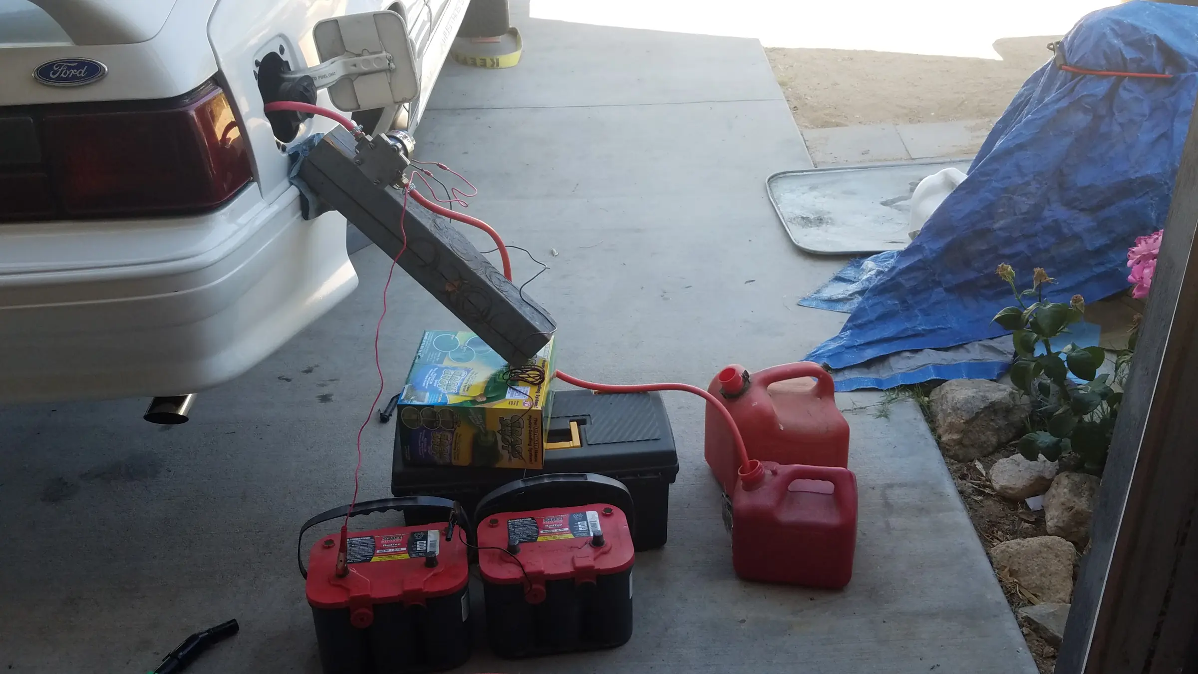

On another note, I realize I set the fuel pressure without the engine running. I let the pump build pressure, then set it. Will this cause problems on start-up?

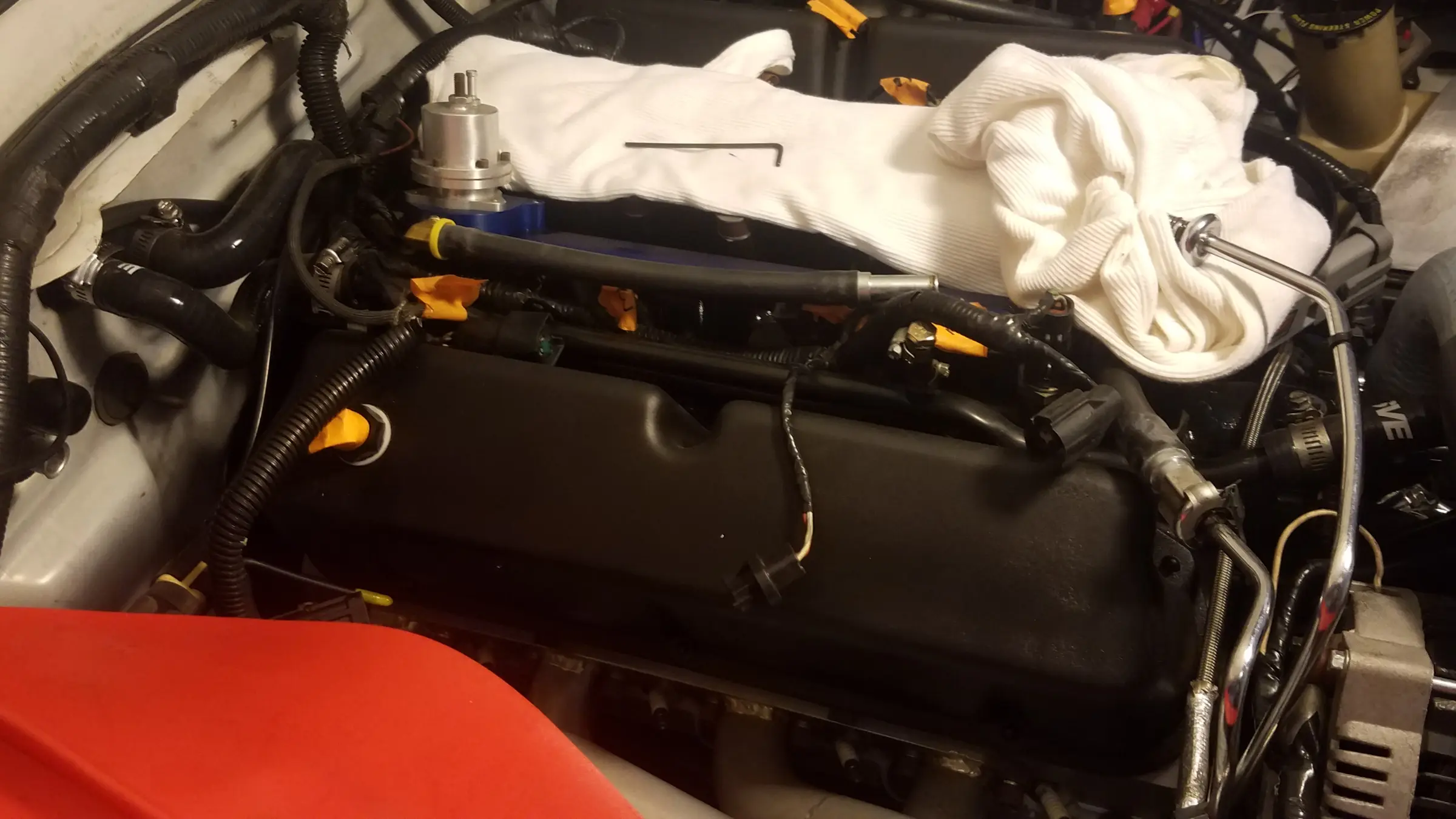

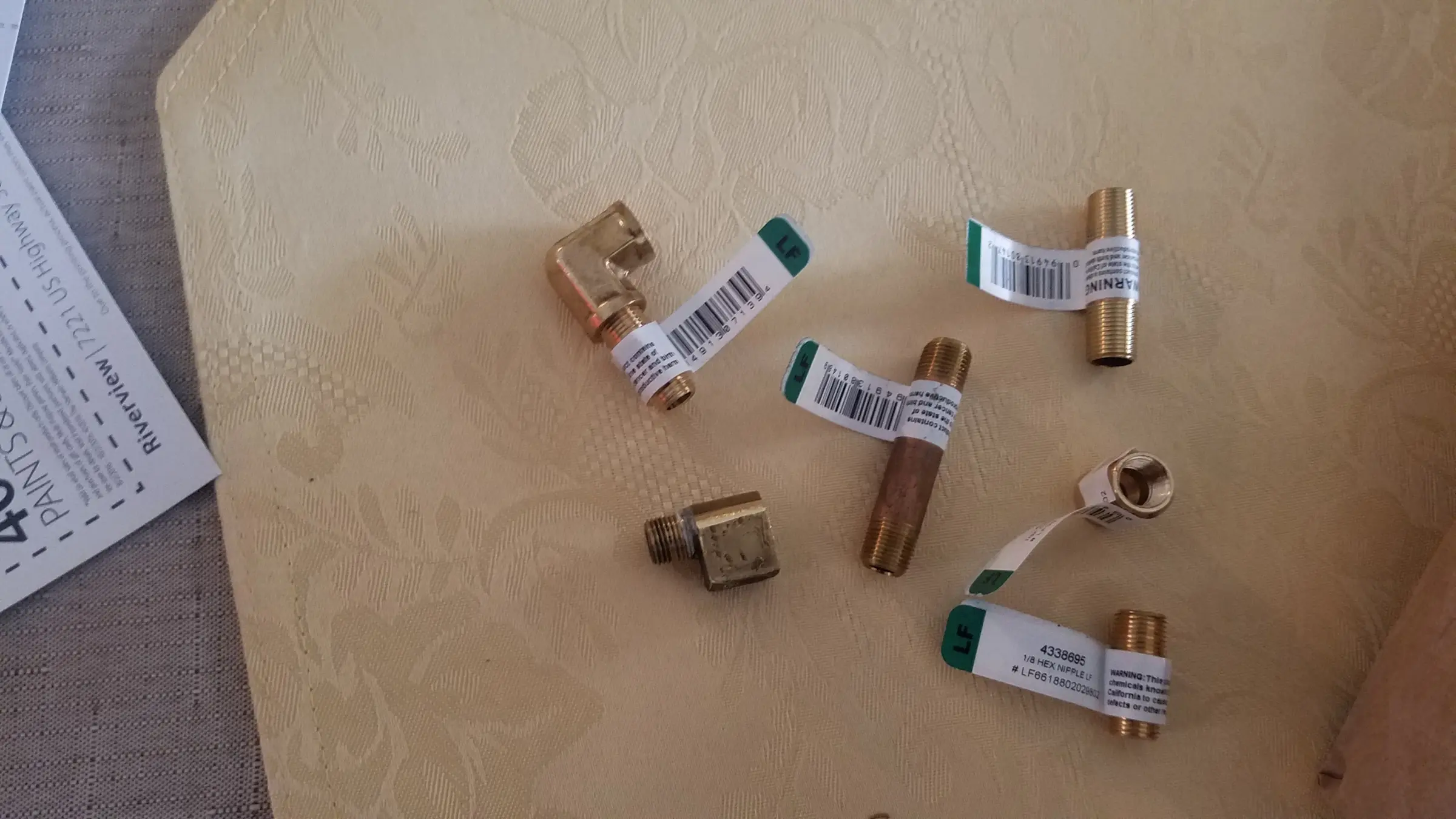

So I'm now a resident of rainy Florida. The Mustang got here and the overpaid shippers left it out in the rain. Yours truly, had some local folks help push it into the garage, Just a not, don't let guys with greasy hands push a white car anywhere. So after weeks, my garage has enough room to actually walk (partially) around the car. Yup, place happy face emoji about here. yea. At this point I have to get TDC lined up on my pointer, finish my vacuum lines and get my fuel system straight.
The dog gone BBK rails pushed the stock fuel lines outward. If it was not turbo, it probably would not be a problem. Unfortunately, this places the lines against my turbo manifold and puts my (*eventually leaking) aeromotive fuel pressure thingy right over the manifold. No Bueno.
So, I started the two step forward process of fixing it. Who knew Pep Boys had good stuff. I actually bought a BBK fuel pressure regulator that has a port for a pressure gauge. Who knew that (after mounting the thing) the gauge will not sit in a location where you can see if it's screwed directly in? Add a 90 degree fitting.....and you can't screw the gauge in or the regulator base into the rail. AWESOME! So it gave me a chance to find what True Value had to offer (props to the Value).
Like most of us, I just bought a bunch of fittings to ensure I don't have to go back. Who knows, I might be able to make artistic stuff out of the extra?
So, I'm like a brass fitting ninja now that I have a ton of "medium" to work with. Ok, a couple of intermediates, a 90 and a coupler, and now we have art (and a couple more laces for fuel to escape toward hot objects).
So, I'm awaiting my award while mounting this monster and.....boom....it look like I will avoid the hundred other obstructions by the manifold. AWESOME...right? So a couple of my brain cells scream "tighten it a little". Yup, it leans against the heater core hoses when tight. I walk away with a smile. Later, I think about engine rotation and realize that it will turn the thing in a certain direction. Go ahead and guess which way?
