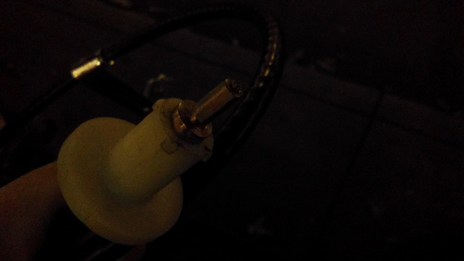

Pull the rubber part off and cut the three tabs flat with a razor
Looking good..the nubs gotta be completely gone..flat

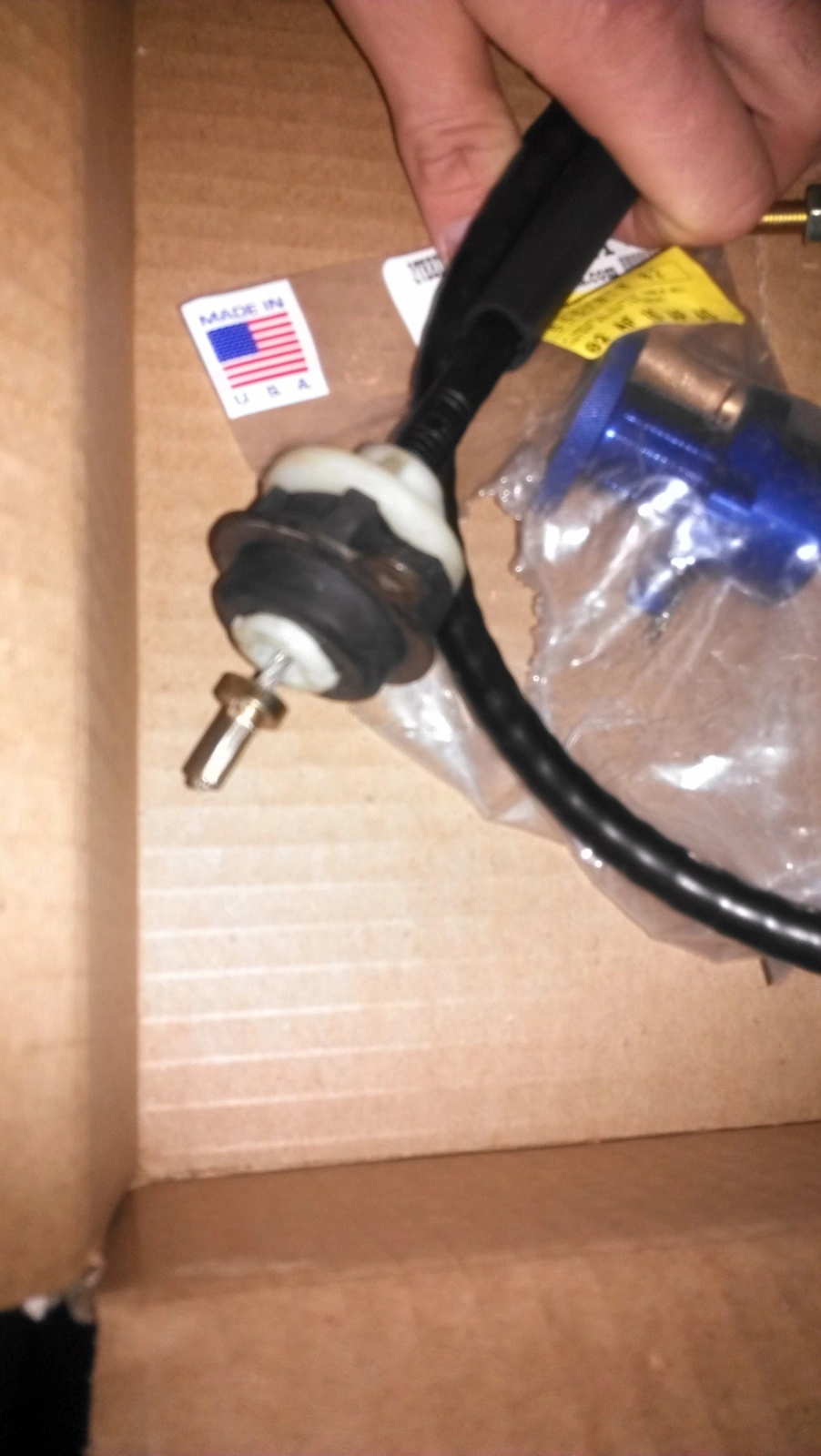

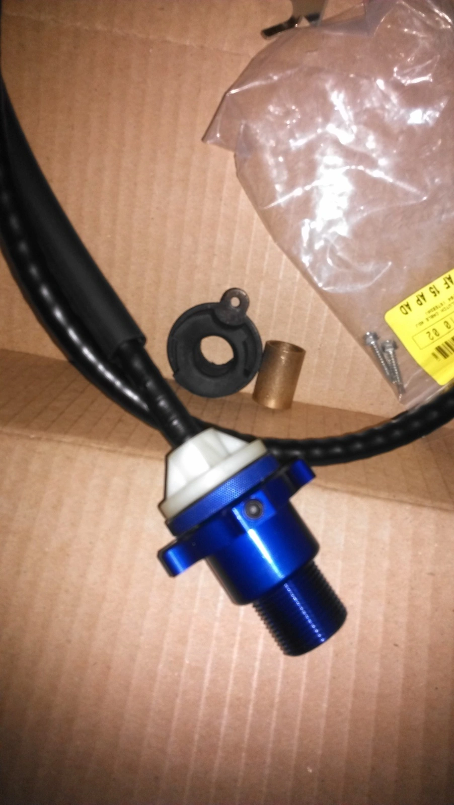

I have the same setup as you do. There was some rework to be done to the quadrant end of the cable where it fit the Steeda adjuster. Mine works very nicely, and yours should too.So went by the parts store and picked up the Steeda one, it's pretty nice and has an easy self locking screw. The instructions in the box are terrible though. I also purchased the frpp adjustable cable, which is what i had for 8yrs. So am i gonna have to mod this frpp cable to install this sweet ass adjuster?? How do i perform this, anyone got pics cause I'm not sure what to do?? BTW i already have the Ford Racing single hook quadrant installed from before.
Did you put any oil in the cable or just let the teflon coating do it's thing??I have the same setup as you do. There was some rework to be done to the quadrant end of the cable where it fit the Steeda adjuster. Mine works very nicely, and yours should too.
