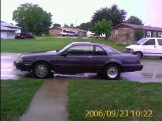

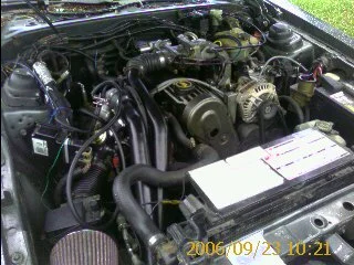

well I got it running yesterday and drove it to work. I fired it up and with my trusty fire extinguisher at my side headed to the gas station for some 93 octane. well the good news is I didn't need the fire extinguisher, but was less than happy with the way she rode. I had an army of bugs and isues. the auto ride is giving me fits it rides like there are no springs and just bounces like a gocart. and don't get me started on the way it runs. now I need to mention that it ate about 3 quarts of oil when the od turbo went out so it still may just be nasty. but I have already replaced the o2 senserand plugs and ran a whole bottle of see foam through the intake. it also doesn't have the exast hooked up yet. she has a bad miss and no balls and is pretty much useless after 2nd gear. this may have something to do with the exast, I realy don't know. I still have a lot of work to do.

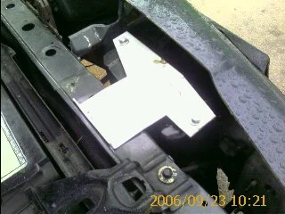

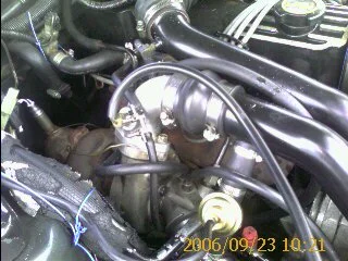

as promiced here are some pics of the ford motorsport fmic. it went in real easy and only needed alittle modification due to the fact that it is ment for a pre 86 t-bird I had to trim the header panal but it is all out of site. man I can't wait till it runs right. it already tried to spool up on me but with how ruff its running I let out as fast as I could. ill be putting on my tester at work today to see if its throughing any codes. wish me luck.
