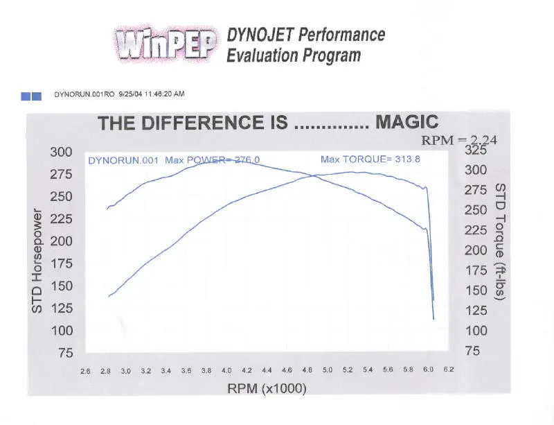

I just had my car dynoed for the first time. Mods are in my sig but, in general, I have an E cam with GT40 iron heads and cobra intake. I bought the heads used from Stangnet a few years ago and was told at the time they were ported.
276 rwhp/313.8 ft-lbs torque
The A/f is rich. It fluctuated around 11.5. This could be because I run the ACT sensor in the fenderwell. I have the PIH kit with A9L computer. The cobra lower doesn't have the tap in the #1 lower intake for the ACT sensor.

Wow those are nice numbers for your set up. I may need to buy my brother's iron GT-40 heads and his E303 cam.
Are you running stock injectors? Only reason I ask is because I just bought a PRo M MAF calibrated for 19's and I wanted to know how much power the stock injectors can support. thanks,

I have 24lbers with a 76 C&L MAF, 190 lph fuel pump and afpr which I guess I'll start playing with to lean it out a little.

Those are good numbers....I have damn near the same set-up...I opted to stay with 19 vs swapping 24s...Makes me think I left some ponies on the table??? your like 14 Hp more than I....Oh well...add them to the Winter list... :D at the time I didn't feel like sending my Pro 77 back for recal...

Those numbers are VERY respectable for iron heads and an E cam. Sounds like the combo is a good match. You can always try a Pro M Optimizer to lean out the mixture.
