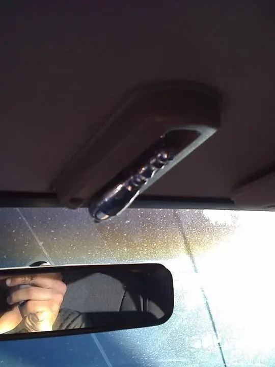

First post here basically even though ive been registered a while. Ive been looking for a 5.0 a while and the search has been long and still going on. However the last one i looked at had this handle on the headliner. What the hell is it for? I dont remember seeing it on the other ones ive looked at and it confuses me. Hey it might have been there on the other cars, but i just noticed it now.
THoughst? It almost looks like a sunroof handle, but well, theres no sunroof.
Yup, flip it down from the front and it's a map light you can aim.
However, more often than not, the contacts inside have oxidized over to the point where electrical current does not flow...and it will not work.
It can be fixed, but the map light needs to be removed from the car and disassembled and the contacts cleaned with sandpaper
