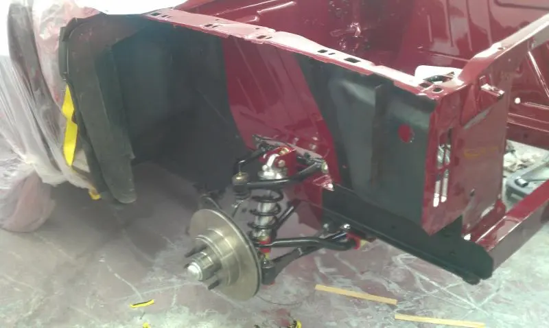

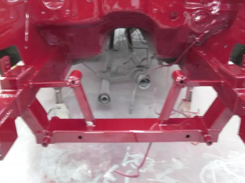

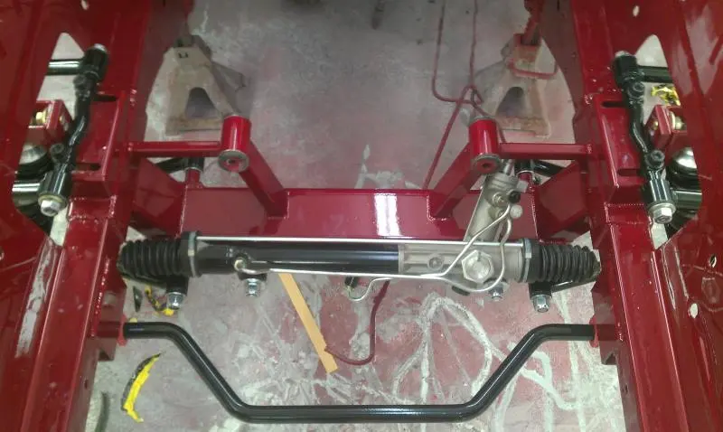

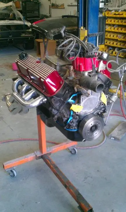

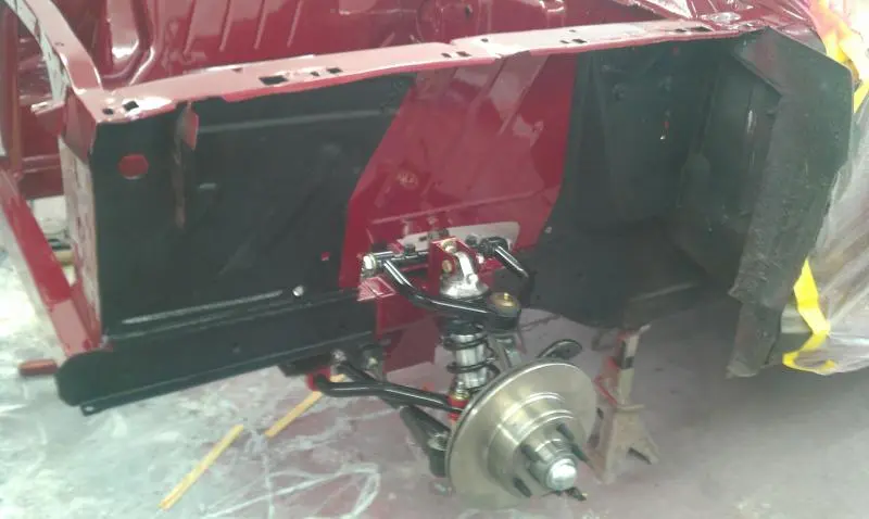

hey guys, figured i'd share this with you all. We are doing some work on a 66 mustang for a customer; Rod & Customs K member/mustang II coil over front end, rack and pinion power steering, power brakes/front disc, rebuilt the engine, new exhaust, Global West subframe connectors, 9" rear, new gt350 hood with redline hood supports, all new brake lines, new fuel line, new clutch equalizer bar, H4 headlights. The engine isn't anything crazy: 74 block, 306, b cam, roller conversion using link lifters, fox BBK long tubes, fox BBK H-pipe, Spintech super pro street mufflers. started up first try and purrs like a raped kitten, lol.
here is the video:
