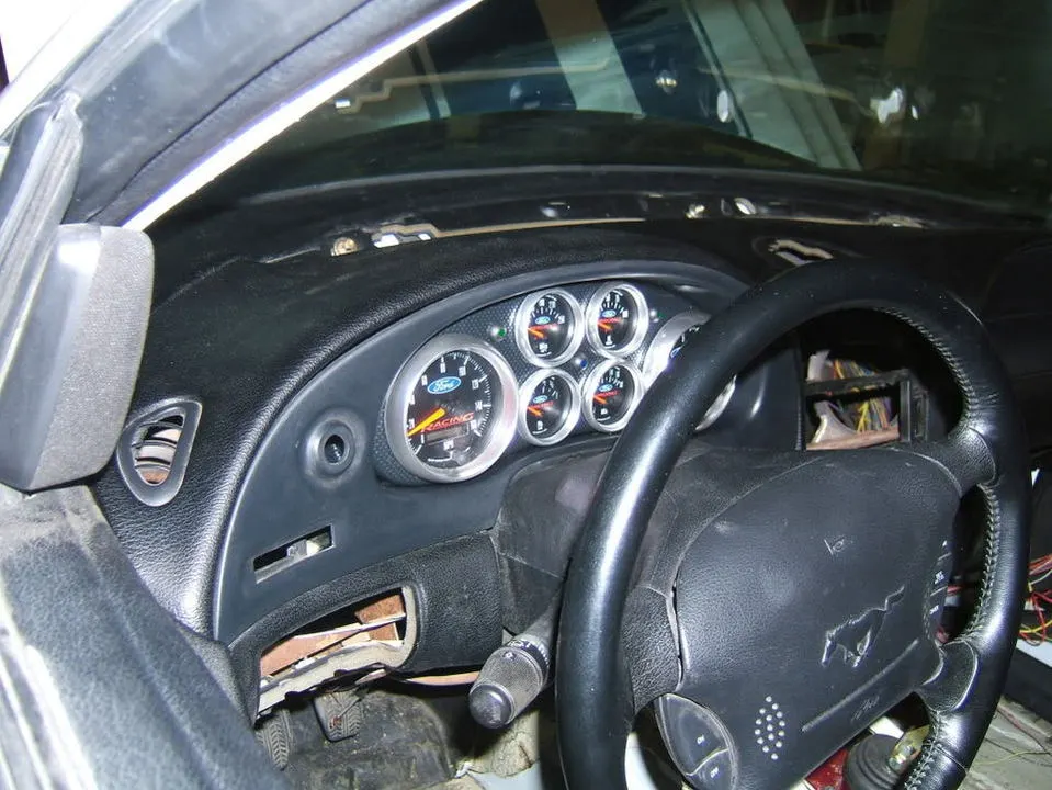

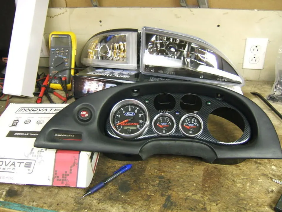

I didn't run into problems because I just bought the parts. Custom fab would not be difficult though. The way this piece fits is it slides into the bezel pice and sits against a structural piece of the dash behind it. It is in there solid but there is no hardware. If I was doing a sheet metal one I would say you would have to cement it into the plastic piece. I was planning on doing this but this looked good and I already had my hands full.
They have the option to have gauges included but I had my eyes on different ones. Just look at the company florida 5.0. I also got a ac bezel delete. the whole center piece vents/radio/ac are all just a flat panel now with a few switchs and a 7" touch screen. They have some nice stuff.
To be a street monster. The car is built to be a road race car more than anything. I will be using it to get more attention to my small custom automotive electronics/control systems business. Hence the bling bling gauges, uniques igntion setup, and control units.
