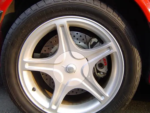

he means you have to do something like this
