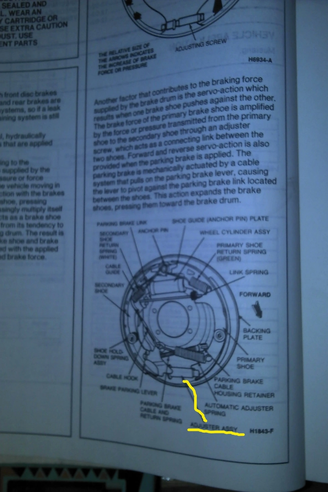

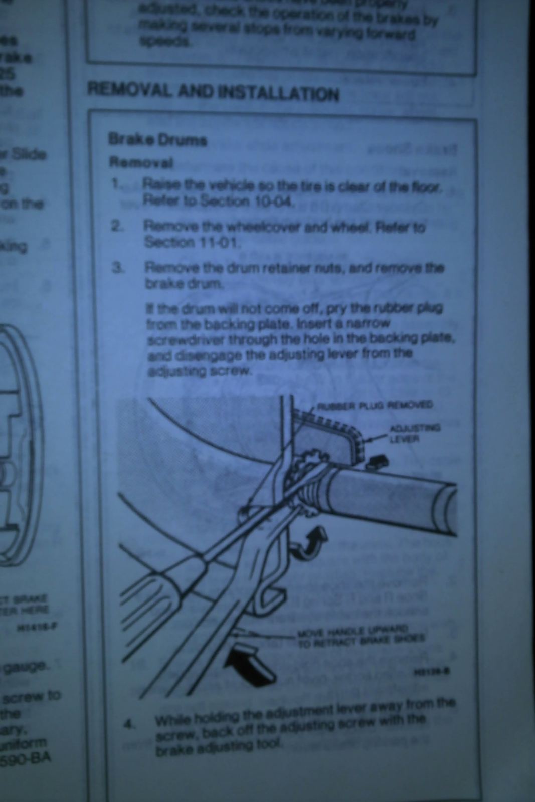

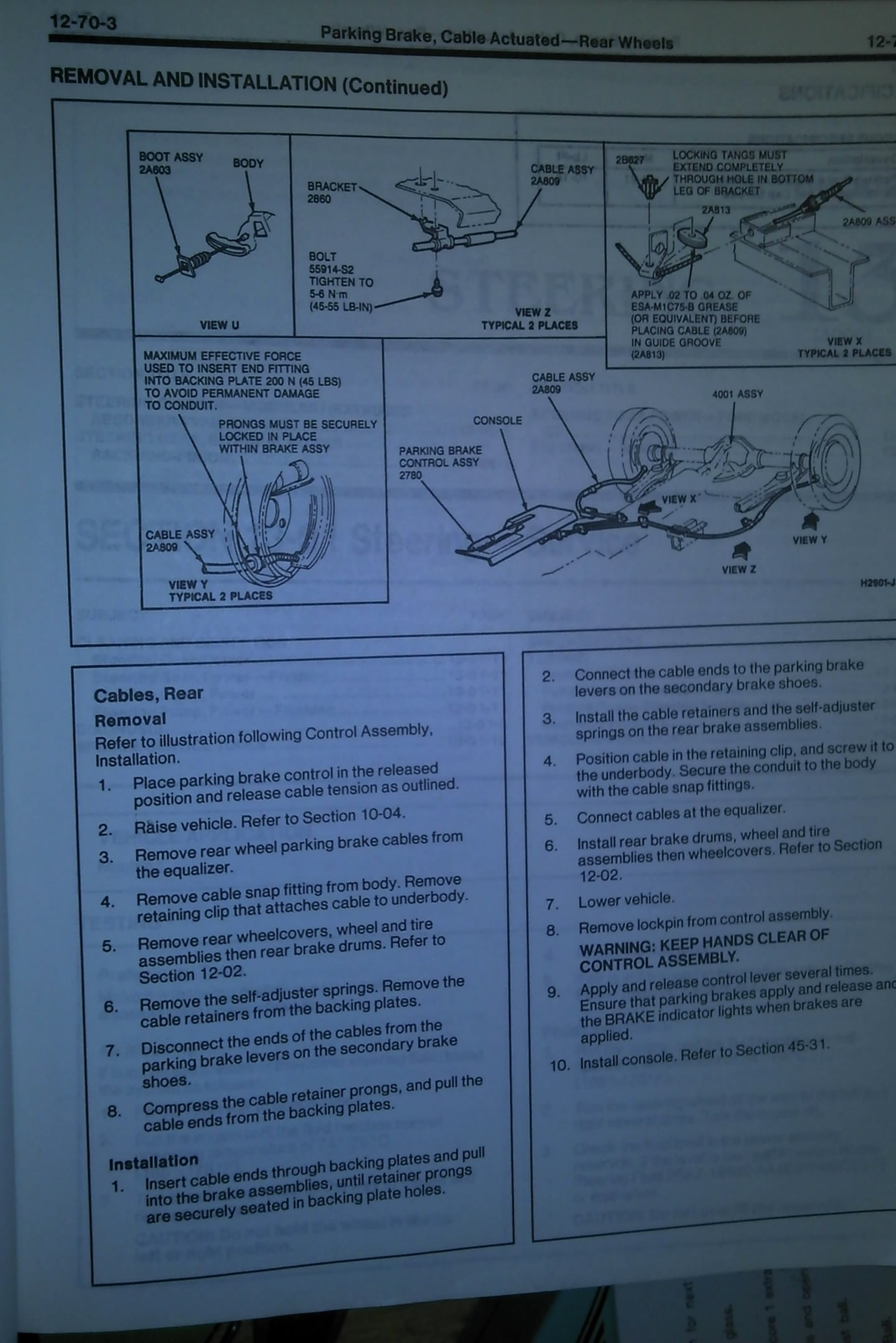

When you take the drum off, it is like a screw with two ends on it that are notched, and there is an access hole on the inside of the back plate, let me take a look at one of my service manuals and see if I can get a picture of a diagram for you.
This is your brake adjuster, and if you can't get the drums off because of the brakes holding them then:

Try loosening the adjuster from the backplate, as per the page that I posted earlier, and that will relieve the pressure from the shoes on the drum, and it should come off easier. It sounds like that side for whatever reason got over tensioned and is causing it to hang up. You can loosen the tensioner from the back plate with two flathead screwdrivers through the little rubber plug on the backplate. I've had to deal with that before myself. One screwdriver you need to push the ratchet arm back off of the tensioner, and the other to turn the tensioner.
