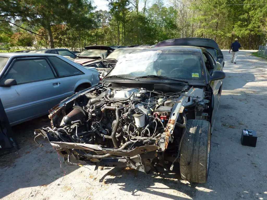

Bought a '96 with mild front end damage. The theft light flashes quite often. Drove car for the first time the other day and turned engine off, opened door, hit door lock button and walked away. After some time (a min to a few min maybe) the alarm started going off. I have no remote and only one key so I had to disconnect the battery (maybe inserting key into ignition would have worked but did not think of that).
So, I've done some searching but am still not sure what may be the best way to deal with this issue. I know I need more than one key and know you need two functional keys to add one so I guess I have to reprogram a bunch of new keys (I found this: Program a new Ford PATS Key)
What about the flashing theft light and alarm?
WOW :eek:
