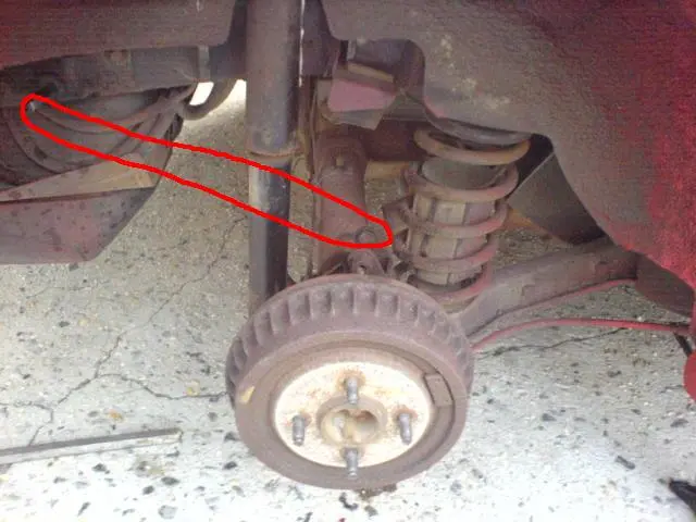

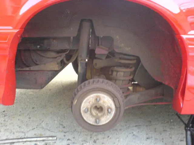

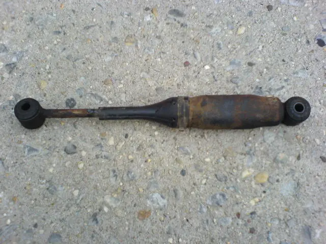

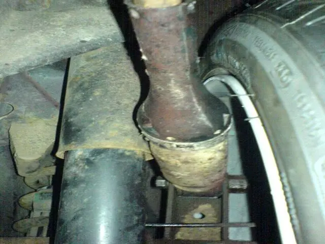

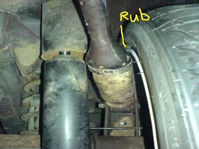

Almost forgot about this thread....I flipped them with my friend and the process was pretty straight forward, just make sure you have alot of WD40, it took alot of pulling and pushing to get one of those bolts out, but now that they flipped I have enough room. i took before and after pics to help anyone who needs to know what this does to help your rubbing issues, ill post soon
Here are some pics, maybe this can help others
Wheel well with quad shock removed
Where it used to be
While the car was on the jack and the shock is flipped already you can see it still touching
The actual quad shock
After the car is lowered off the jack you can see the ammount of clearance gained
Thanks for everyones help before I attempted this
