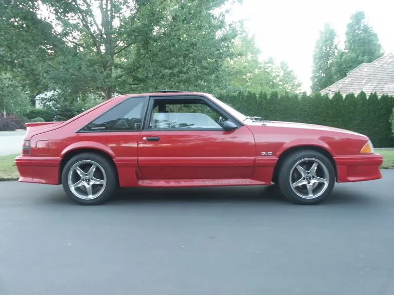

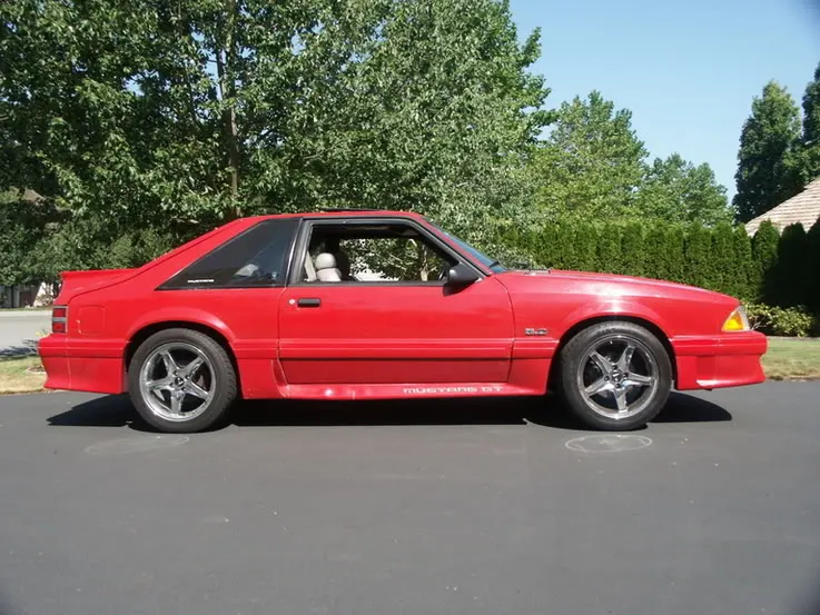

I'm happy with my B springs - here's a before and after shot - also did Bilsteins all around, and MM LCAs and Steeda UCAs at the same time. It has a slight rake to it, but pretty mild. The drop wasn't that much - I wasn't going for the slammed look, and didn't want to have to get CC plates - the alignment after I did it all was fine with just the stock CC plates. Any lower, and I would have needed aftermarket ones. Also didn't want to have more rubbing issues than I already have by going too low, plus didn't want to scrape the bottom of the car everytime I went over a speed bump. Also did new poly isolators all around as well - that will affect the drop a little as well, until things settle in a little.
