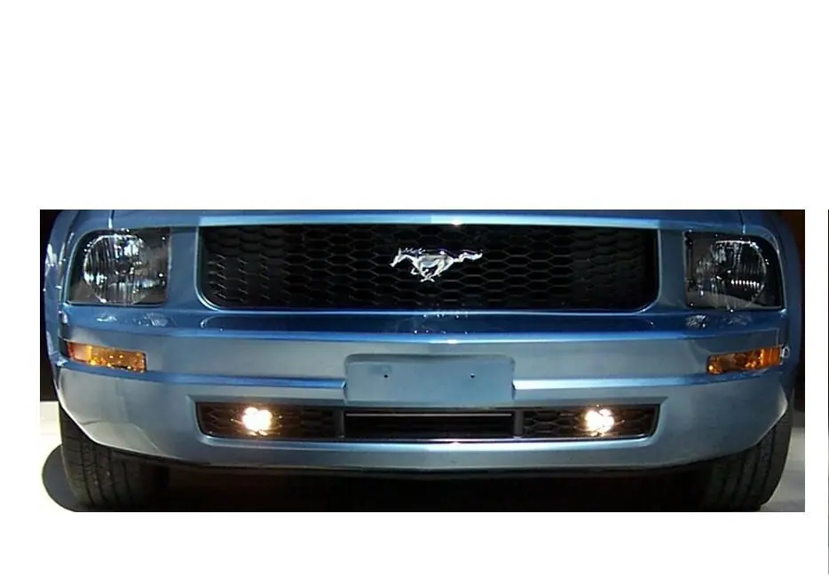

For those who have put fogs in the lower grille, where and how did you mount them? I had a set of square lights to mount behind the lower grille but I couldn't find a way to mount them so I took them back. Several months later, now I want to try it again. Thanks
I found a pic of where I want the fogs but I still need help trying to mount them.

Hey that looks pretty good. Might have to think about doing that myself. If you come up with something let us know. I haven't looked inside the lower bumper so I don't have any idea if you can mount them.
if you had pics of the lamps you wanted to use, i could help with fabrication tips.
without seeing pics, it is hard to guide you in the proper direction.

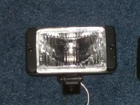

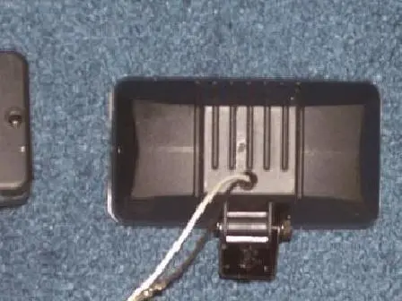

Bigcat, i thought this post was dead so I haven't been keeping up. I got some pics of the lights, I'm just having trouble resizing them. They are APC Road Vision driving lights 3"x5" (505010c). They are sold at Advance Auto, Autozone and I think Wal-Mart. Thanks for the help.

are you planning on mounting them behind the bumper inserts? if so, the easiest thing to do is this. take out the inserts. make yourself a little bracket, rectangular in shape. screw the bracket to the top portion of the bumper cover, with the bracket on the topside of the bumper. the insert will cover the screw. think of it like this: bracket, bumper, insert (from top most down). the bracket will stick out from the rear of the bumper, mount the foglamp to the bracket.
very simple. i have not looked at the bumper itself to be 100% sure this will work, but it should. i will look at it later today to be 100%.
also, if you need pics of what i am trying to say, i will try to make some for you.
