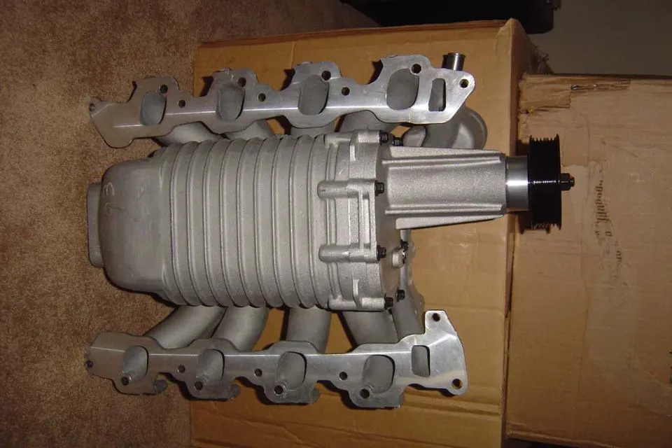

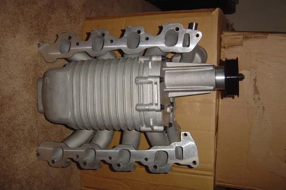

I guess I'm doing alright then with my FRP eaton at 336 RWHP at 6psi. BTW can anyone tell me for sure if I have a M90 or M112. The guys at modular depot swears it's a M112 due to the size and some manufacturers says it's definitely an M90? BTW, I will be upgrading to a 9lb pulley since I'm now running the snow meth injection kit. I will have it retuned also, should I be ok with this setup?

Your FRPP kit utilizes an M112......the only Eaton based M90 kits for the modular were made by Saleen and AED. The sure fire givaway is the giant pulley in the front. The M90's use a much smaller pulley (3" for 6psi approximatley) to make those same boost numbers. You making 336rwhp at only 6psi makes sense, considering that the M112 is slightly larger than the KB 1.7L.
