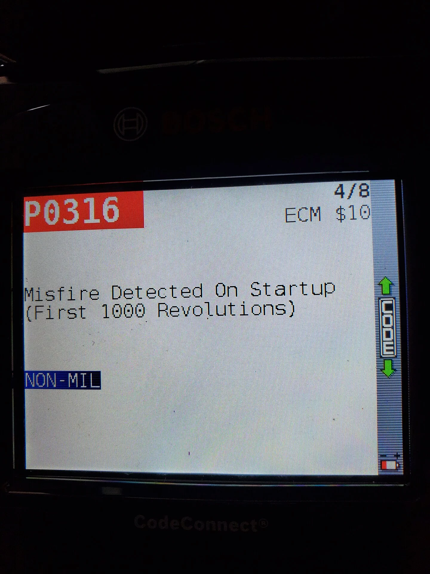

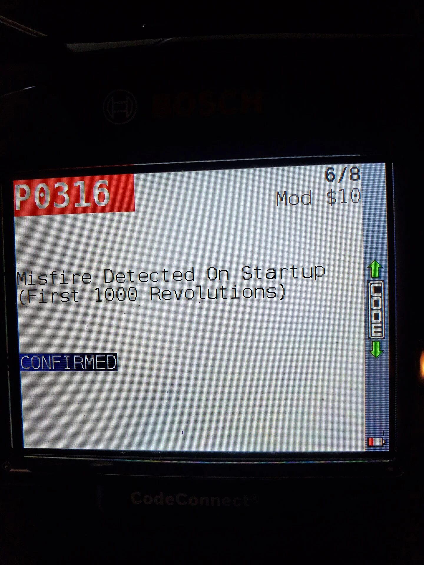

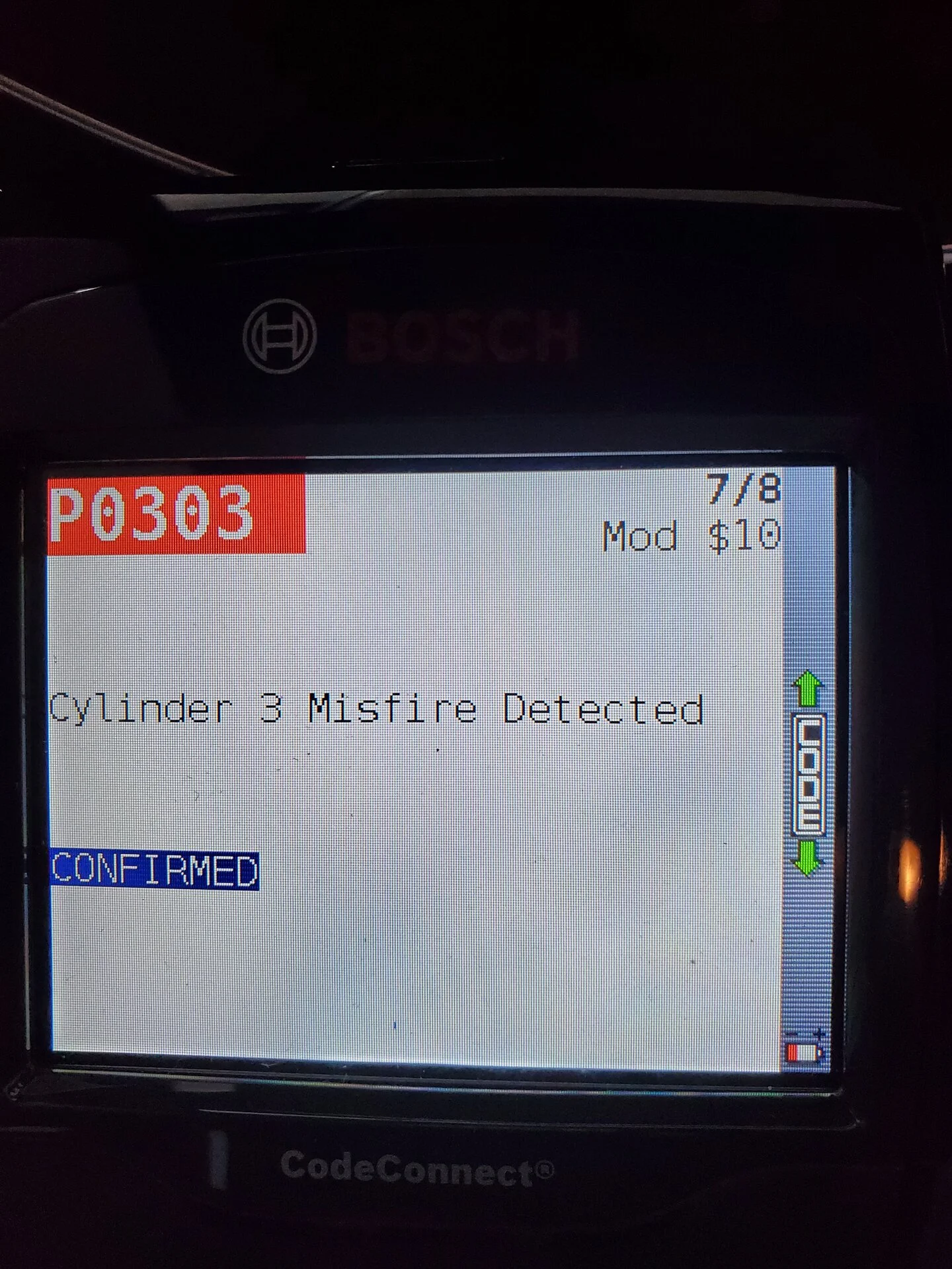

I concur with the previous post above. Purchasing a really good scanning tool is the first step. I personally bought a Bosch scanning tool that has helped me a lot with my vehicles and my family's cars as well. I have seen P0316 and P0303 before with my 2004 Ford Mustang 3.9L V6 automatic. It turned out to be what I believe old stale gasoline and the fact that the car wasn't moved for roughly 1YR except from one side of the street to the other (to avoid street sweeper ticket). I've attached the pictures of when I had the P0316 and P0303 OBD2 error codes. They eventually went away after filling up the gas tank once with Premium gasoline and using a fuel injection cleaner in the full tank of gas. I have a thread/post myself regarding an oil or fluid leak that I'm diagnosing on my 2004 Ford Mustang 3.9L V6 automatic if you want to check it out, comment, post or have suggestions. Thanks.
