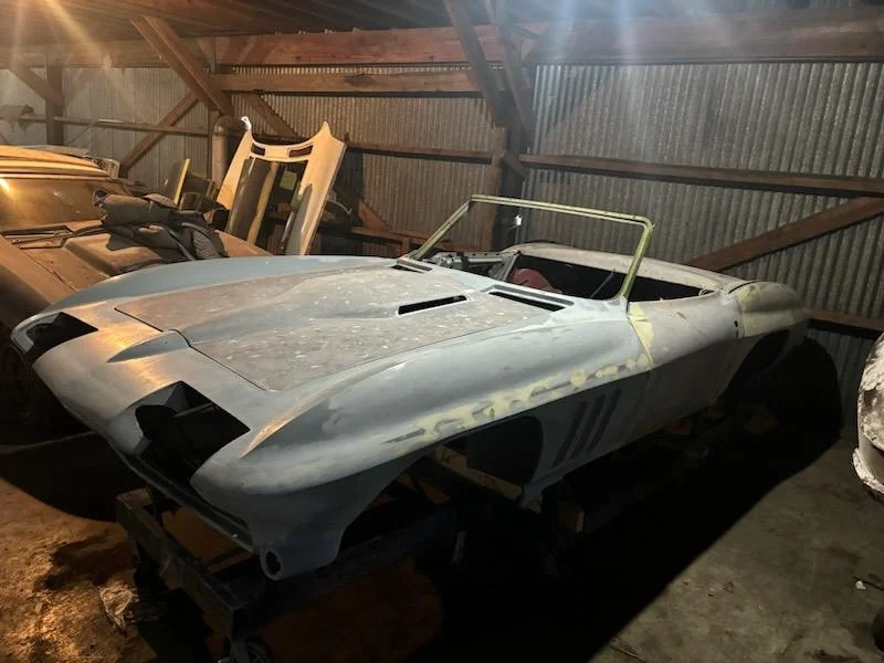

I have the correct hood on my new project for a BB, but they are way too expensive... I did see some guy talk about using a 454 instead of a more expensive 396 or 427.. Prices on the BBC stuff is crazy..

On accident I ended up with another 396 - that is the right suffix code for a full size 65-66 belair
.030 over / scat rod / steel gm crank
063 heads with bigger valves all fresh
All arp hardware
Edelbrock 2-0 intake
Roller rockers
.581/585 240/246 110lsa comp cam
Should run decent for what it is behind the 3000 stall and 4l80e
