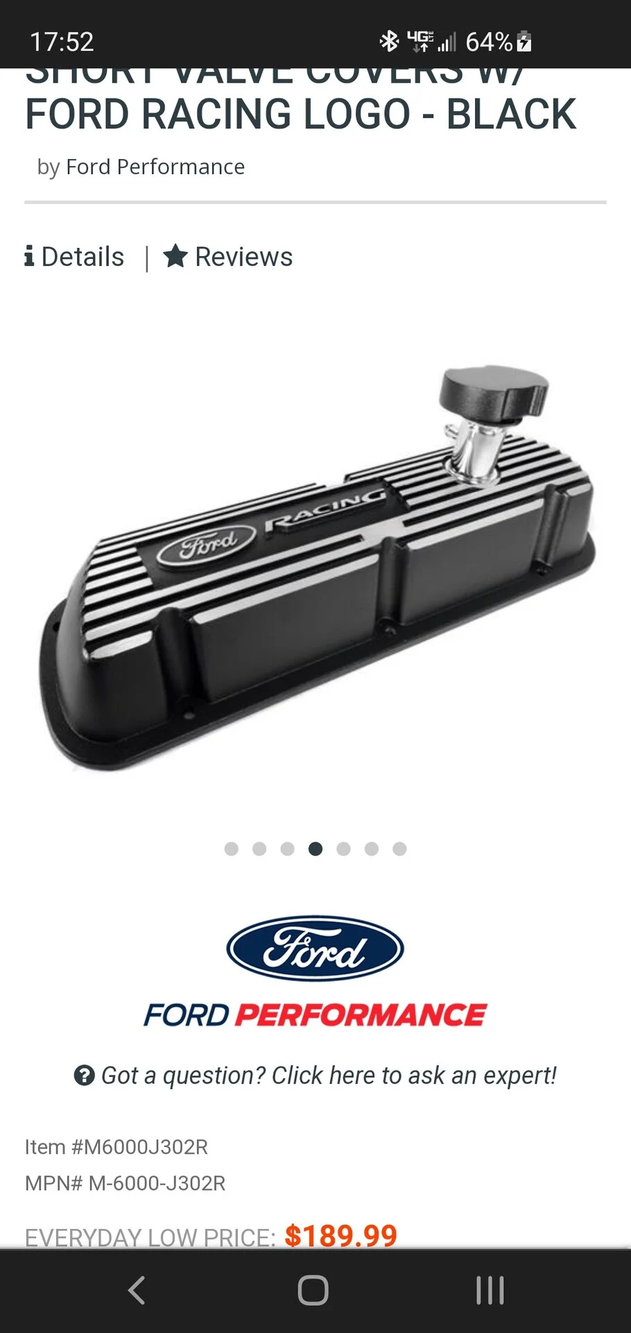

Habu135 said:
Thank you for that explanation. That was a lot of good information. I was under the belief that those tall valve covers were necessary due to the head and roller rockers. I'm not a fan of them and honesty would be fine with the stock ones although I suspect the fitment is completely different. Otherwise I'd go with something like in the attached photo. If I did go with the Trick Flow Series R intake wouldn't that clear the valve covers? Lots to research even for a "drop in" crate engine.
I've actually owned that exact valve cover believe it or not. I had them on my last foxbody 20+ years ago. I've actually gotten stock valve covers to fit with stud mount rockers. You have to cut the baffles out to make them work. It's a quick process with a Dremel with a cut off wheel. I was trying to use my factory Foxbody valvecovers on my SN. I did all that work to find out that the Foxbody valve covers won't clear the alternator on an SN. It won't be a problem with a foxbody accessory system though. Go for it!! Factory valve covers will give you a ton of clearance, with a proper fill neck.
Everyone is over focused on which intake will work best. I'm a big fan of my Holley Systemax 2, and I've had it on the car for over 20 years. I've installed just about every aftermarket intake there is. Every intake mentioned will work just fine. The reality is that you can swap an intake anytime. You can send one out to TMoss to get ported to up the high end output. the devil is always in the details. Getting stuff to fit and getting the engine to fire up is the real challenge.

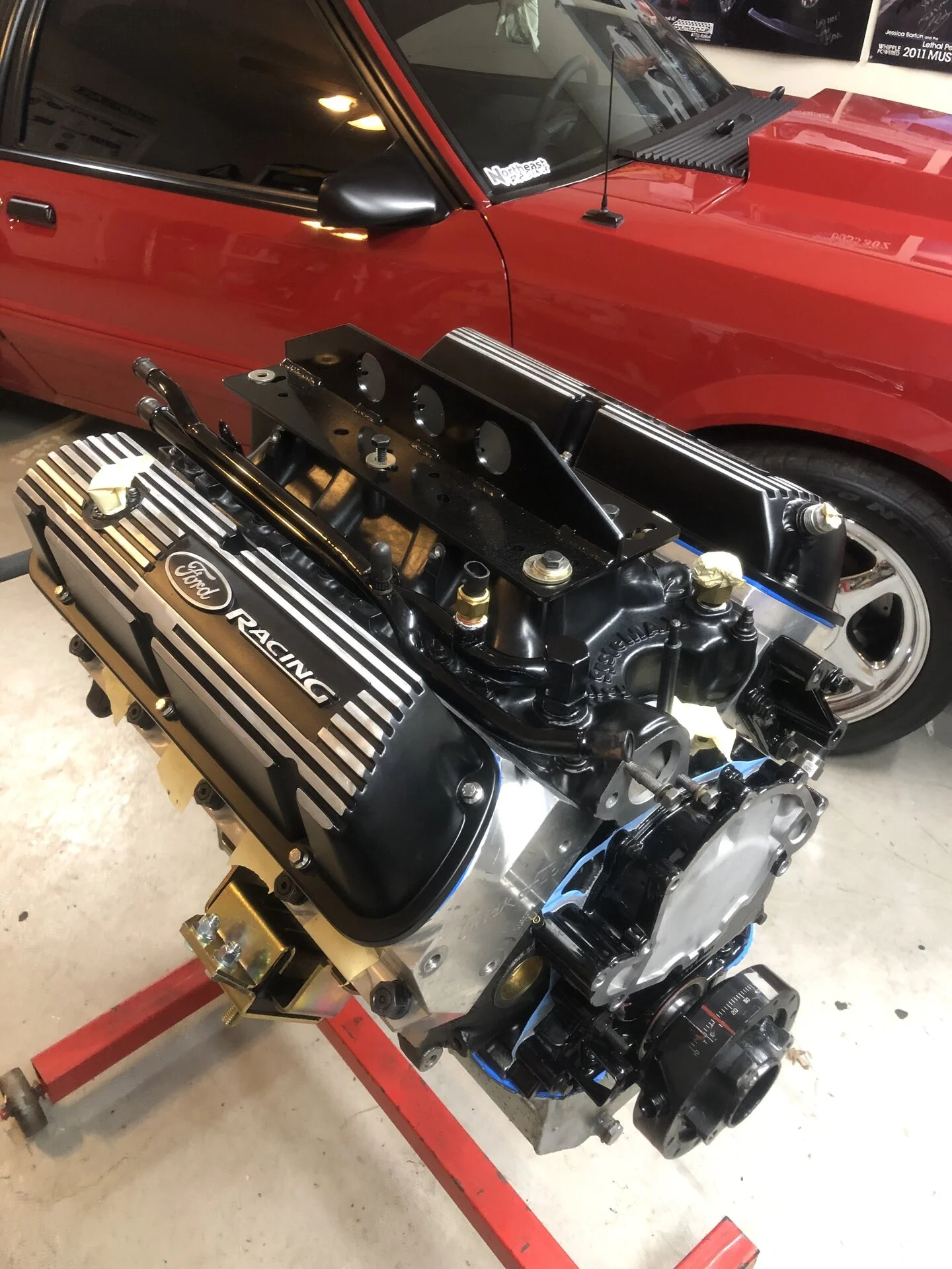

revhead347 said:
I'm a huge fan of Coyote swap. The comparible cost completely over looks the value of your time though. A Coyote swap takes real time, where a crate motor is a drop in with a far lower time investment. Some people make cost suggestions without the understanding of how much free time different people have. Congrats on choosing a crate engine; I have lost many hours of my life coordinating with machine shops, and getting parts where they need to go. There is a lot to be said for swiping your card, and the complete engine shows up truck freight days later. I also have grown to like the Ford parts too. There are better heads out there, but nothing seems to fit and work as well as the parts that Ford makes.
I would consider swapping those valve covers for the Trick Flow valve covers. Unfortunately, Ford is still too focused on old hot rods with carbs, and doesn't offer a low profile valve cover. The Trick Flow ones are designed to work with a fuel injected engine, and will be without a doubt the best step towards getting more clearance for your stock hood. It was the best investment in clearance I ever made. You can also put a real filler neck on it.
I would also look at the BBK headers over the Kooks. I doubt there will be much performance difference between the 1 7/8" over the 1 3/4", and the BBKs fit so much better, and less than half the cost.
Kurt
I have long tubes, unknown brand, that came with my car when I first bought it. It has a Trick Flow Power Pacakage, but the car was run hard at the track and honestly I've been overdriving it and now it has a nice tick. This is after I blew both head gaskets and front timing cover seal about three months apart. Ugh. I called Ford Racing a few weeks ago and asked specific questions on this crate engine, but the technician wasn't very helpful. I think I'm close to knowing all the parts to complete it, but I hadn't thought about the intake clearing the valve covers.
Are you saying that short valve cover will work on this 363 crate engine as long as the interior baffle is cut out?

Habu135 said:
I suspect you're about right. I just did a quick search myself.
The advantage of a Coyote Gen 3 over the Z2363 is what a higher revving motor and a little more room to grow into mod/hp wise? I'm thinking 450-460 RWH is good for the streets on normal street tires and anything above that will need drag radials or more drag focused suspension. I want to keep the car N/A and am leaning toward the Z2363 engine for uniqueness. I'll be backing it up with a T-56.
Although more complicated and time consuming it’s really a no-brainer anymore. 1000+HP on a stock bottom end? Yes please. I plan on keeping this car until I die or wreck it, so I’m keeping the long view. In that long view, the coyote will cover any plans that will develop over the next 30 years.
I tried to get my stock VC's to work with my Crane Gold 1.6's but it wouldn't work. Ended up running these exact valve covers and the intake clears them fine with a 3/8" spacer, which fits under the stock hood.

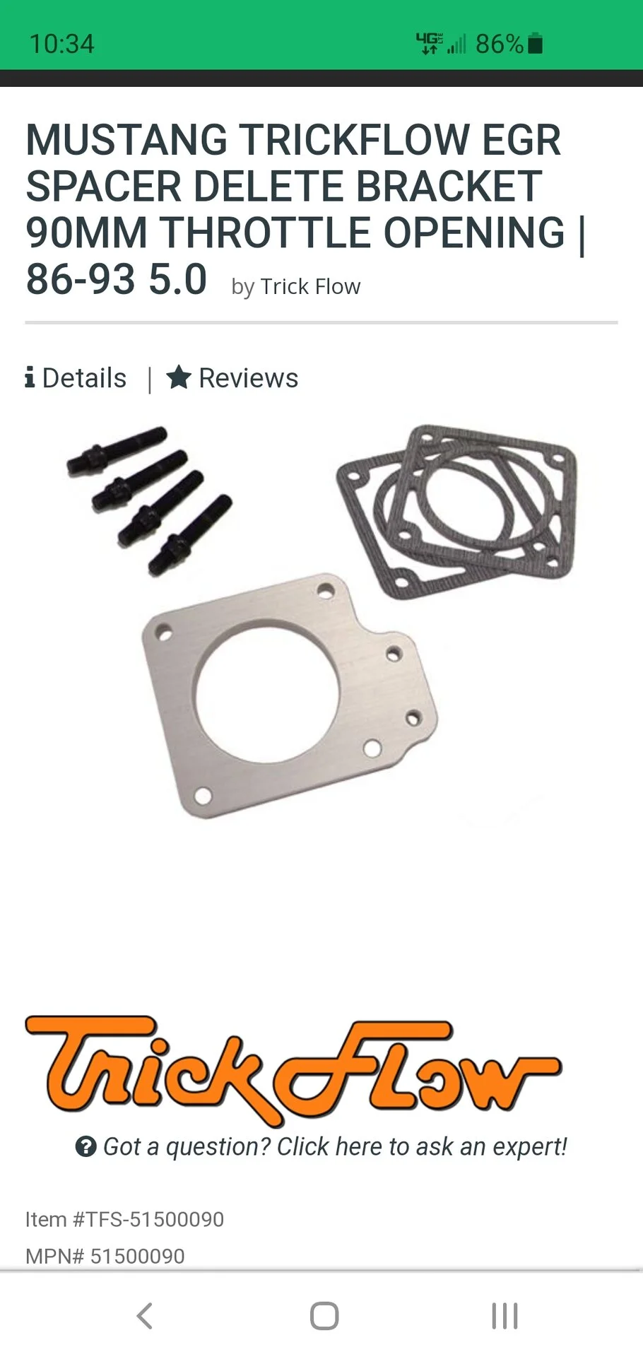

TOOLOW91 said:
You can get the the thin spacer with the throttle bracket mount from eBay or Accufab with the tb
https://mc-machine.com/ols/products/50-throttle-cable-bracket
Here’s the adjustable cable bracket I run
Ok. I wasn't aware that that was needed.
Is an EGR spacer, such as the one shown here, needed. I'm not running an EGR or EGR blank now and I'm not sure if one is needed to marry the Series R and 90mm throttle body.
That will work as well .
Yes, I got the stock valve covers to work with both my Canfield Heads, and a set of Windsor Jr. heads I had. It's not enough to remove the baffles, you have to cut the studs the rivets go into. If that won't clear, then get the Trick Flow valve covers. They are cheap, and will give you lots of clearance on the intake.
