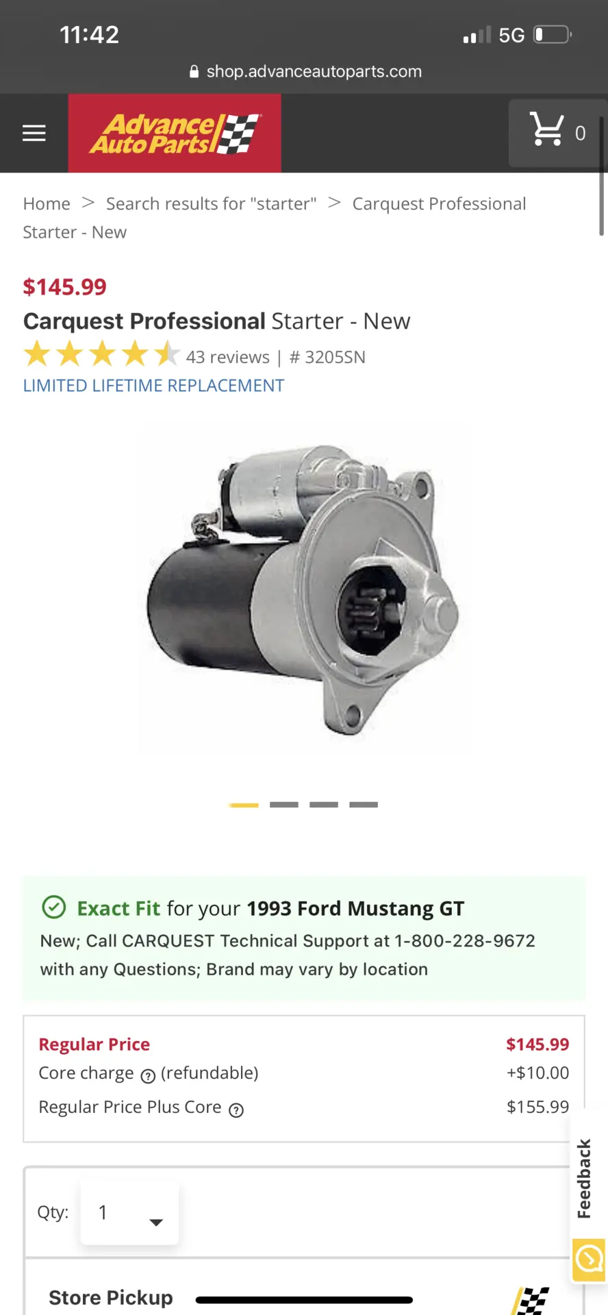

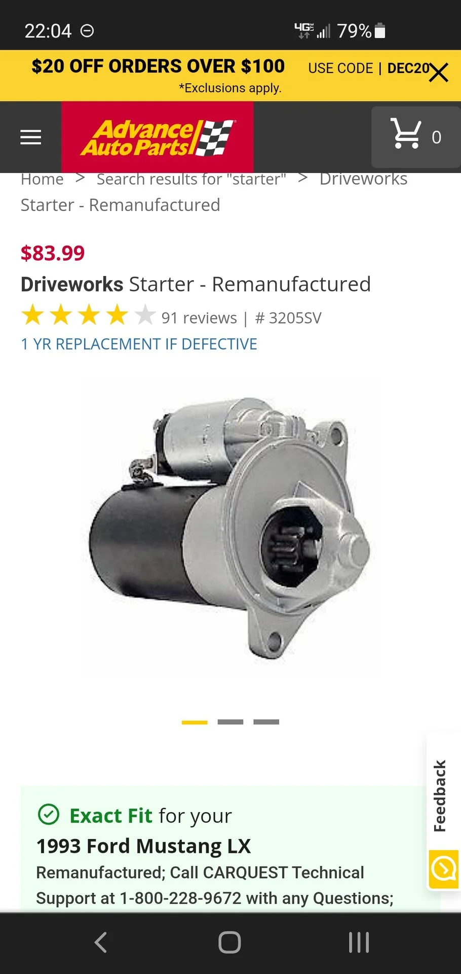

Habu135 said:
$103. Not bad.
Driveworks is a little on the bottom end. It's a brand where they take it apart, find what's broken, and fix just what's broken.

Habu135 said:
Lifetime warranty? Alright. You sold me.
Looks like a stock starter to me. By the description, it says they "may" have made modifications, but haven't necessarily made a better starter. You can get a lifetime starter from a Parts store and get it swapped out same day, not wait a week for round trip shipping.

96pushrod said:
The car quest one I have is a pmgr, and I’ve used a pa performance one as well with good results. The parts store starter in the car spends it’s life a couple inches from some long tubes, and I’ve never seen problems with it.
Really the whole reason I recommend one from a local parts house is it makes warranting them easier.
I had to swap both starters on my GT and the Cobra to a gear reduction because the heat soaking issue couldn't be solved any other way. My point is, if you drop $149 on parts store starter, which is about what they run for a decent one, and it heat soaks, well then you are out that $149. Vs spending a little more money up front, and being absolutely sure it won't have heat soaking problems. That's how it went for me. So I was out about $350 at the end because I ended up buying 2 starters. I'm pretty sure that factory starter is still sitting in a box somewhere with hardly any miles on it.

revhead347 said:
Driveworks is a little on the bottom end. It's a brand where they take it apart, find what's broken, and fix just what's broken. I'm
Kurt
Mustang5L5 convinced me based on his sound logic, to buy that PA one. It's brand new, not remanufactured and has a lifetime warranty AND it's competitively priced.

This one . The drive works one is garbage .
