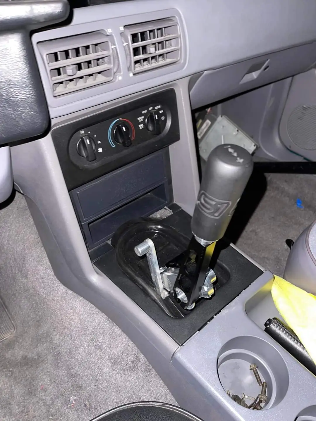

You need one of these too :)
I'm actually going to screw the T-5 knob to the top for the sake of originality. Dumb, but understated is what I'm going for.
