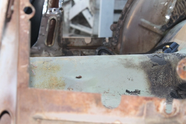

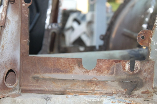

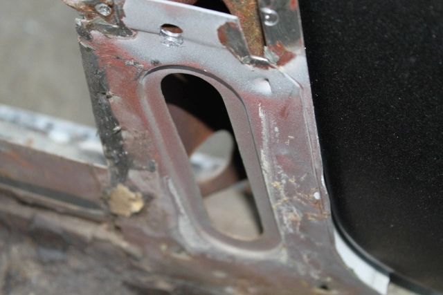

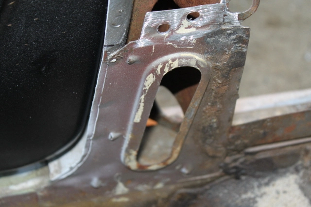

or must have been a friday car . this is the coupe i am converting into a fast back. look closly at the plate on the bottom of the drivers rear door post, the one with the oblong hole. then look at the pass. side. they have never been taken appart. they are both drivers sides. pass. side is inside out. someone welded a drivers side on the pass. side at the ford plant. now look at the bracket for the quarter window slider from the door post to the rear wheel tubs .looks like they just guessed at the location and welded them in. the pass. side runs down hill at the front and the drivers side runs up hill at the front . so if you have ever had some one tell you it must have been a factory screw up probably is.

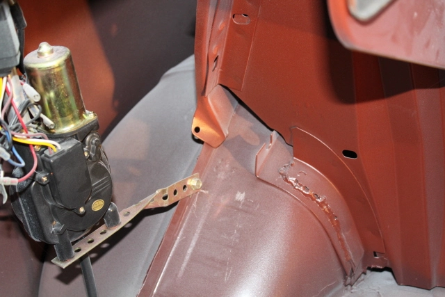

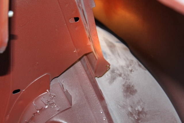

this in not the only car i have seen with parts welded on wrong from the factory.my 69 fastback has the roof brackets welded on the correct side on the pass side and on the wrong side of the drivers wheel tubs.

this is my 69 fast back, the roof brace on the pass. side is correct where it attaches to the wheel tub.the driver side is clearly on the wrong side of the wheel tub lip .they even had to bend the brace to make it work this is all factory spot welded . one coupe i worked on a while ago had the roof leaning towards the driver side of the car 1/2 inch. so if you ever wondered why one part may fit one car and not another ,now you know.
