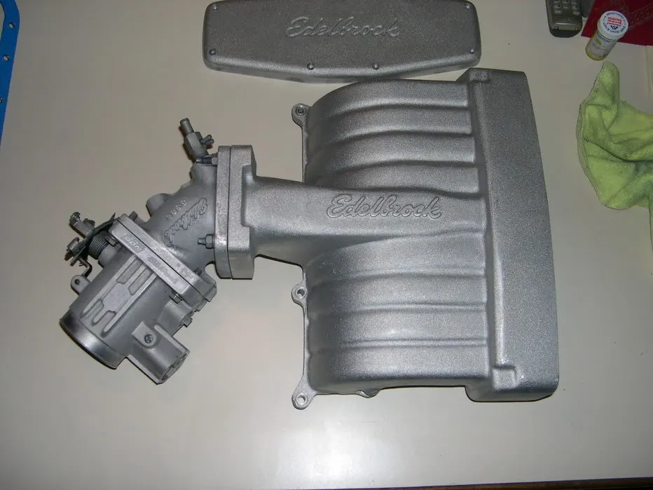

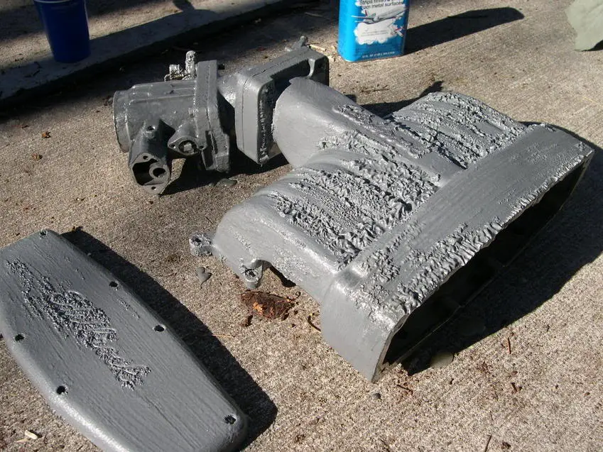

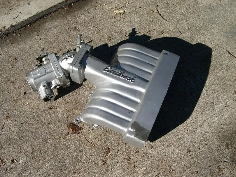

I used aircraft stripper on my intake as well. Twice. It didn't strip it completely .... but it did better than any of the other crap I tried. Gotta be really careful with that crap, too. Very potent stuff.
Make sure you get the brush on tub though. The aerosol one sucks. I tried doing my valve covers with the aerosol and it doesn't work for ****. I ended up just getting some fox covers cause there was no way I was gonna make the stocks look good again. But the brush on works cause it has to lock in the chemicals, if you brush back and forth it will oxidize the chemicals and they won't strip.

What did u do excatlly there to that intake to get that finished product? looks great.
