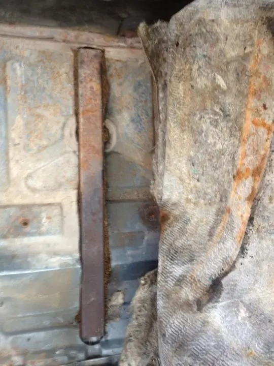

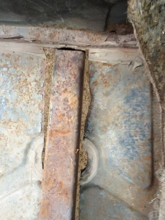

For starters, when I bought the car the other day, the guy told me it already had sub-frame connectors. I glanced under there and sure enough it did. Well today, I was pulling the carpet out to clean it, and found my first big disappointment in the car. Someone made some homemade through the floor sub-frame connectors, and never even welded the floor pan. Not to mention, they didnt cut very close. Which explain the noise level lol.

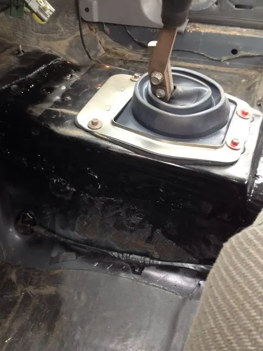

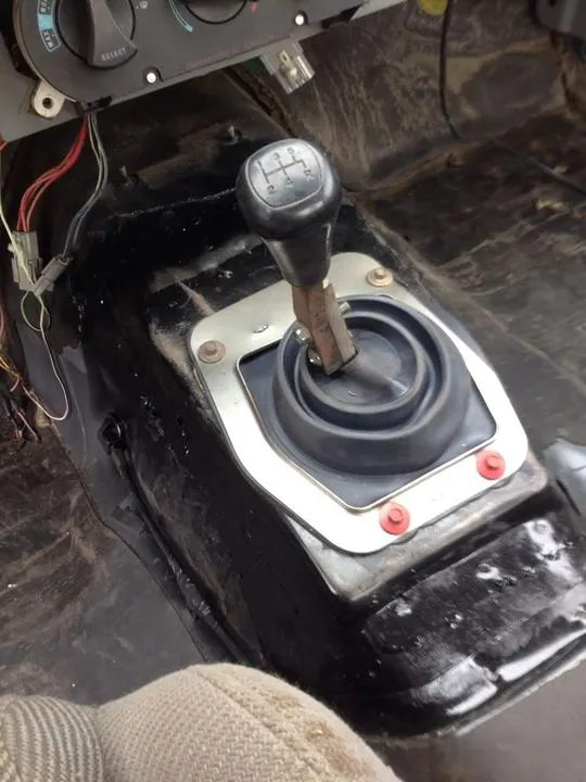

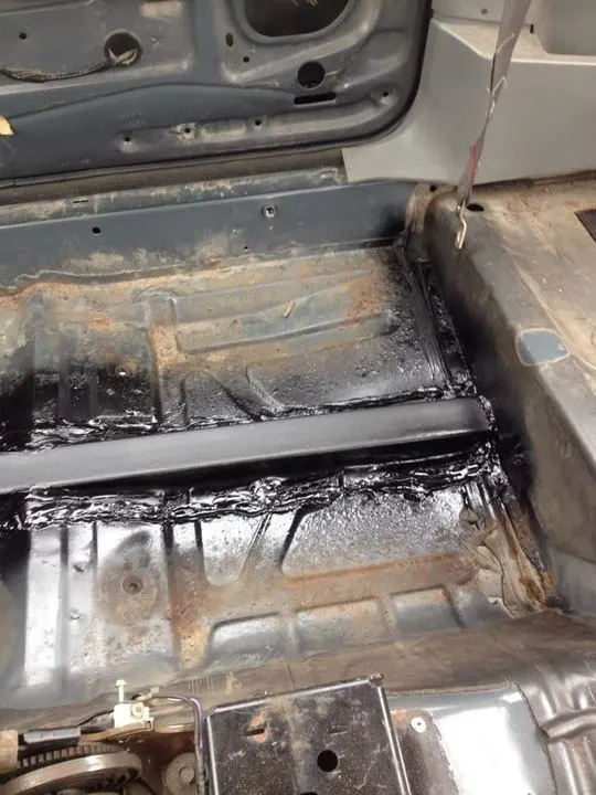

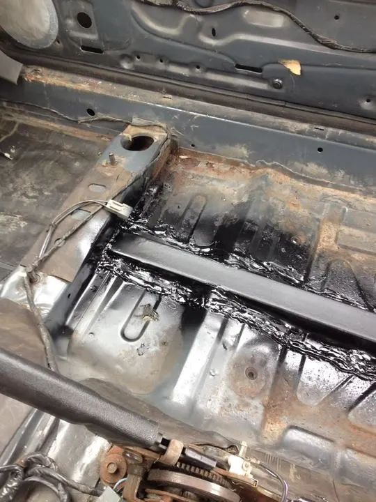

Picked the car up today. He ended up doing the following:
Ripped old SFC's out
Built and installed new ones along with fixing the sheet metal and sealing it all correctly
Welded up torque boxes and installed Wild Rides kit reinforcements
Cleaned up a bunch of rust I had on the rear frame rails and coated them
Installed and welded up my 5-spd transmission "hump"
Fenders were already rolled (I hadn't even looked lol) so he didn't have to do those
I'm very happy with how everything turned out. The only mix up we had was the outriggers on the SFC's. He didn't put any in, but can be done later if I ever put a cage in. I would definitely recommend him if anyone needs any work done. Mcilwaine's Race Cars in Baytown is the name of the shop. He has some incredible cars in there he is working on.
I don't have any underneath pictures, but they look about like every other torque box reinforcements. Here are a couple of the SFC's and the trans tunnel. The black stuff you see is sealer:
