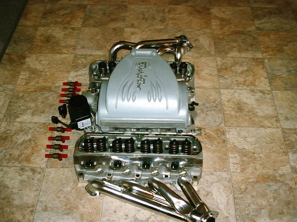

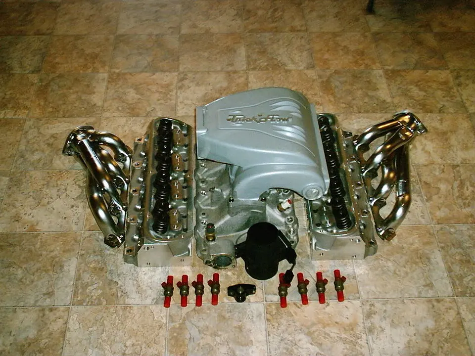

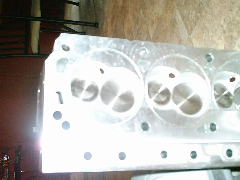

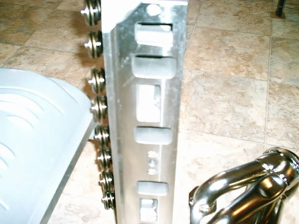

So I found a great deal. So for 1600$ this is what I get. It's going on a 351w that's getting put into the 90.
trick flow 351r intake
trick flow heads oringed(new)
trickflow roller rockers(new)
bbk shorty swap headers(new)
30lb injectors with mass air
Lol, so was this a good deal for 1600$? :p
I didn't take the rest of the rockers out because they are individually wrapped up.
This is going on a 351w with an undecided cam (probably something similar to TFS 2 cam), with a 70mm TB, those 30# injectors, and all the other typical bolt-ons, in a fox with 3.73's and a 5 speed.
I think it will move pretty good.

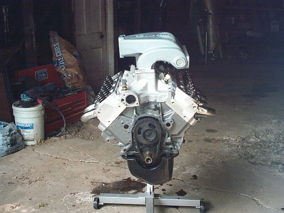

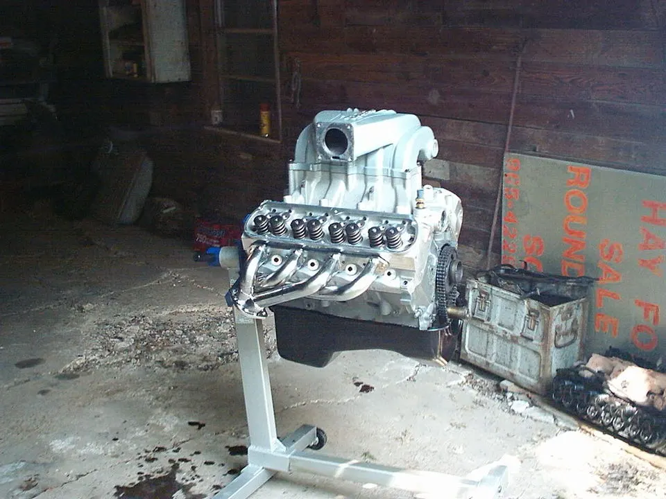

Well today I took the valve covers and intake off the 351w I'm putting all that on. The engine is very clean. It supposedly only has 70k on it, and I believe it. I bought it from a friend that I trust so I don't think he would lie to me. I also took off all the crap I'm not going to use, so basically its just a shortblock right now. Me and a friend just degreased it and cleaned it up. When I get something to scuff it up with I'll paint it with Cast Coat Iron paint, even though the original Ford Grey was kinda cool. I think Cast Coat Iron will look great in contrast with the top end that's going on it.

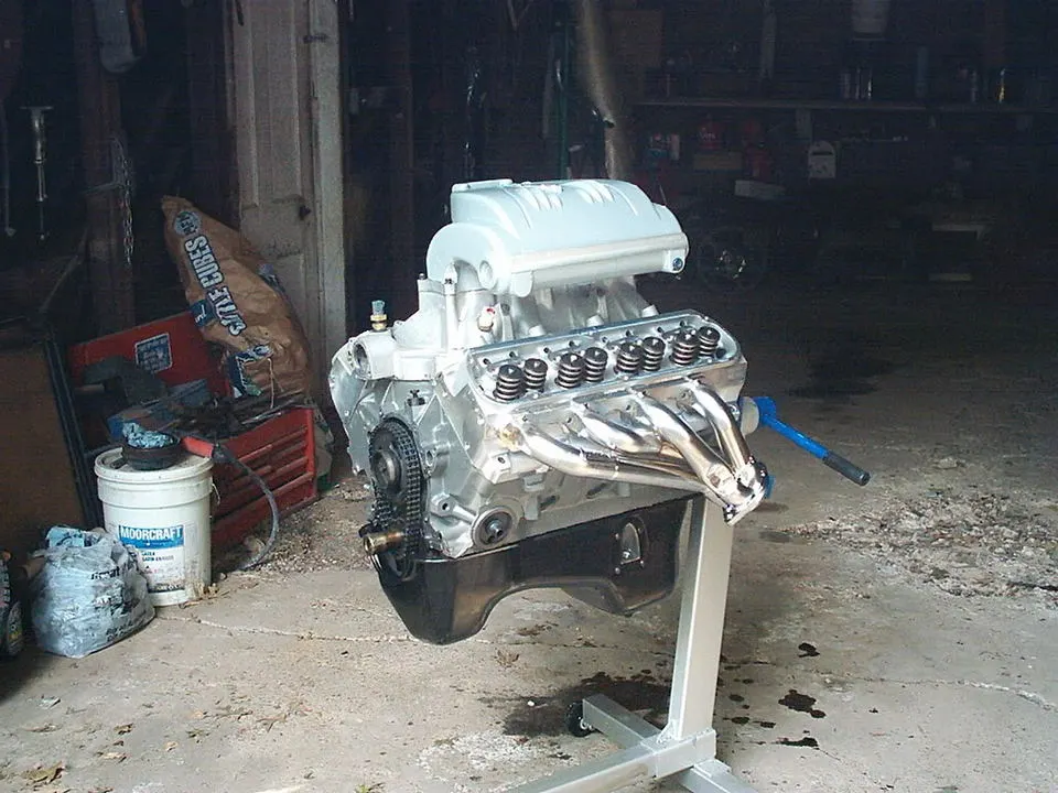

Today we finished cleaning the block, painted it, put on the oil pan, and set the heads and intake on it to see what it will look like. Here are some pics.
The valve covers aren't on yet because I'm using the one's from off the 302 that the 351w is replacing. They are finned polished "MUSTANG powered by ford " covers.

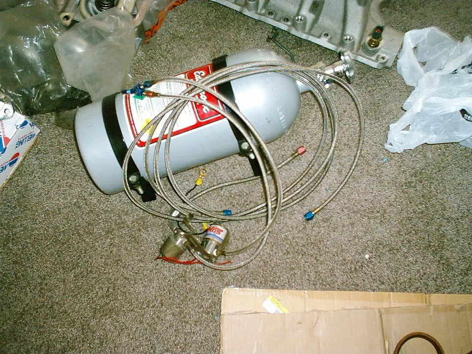

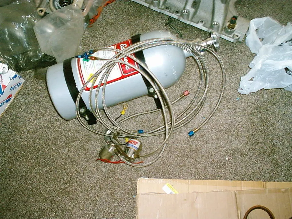

I picked up a little back up horsepower for the 351w, just in case.:banana:
Thinking about running it on my 04 GT until this motor is in the car.

Is the 351 cut for locwire gaskets, by chance? With the heads having the locwire grooves cut into them, the block needs them, too. It'll never seal the combustion chamber otherwise.
