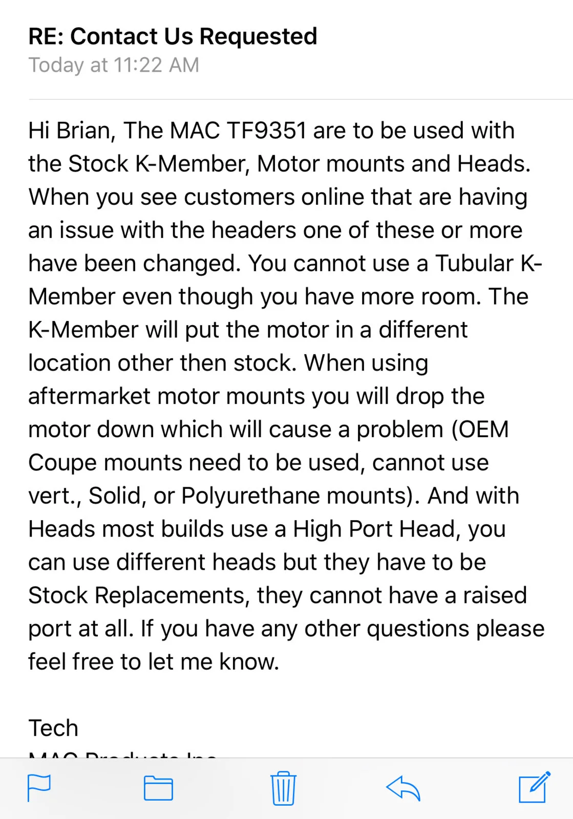

Incase anyone wants to know about the Mac swap LTs. They pretty much make them so they won’t work with 90% of the community that would need a 3” exhaust.
