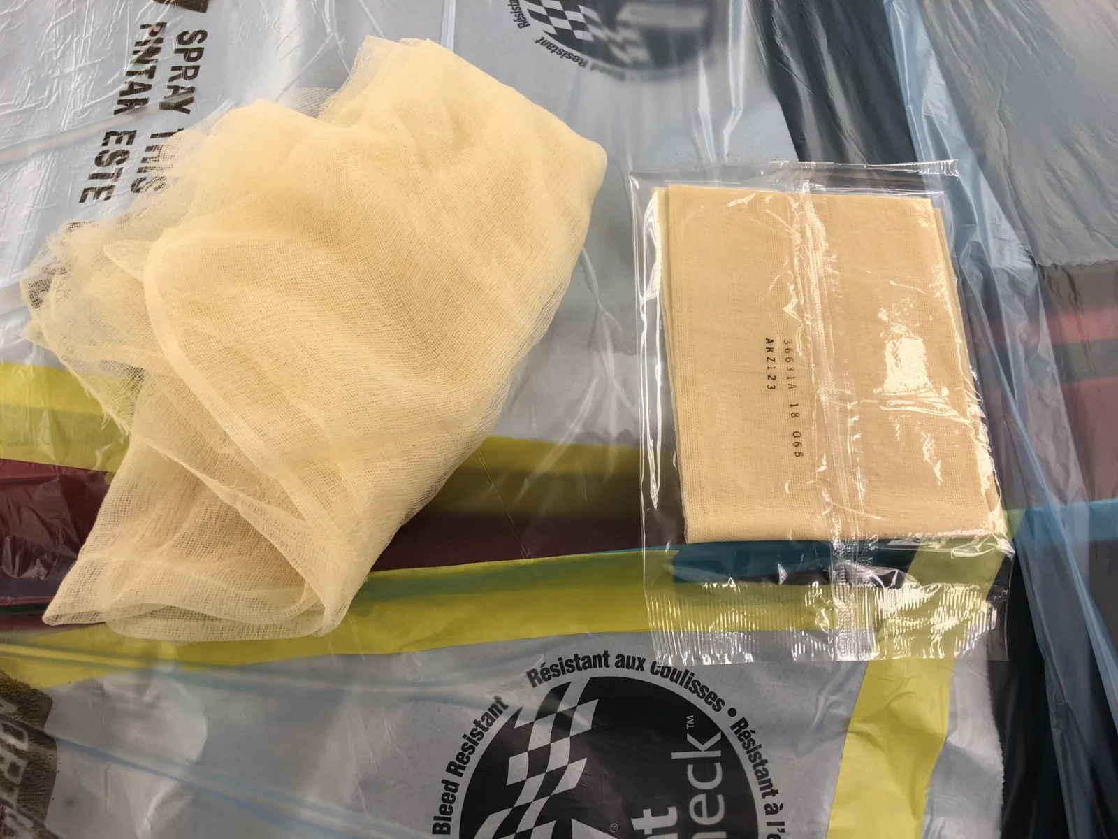

I don't remember if I talked about tack rags much before.
First off, you'll want to use one while painting to keep dust off the vehicle.

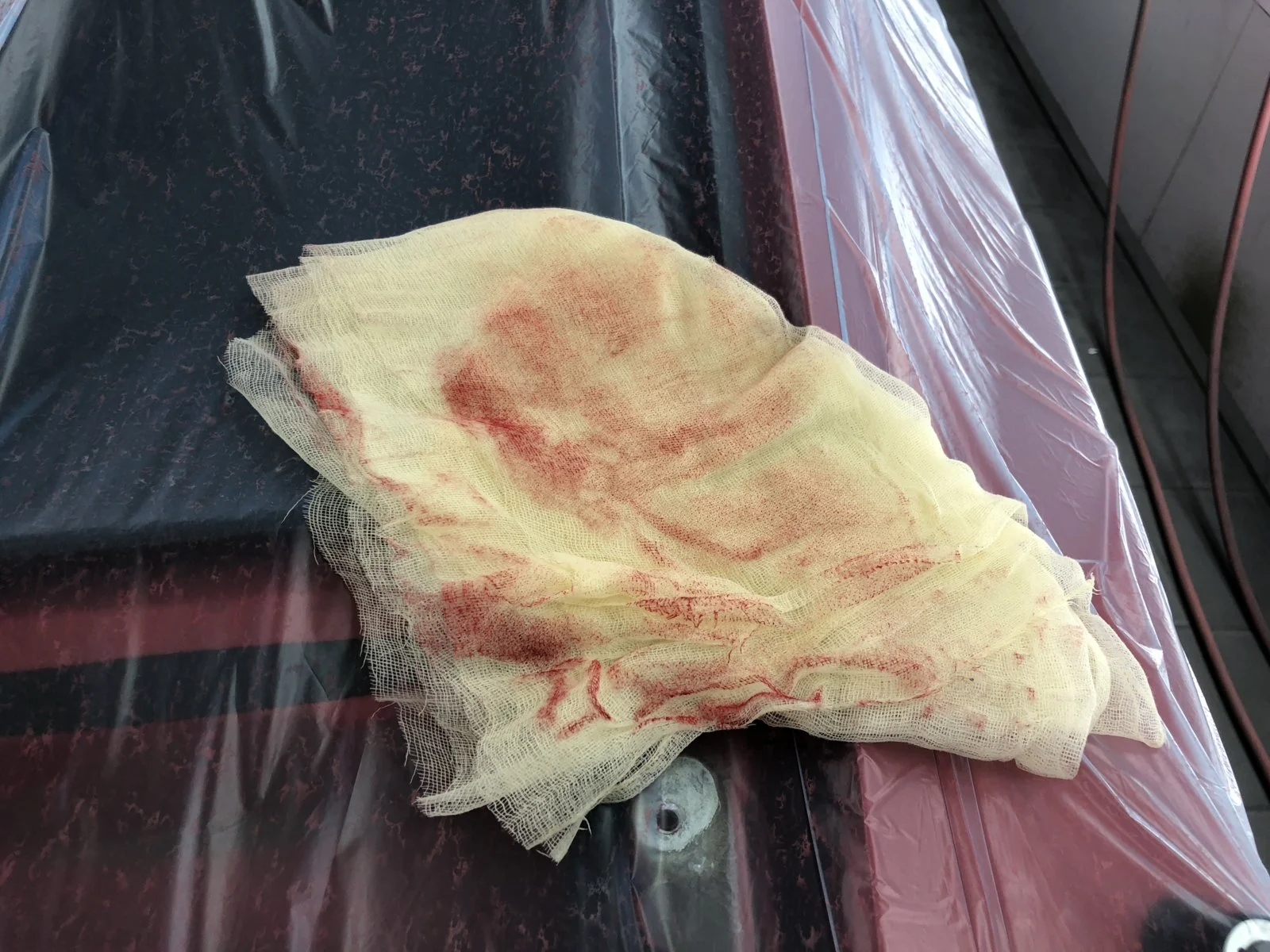

Secondly it helps to remove dry overspray that you'll get while painting.
Here's a tack rag wiped over a couple panels that were completely painted end to end. Notice how the overspray can lay back onto the panel as it dries. It may be overspray, but it'll look like dirt nibs when you clear coat it.
When using a tack rag, take it out of it's wrapper and completely unfold it, then fold it back into usable rag. As it is in the package it's too tightly folded to really be of much use picking up dirt.
