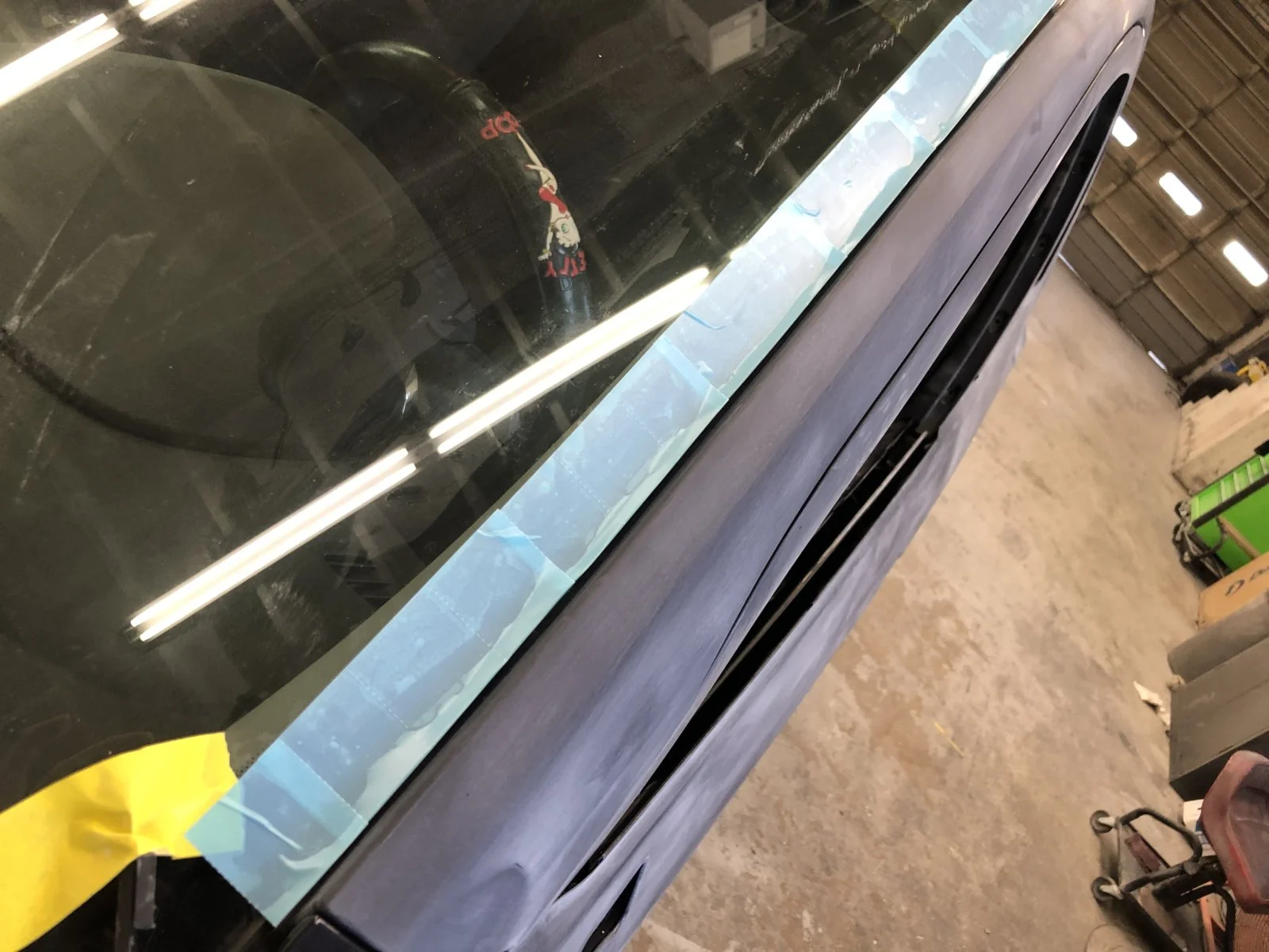

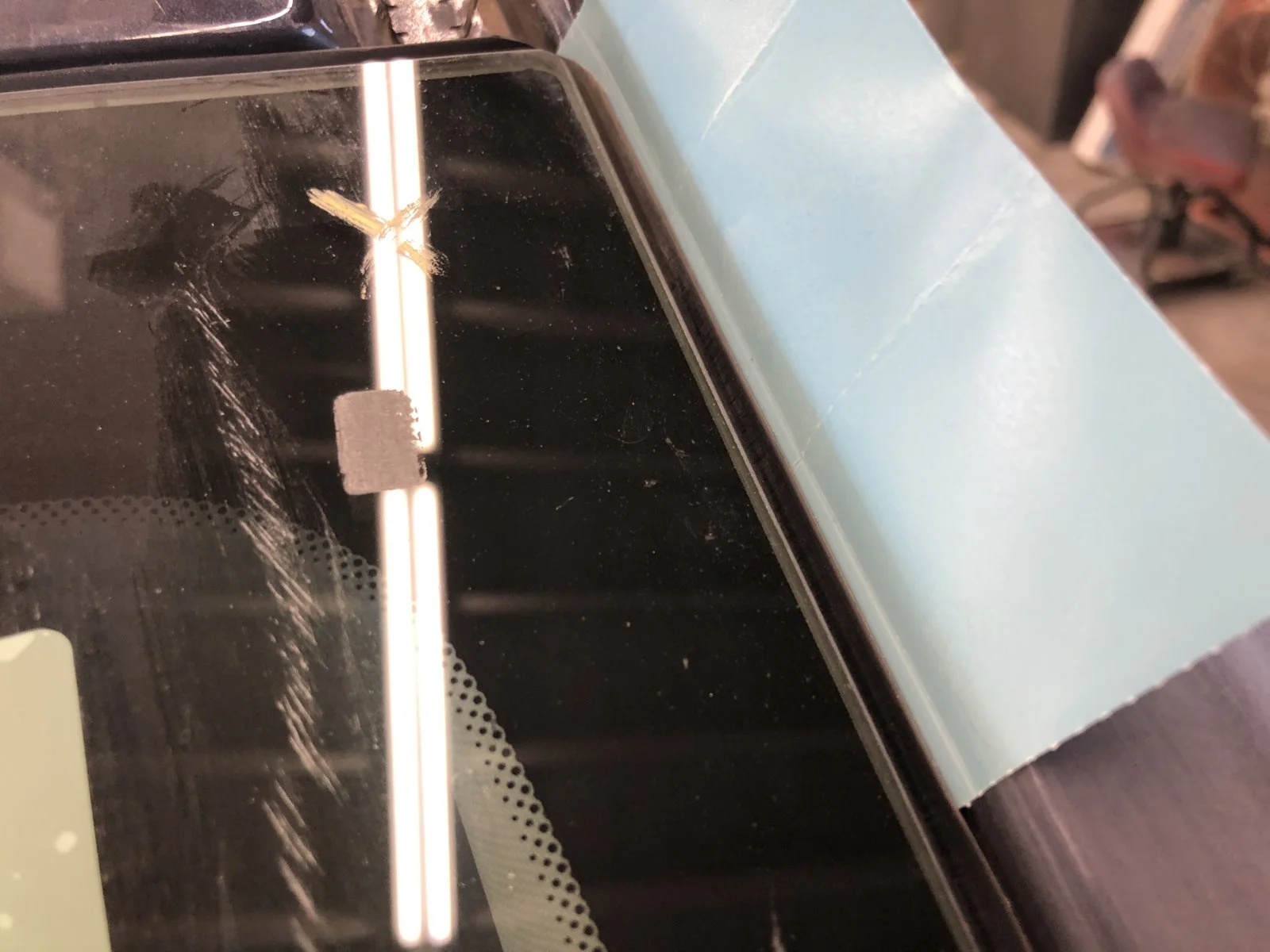

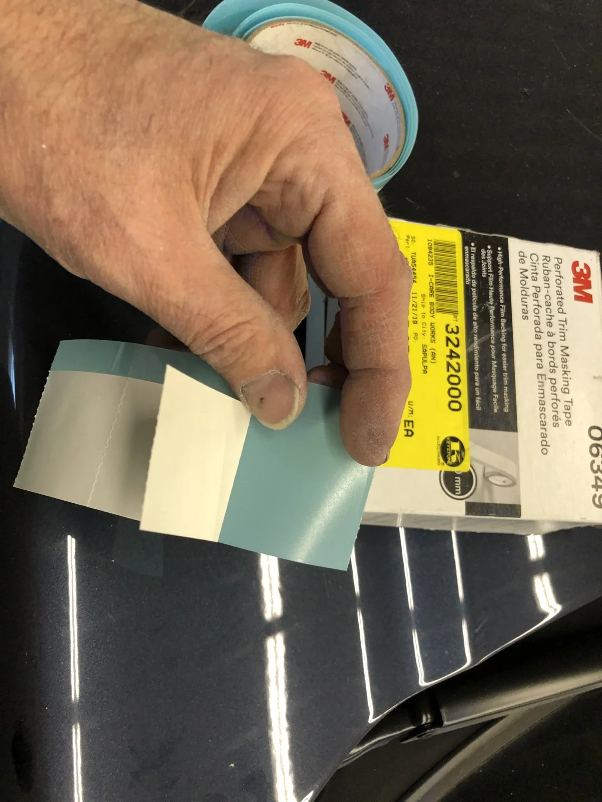

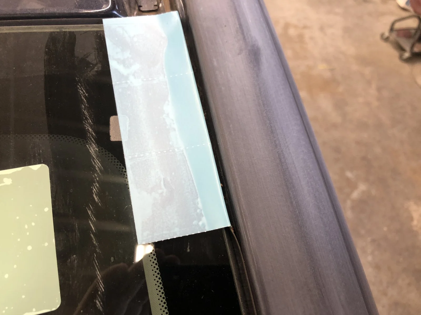

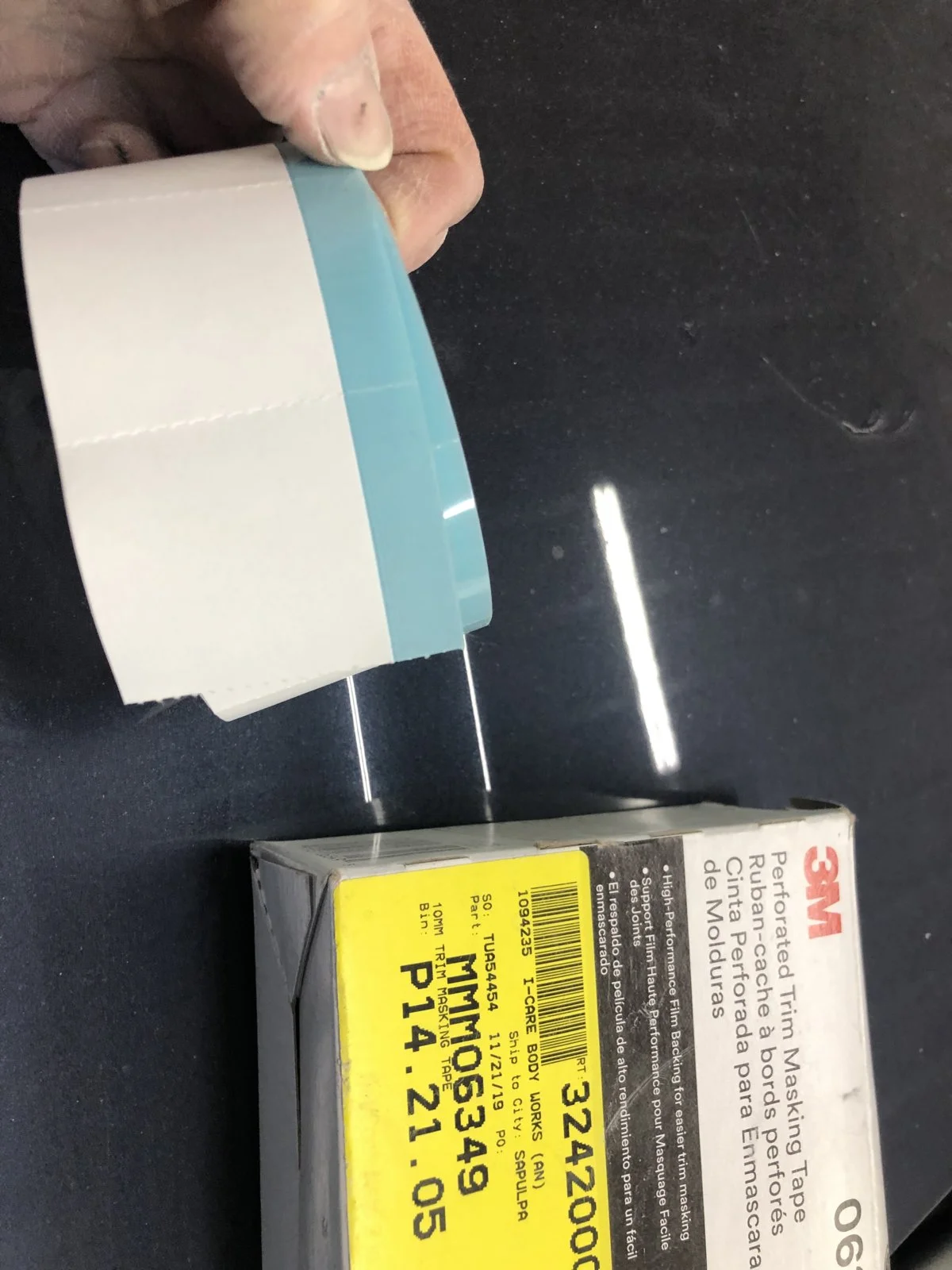

Here’s the trim masking tape “in action”.
Peel off the backing
Slip the rigid edge between the seal and the panel
Pull gently away from the painted panel and stick the adhesive end down
Done for this job
Reactions: 02 281 GT, RaggedGT and Olivethefet

Yep, that tape works great for us too here at the shop

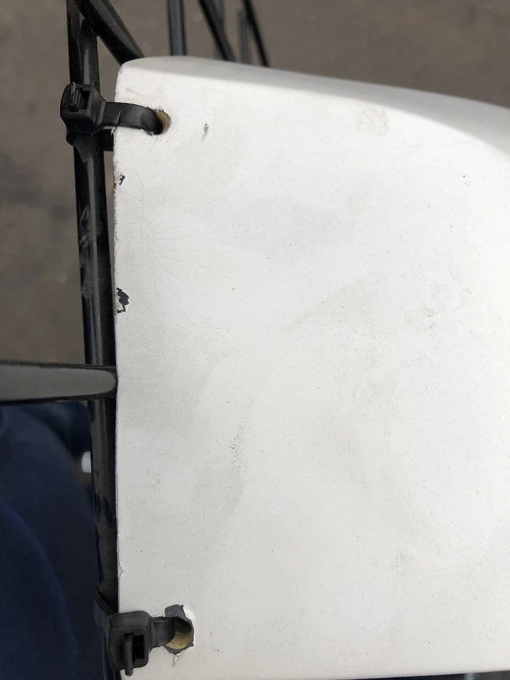

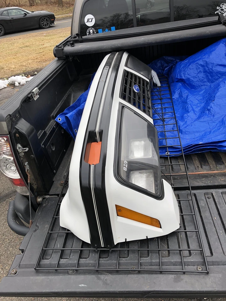

What's the best way to fill holes in a urethane bumper cover?
I bought this wall-mounted bumper recently and there's holes in it to zip tie it to a metal grill
I saw your post in the cliffnotes thread using this: https://www.stangnet.com/mustang-fo...liff-notes-edition.900362/page-5#post-9076744

Man, i’m sorry I missed your post. If you go back one page on the link you have in your reply you’ll find where i patched the whole in the rear bumper. I would do the same thing for those holes in your bumper.
