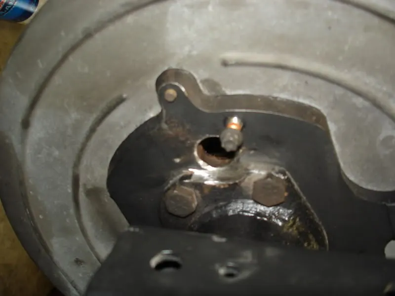

I did a search but did not really find what i need to know. What is needed to make a fox body rearend fit under an SN95? I know the housing is the same length, but can I use my 94 GT axels and disc brakes? Do the brake caliper brackets bolt up to the fox body? Will the ABS sensor attach correctly? If not, what mods need to be done?
same housing, you can put 94 axles in. the abs sensors need some clearance on the housing. and you need to drill 2 holes for the brake lines.
and thats all. :nice:
notice the small hole i had to drill so i could mount the brake line., I also had to grind the area where the abs sensor went so it would fit.
