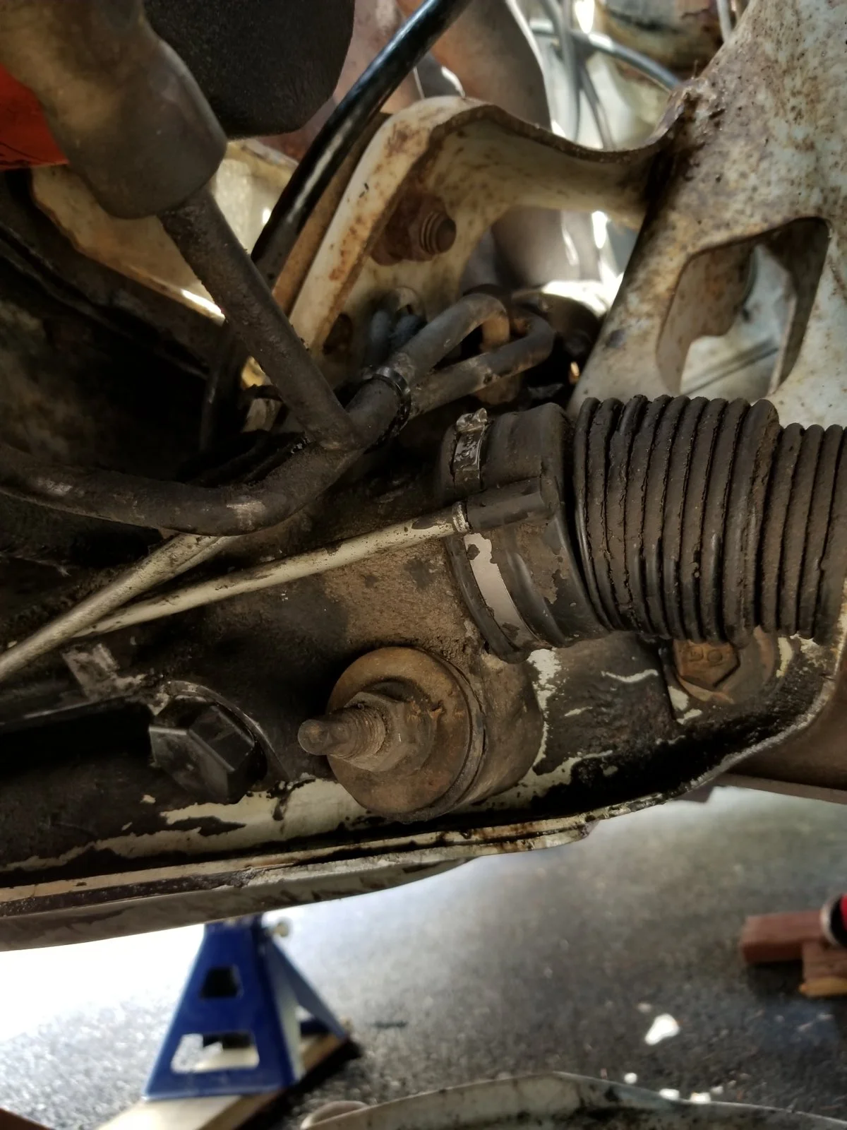

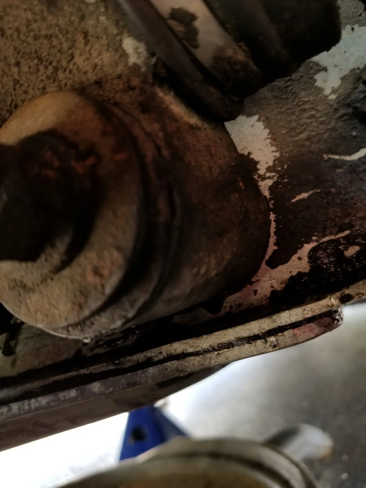

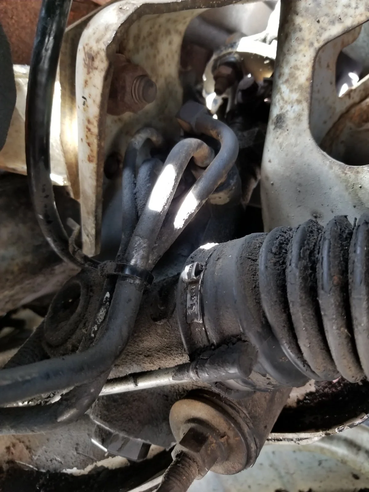

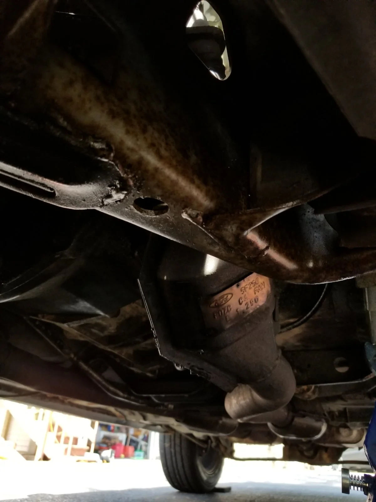

So I filled the power steering reservoir, had my son turn the wheel from lock to lock, and theres no place where the fluid is shooting out. It drips down the rack where the drivers side bolt is that holds the rack in and down the whole a arm , I've added what pics I could get, the lines are all dry, the boot is dry, Is it possible the rack is cracked?

Look at where the lines attach to the PS pump, where the lines screw into the rack and if you don't see any leakage then only other spot it could be would be from one of the inner tierod ends. I've had a seal go under the boot before and let the fluid flow out to my driveway.
