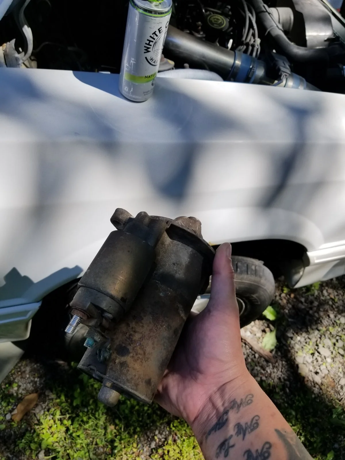

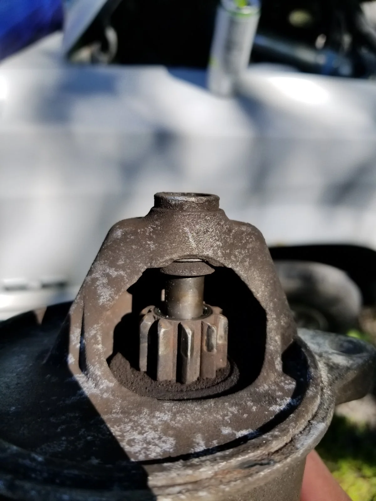

Got the old starter out and new starter in today and its such a different vehicle it cranks so much faster it's great, found out why the old starter went bad, the person I bought the car from must have installed one years ago and didnt tighten the bolts up they couldnt use the extensions to go through the k member to get to the top bolt , It wasn't tightened up at all , i took the bolt out by hand
Thats always nice... On the flip side, all your bolts could be original and rusted into place like mine. I wouldnt mind a hand tight one here or there, so long as it didnt cause a problem like yours did. Anyway, glad you are up and running again.
