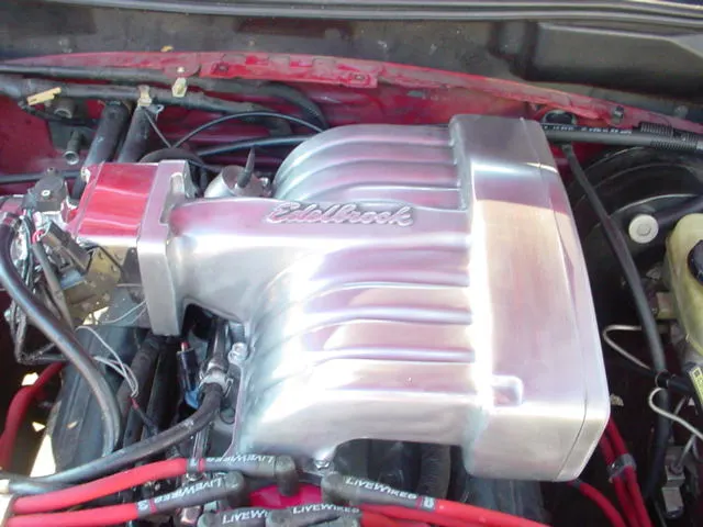

Pretty easy to do. I got a accufab TB spacer (blank) with the cable bracket flange. I also got a throttle cable and bracket off of ebay, a TPS sensor at a junkyard, and a 5/8 cap at ace hardware for the egr header bung. I also just put a Anderson power pipe for a 86-93 stang on to. It looks pretty cool and most of all it looks really clean looking under the hood.

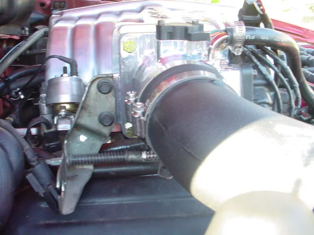

Like before pictures of my car? Sorry I havent been to stangnet in a while. BTW what does IAC mean?
GTJake
Oct 28, 2002
3,049
56
Ann Arbor, MI
Jun 9, 2004
#12
  • Jun 9, 2004
  • #12
IAC= Idle Air Control
It's black on 94-95's and that silver tube that bolts to the TB on foxes. I thought I remember you using a 94-95 IAC instead of the fox one when you did your swap. Just wondering if you have any close up pics to see what it looks like compared to the fox IAC.
Jake
stang_gt_1994
Mar 21, 2002
2,723
Powder Springs, GA (30 min. from Atlanta)
Jun 9, 2004
#13
  • Jun 9, 2004
  • #13
Oops, dident think of that. Well I did use the stock IAC valve from 94-95's. Here is the only pic I have. Also a shot of the TB bracket.
