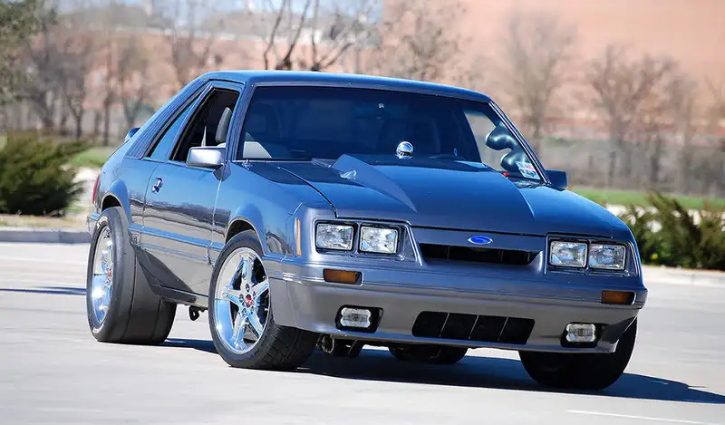

a friend of mine has a 86 GT that he wants to convert the front end to the 87-93 body style and i would be helping him with this conversion, just wondering what all is needed to do this? do you have to replace just the front nose or what??

tell him to sit in a chair next to it and look at it for awhile... if he doesnt change his mind tell him to just sell it and buy an aero nose. why waste a good 4 eye? they are rare enough as it is. theres bajillions of 87-93 cars out there.

if that is what he really wants to do then he will need the front clip, body moldings, new headlight harnesses, headlights, and I am not sure if he will need a new rear bumper to match the moldings or not.

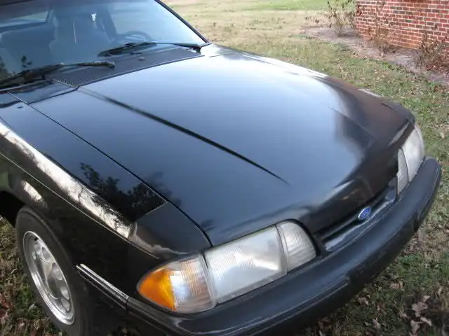

I actually started the "Aero nose to four-eyed" thread. Feel free to tell your friend that I'm actaully looking to do the opposite, change my 93 front end into an 85-86 GT front end. PM me if he's interested in swapping. Here's some pics of my front end, it's in great shape except for the faded paint. I can take some better ones tomorrow when it's light out.
