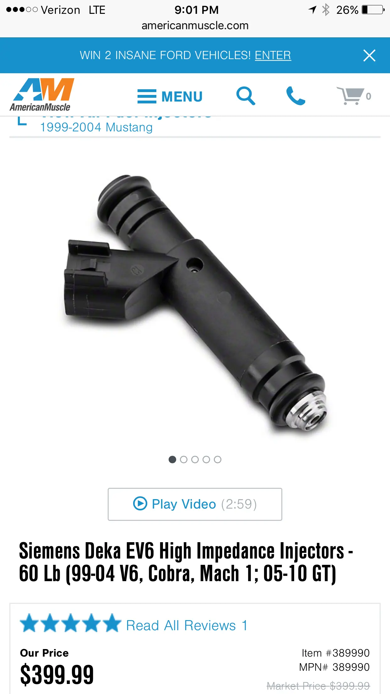

These will work with a stock '91 rail and harness?

My insight is to leave the stock rails in place. You're over complicating things. I had similar concerns and brought the same question up to one of our Vortech Aficionado's @84Ttop and he set my mind at east, claiming the stock rails were sufficient to well over 500rwhp. Get yourself a good pump like a GSS340BX (255lph high pressure) and a set of 42lb/hr injectors or larger (I'd recommend a set of Siemens 60 or 80lb units) and don't give it another thought.
^^^ This exactly, stock rails / GSS340 pump and 60lb injectors and you'll be good to destroy the stock block all day long :nice:
