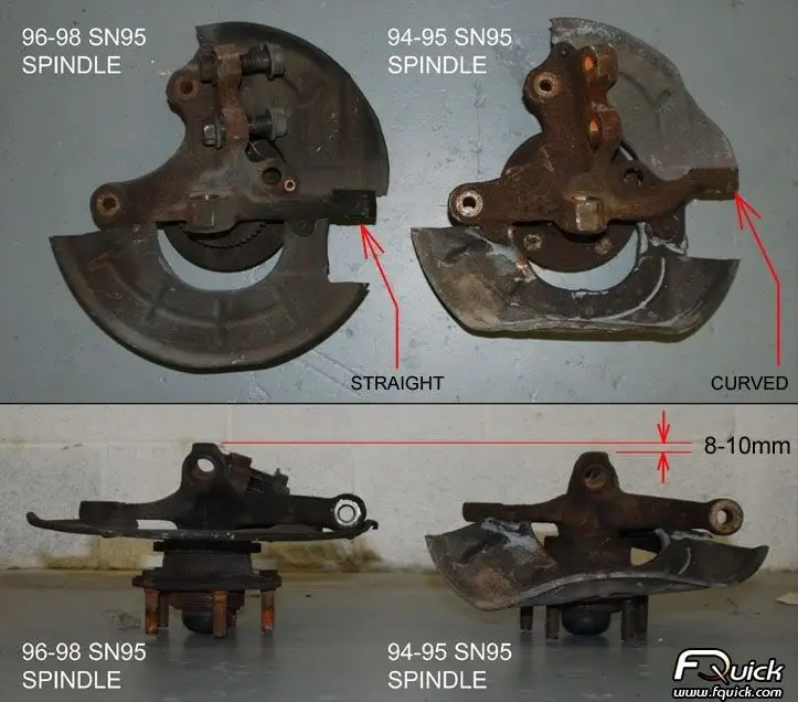

The '94-'95 spindles don't come out any further than the stock Fox ones do. The '96-'04 spindles will push the wheels out approx 8-10mm over the Fox.

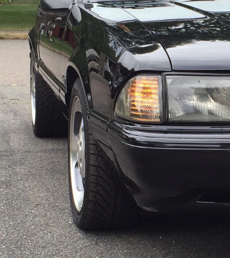

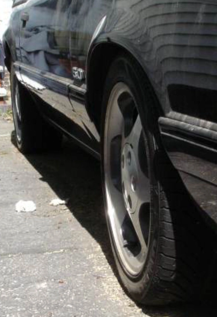

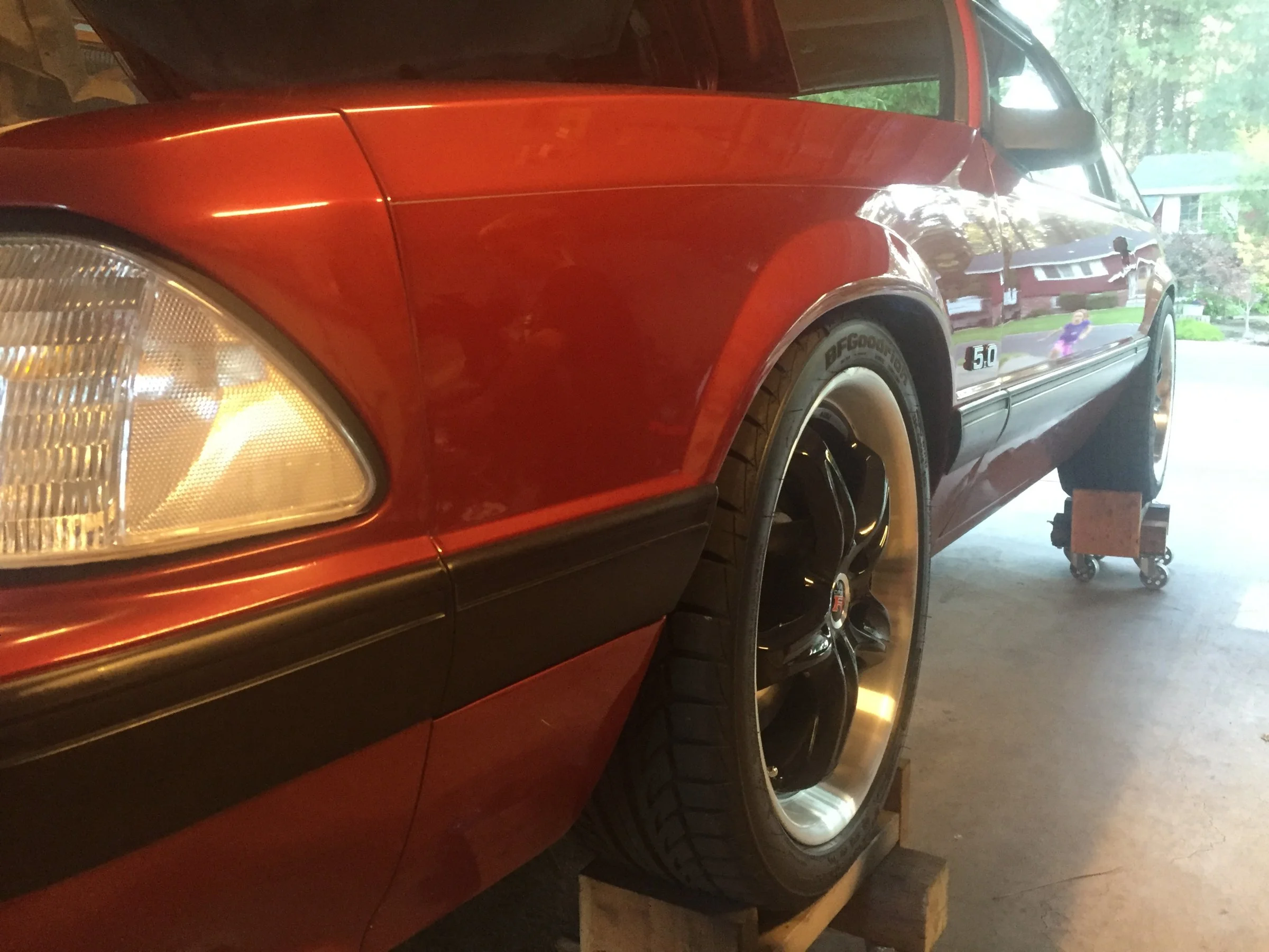

94-95 spindles DO push the front wheels out a tad. How much? Not sure, but in comparing pics of my car with Lincoln rotors, vs 94-95 spindles, it does appear the wheels are pushed out a tiny bit. Look at the relation of the side molding near the 5.0 to wheel "depth" Amd you can see it
Old photo from 15+ years ago running SVO rotors.
And recent pic with the 94-95 spindles
It's subtle, but the svo rotors did make the fronts a little more "sucked in" as it would considering sn95 wheels have more backspace than fox 4-lug wheels
Also, you can see the difference between 5lug drum, and sn95 offset disks in the pics as well running 17x8 sn95 wheels. Huge difference there!
Edit: and yes 15 years later I have the same tires on and cell phone cameras are much better than the Sony digital camera I had at the time
