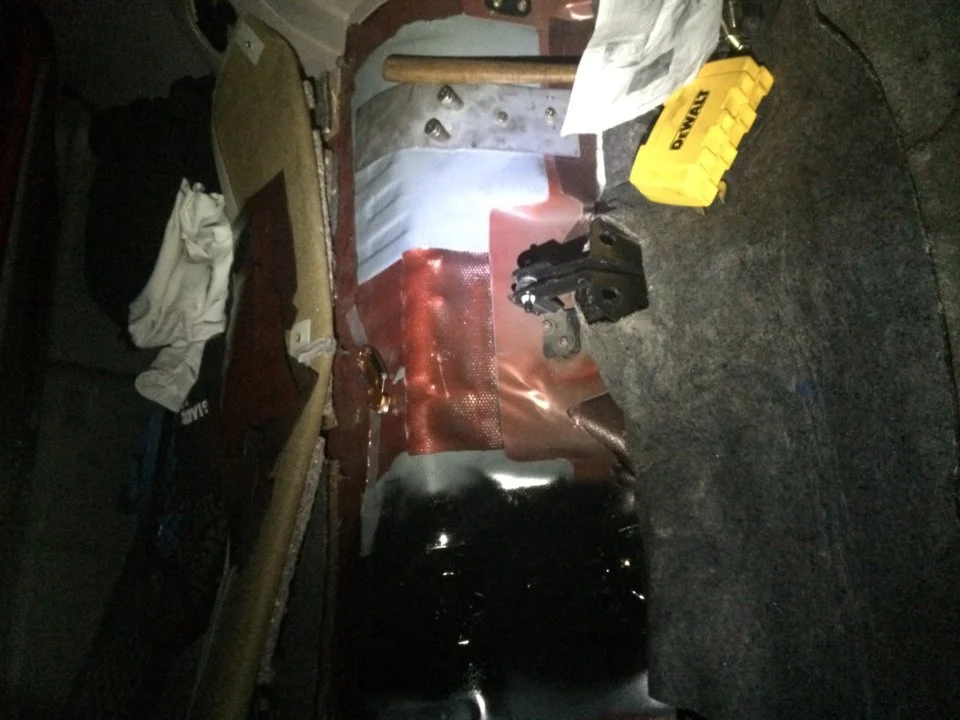

Hey all,
I recently installed my upper and lower torque box kit in my 91 lx. I followed directions to the T and when I went to reinstall my stock upper control arms, there was a clearance issue with the bolts coming thru the upper torque box. Is it possible I installed them wrong somehow and if so is this fixable? Because I ordered new upper control arms and don't want to do any cutting like I did with the stock ones to fit. Please help!!
I painted one side before I can get a pic of both

Had a similar issue with the end of the bolt hitting. Seems like i flipped the bolt around and put the head on the bottom to solve the problem.
