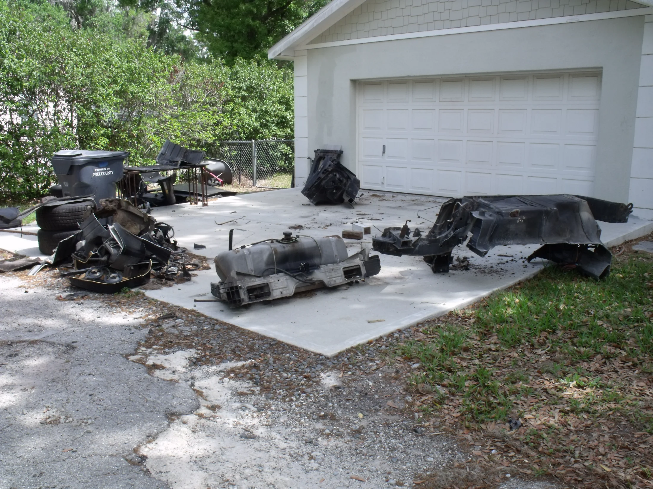

Need to clean up my parts car leftovers to make room to install it .. LOL.. Good think no HOA"s in the getto here....
