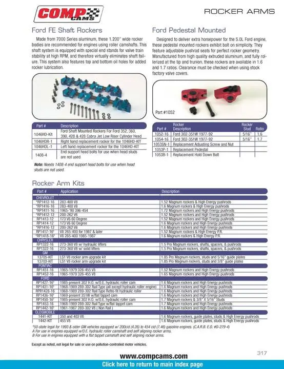

Here's something better from Comp Cams. I've held these in my hand I think and they were machined steel. Definitly NOT cheesy. $349.95 from Summit in 1.6: or 1.7:1 ratio.
