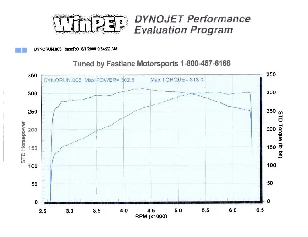

For those that may be interested...
I purchased my FRPP Hot Rod Cams from JPC Racing. He had them in stock when I bought them a couple of weeks ago. I had them installed by a local Ford Dealership (Cross Roads Ford, Cary NC.)
The cam price was close to $800 like everyone else is stating. The outcome and the installation cost is below. Note the prices below are for labor unless specified otherwise. The only other item that I had engine performance wise is a BBK CAI that is not listed below.
Torque was fairly flate starting at 280+ at 2800 rpm and peaked at 313.0 around 4200-4400 rpm range and did not taper too bad. Bottom torque fell to 250 at 6300 rpm.
HP was about 150 at around 2800 then peaked at 302.5 at about 5200 rpm. HP did not fall below 300 through 6300 rpm.

Dyno attached.
Hope this information is useful. I have posted this in the other forum that I belong to.

I had Doug's tune from Bama originally specifically purchased for my set up with these cams. I was out of town and at basically the mercy of what I was being told by the dealer. They said I needed a dyno tune and that Doug's tunes were off. I don't know but wanted the car ready when I got back so went with it. They later told me the AFR was way off and the final numbers that I received this morning after just speaking with them was an AFR of 13.3 @ 29 degrees timing.
The shop told me that was the best they could get without detonation. This makes me wonder if I could have gotten a little more had the car had 93 octane when they did the dyno. I am sure the car had mid grade when it was taken in for the cam install.
So if you are thinking overall cost then consider $800 for cams, $340 install, also note that I had $125 in a sensor that I suspect was replaced just as matter of practice since the car only has a total of 2000 miles on it... plus add the cost of a tuner ($380) plus the dyno ($250). So my cost was more like $1700 - $1800 range. Your cost may be a little less without the tuner and sensor.
MikeysOTP, so what are your final numbers? Do you have a before and after graph? I'll bet your car has a lot more torque at 6200 than before the cams, I'd be interested in seeing that.
MylocalDJ, you should have your car checked on another Dyno, your numbers look low for your mods. Your car should be closer to 350 than 300.
