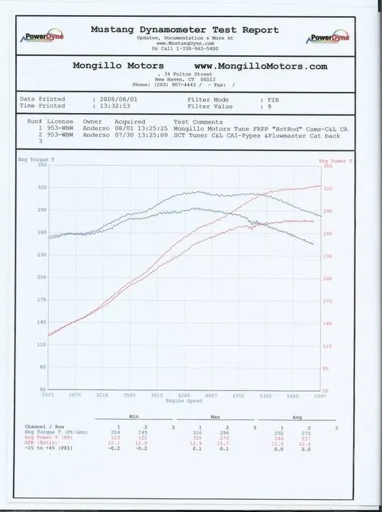

I am a computer idiot, let's see how this works.
Wow, that's a nice gain all the way through the power band. :nice:
I believe Doug from bamachips has said that he has gotten a gain across the boards as well.
Look at the difference in torque after it peaks. Peak numbers don't tell the whole story.
Thanks for the graph, I've been waiting to see a before and after with these cams.
The second pull is actually to 6200, it just so happens that this is the part of the graph he printed, I guess you can't view the whole thing at once? As to why he didn't pull it any farther, I have no idea. Could have something to do with hm telling me that the rods in these motors don't like high RPM's.
