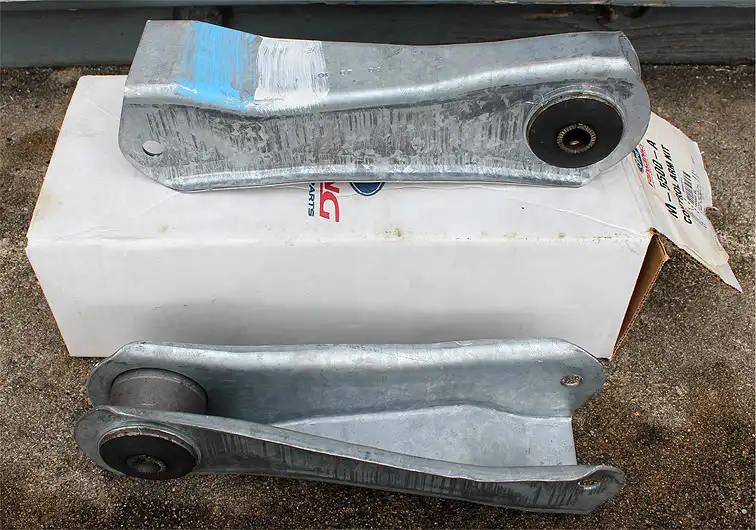

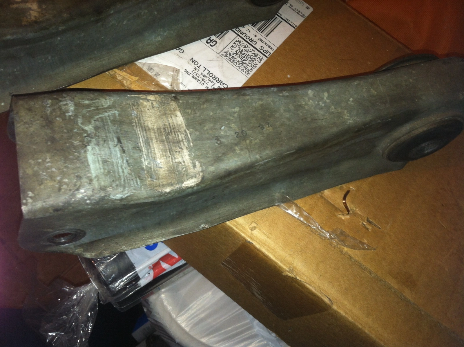

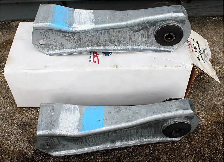

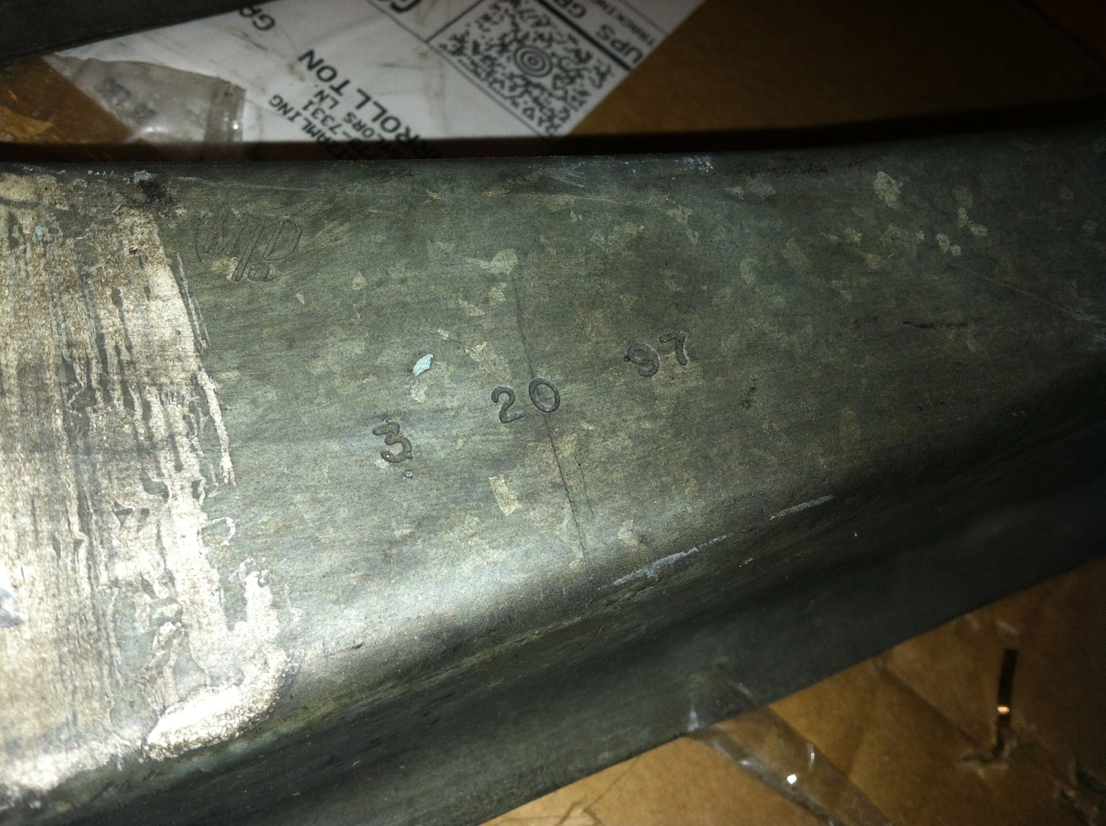

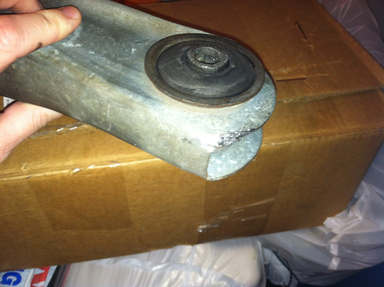

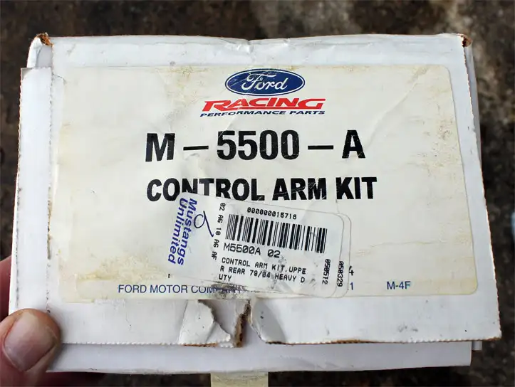

Alright Mike, here are three pics. They look like they have a date stamped on them. If that is in fact a date, then they were made in 1997. They are pretty dirty when comparing them to a shiny new set. Not sure if it what you are looking for, but have a look. I took a picture of the end of one of them. That part rubbed against a bolt in my torque box reinforcement kit. It scuffed up the end. If they are not what you are looking for, or not in the shape you are looking for, no biggie. I thought I would offer them up, they are doing me no good. The bushings are in good shape BTW.
Joe
Hey thanks Joe. No problem if they are dirty, that can clean up. Bigger concern is if they are 16 years old, the rubber bushings being cracked/dried/distorted though they look decent in the one pic. Are they the 5500-A arms? Shoot me a PM with what you want for them and I'll let you know.
