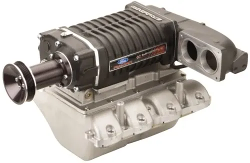

is this esentially a Whipple made for Ford to put their stamping on? anybody running one of these on their car? i am not looking to get one right now today, but in the near future would like to surprise my wife with one on her car. yes i know, a woman don't need a supercharger, but she can actually drive so it don't bother me to give her more power...

Due to the lack of delivery and sever back order level, Whipple Superchargers began development of their own line of superchargers. With their extensive knowledge and years of experience, Whipple developed an entirely new supercharger lineup that featured all of the latest technology in rotor profile, housing, rotor coating and bearing design. The results were astounding, not only did production begin in the USA, Whipple also increased compressor efficiency, lowered overall noise level, increased reliability, engineered the ability to update and repair (some are non-repairable) and increased it’s durability for a wider variety of applications.

Whipple actually supplied KB for a while. Whipple was the sole US importer of twin screw compressors for the aftermarket and eaton was for the OEM's. The overseas production backlogged badly. KB and whipple have since parted ways. Whipple rebounded from the production delays by engineering and producing their own in the US while making significant advancements along the way in terms of performance, durability, and servicability.

Ford's involvement is critical. Ford supplied numerous parts to the kit that are OEM such as the GT500 fuel pumps, 03-04 Cobra reservoir, spark plugs, and injectors.
The biggest Ford contribution was Ed Badillo. He is the OEM calibration consultant that tuned the Aston Martin Vanquish and numerous othe Ford performance derivatives. You may familiar with his association with Prodrive/Badillo. Prodrive is an OEM racing development consultant and motorsport powerhouse in europe. They are one of 4 companies that are certified by SEMA and Ford to be competent enough to modify the Ford calibrations for performance parts. The other three are Roush, Saleen, and one other that escapes me. The tuning is the most COMPLETE program done. The software and hardware of other aftermarket solutions DO NOT have access to all maps and strategies. There are numerous strategies employed that monitors the vehicles performance and adjusts power output accordingly if it goes out of spec to reduce engine damage and premature failure of catalytic converters and other expensive parts.
These calibrations were developed on Ford's Arizona Proving Grounds using test mules driven there and also thousands of miles across the country through various elevations and both hot and cold environment testing. They are conservative in the sense that they retain and CREATED OEM factory durability monitoring strategies. But there is not a lot left in a custom tune to warrant it.
It is true that some of the development of these calibrations led to creation of safety strategies being implemented in future vehicles.
And it is 50 state legal. These are important clarifications. Many guys are throwing down some great power numbers at the rear wheels with the Ford calibrations. Whipple supplies the supercharger assembly. Ford supplies there expertise and the result is a very good OEM quality kit that performs properly on stock drivetrains even. It is about as "bolt-on" as any power adder can be for these cars.

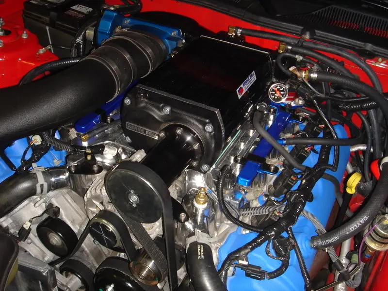

Bevga explained it pretty well. The Whipple kit is the most complete supercharger kit available for many reasons, but mainly the fuel system is superior to all other kits. As far as the other twin screw blower kits go, the Whipple has the largest intercooler and heat exchanger (Fluidyne aluminum) teflon coated rotors inside the compressor, site glass for oil level inspection, FRPP zero heat range plugs. I have one on my car which I installed myself. I'm very impressed with the quality, fit and finish, etc. It's not the same basic thing you buy from Kenny Bell. Kenny Bell's blowers are well built systems, only not as complete as the FRPP/Whipple kit.

Here is SOCAL Muscle Motors is a FRP dealer and installs all FR parts. I had them dyno tune my old S197 with it's Vortech and they did an amazing job. Brought the car to life all while keeping is smooth as silk as a daily driver.
They install the Ford Racing SCs and offer very good service and install warranty.
